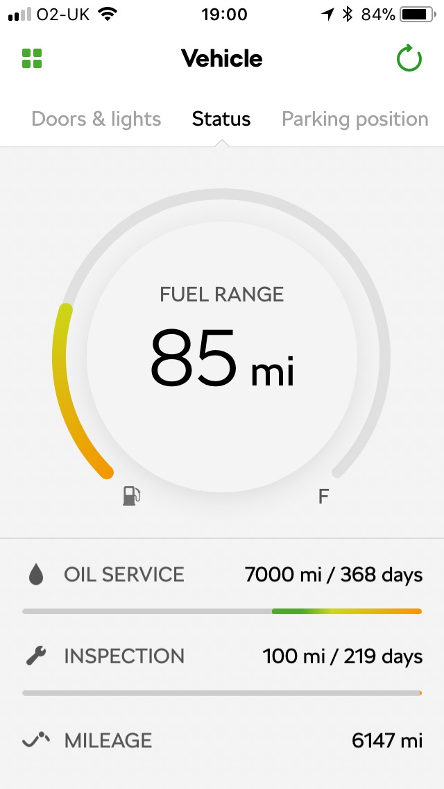

Screenshot of Skoda Connect App:
(yes, need to fill up soon;)
Does the infotainment screen say the same thing? (car menu, settings, scroll down to service).  Just wondering if its a bug with the Skoda Connect app (which I don't have). The Inspection service on my 2016 280 is due after 3 years/30,000 miles. 6000 miles is ridiculous and clearly wrong. The oil service is still on variable as you will have done about 13,000 miles before it is due, mine was much the same despite them saying it would go for nearly 20k (but I was happy to have the 1st oil change done early anyway). As far as I know the Inspection service cannot be "flexible", it is always fixed. Only the oil change service can be flexible or fixed according to how its set up.

Hmm, yeah it is weird. Yes, the infotainment screen, menu, settings, service say exactly the same thing.
I remember the guy on the phone today saying something about it might have been 'European setting' or something. Probably just another excuse or made up cover story because he simply didn't know, or may have been trying to back pedal somewhat...
Whatever it is I'm not overly bothered. More pleased that I don't have an expense that I was kind of expecting.

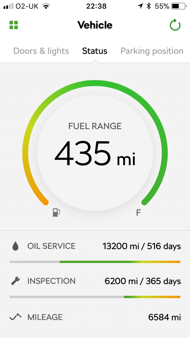

Had the inspection light reset today along with a free health check. All is fine and dandy.
I asked them to check the dipped headlight height as it’s a tad low for my liking but apparently it’s ‘spot on the legal height’ whatever that is. Shame I can’t trim it to my preference in the car but these fancy Smart Lights are supposed to sort themselves out...
Fella said they’d reset the inspection to the next fixed interval and then once that’s done they’ll reset it to the “long term variable” since I do about 15,000 miles a year and that that would actually be cheaper than going on a service plan. Ok.
I’m assuming the oil service will need to be done sooner than what the status now says?
Bearing in mind the state of tune of the car, it’s sophistication and cost, I’d have the oil changed around 10,000 miles. Then go onto the variable if you like. But no later than ~13,000 miles.
