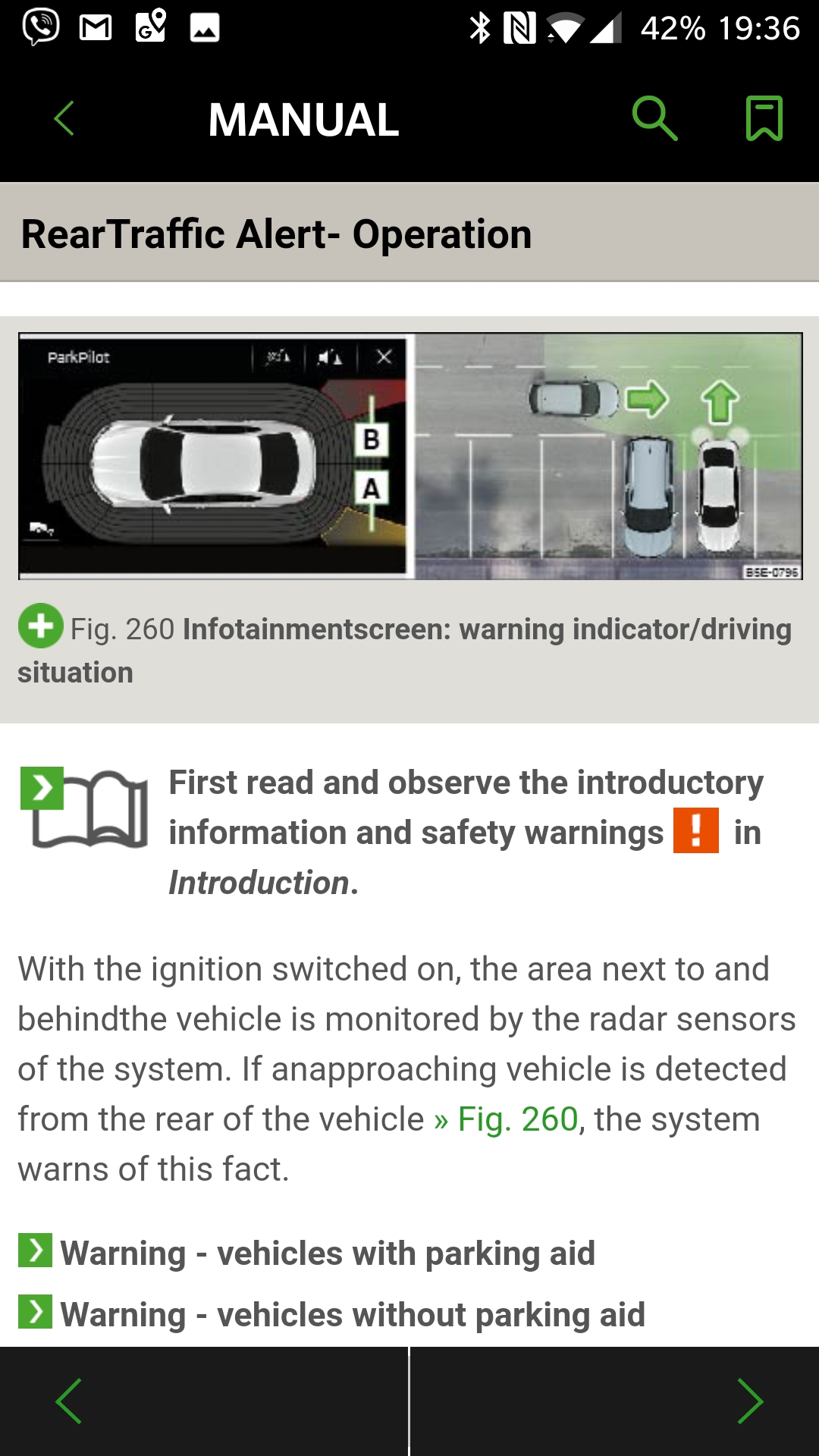

It may be rear traffic alert, not sure if it should only work for moving vehicles though.
Thanks for that. Didn't even know my car had it!
Does your car have blind spot monitoring? I didn't realise until I'd read the first page that this feature uses the radar sensors inside the bumper rather than the parking sensors. The sensors inside the bumper come with blind spot monitoring.

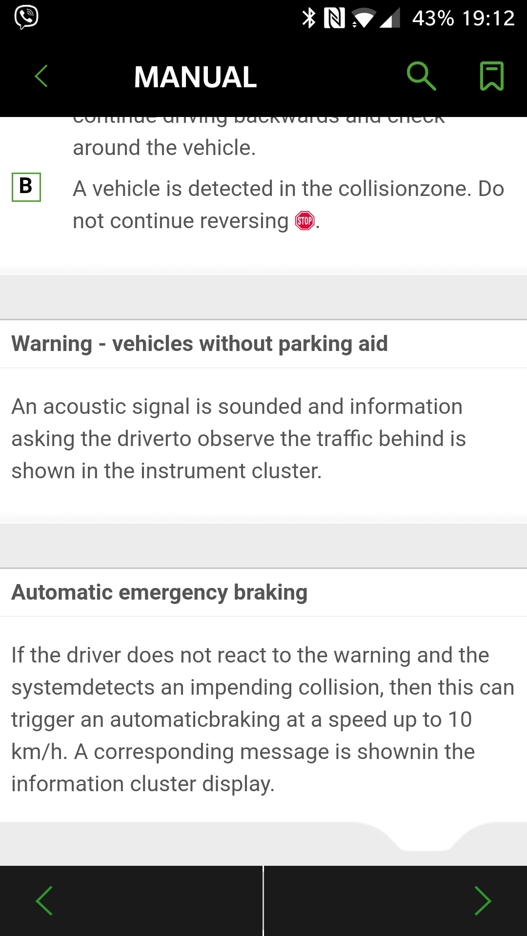

It's a standard feature with the parking sensors. Maneuver braking. I've had it a few times braving towards a hedge. Loads of room but an errant twig caused the brakes to slam on. Scared the c**p out of me! Pretty sure you can switch it off in the car settings. I'd rather have the brakes slam on at low speed whilst reversing than bump in to something TBH.
Exactly the same happened to me, but my other half was driving. You can imagine!?
Yes you can disable it in the settings in the parking manoeuvring menu.
