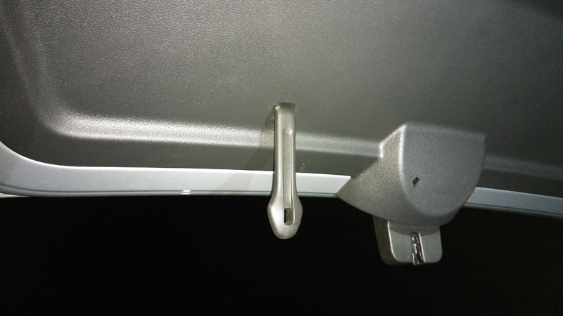

It screws in to a purpose built hole with a metal threaded hole to screw in to.
The picture is with the hatchback lid open looking up from the flat parcel shelf.
So if you are at the back of the car you would find the handle above your right hand.

Thanks to both of you for that, I have already looked up the parts numbers for the strap, mounting screw and riveted cap nut.
Once I get these parts ordered up and have them in my hand I might be able to work out if the captive nut just gets retained into the hatch trim, or retained into the metalwork of the hatch behind the trim.
That picture makes it perfectly clear where the strap gets mounted!
In to the metal work behind the hatch trim as the trim would be too weak.
There is an indent in the trim for the handle to fit in to.
Thanks AG Falco
Yes, I was guessing that would be the case, but hoped I was wrong!  I'll need to check out if this strap does provide the answer, I have just printed off that picture and it did not seem to get a very good response!!  I have checked and it seems that all the Skodas that have a pull down strap use the same one, so only one length available, so if that is not long enough I'll have to get a bit more creative, the problem with a longer strap would be that it might get caught in the hatch closure unless it was made out of "stiffish" preformed "rubber" - like this one is.

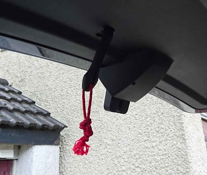

Had to add a bit of chord to mine ....
Is that because you are from Surrey and not The Netherlands. :)
Well I collected the parts today, I just ordered up the handle, securing M5 screw and the clinch nut, £2.99 for the lot - which was good.  I've been given a demonstration of how much of a problem closing the hatch is, and it seems "on a good day" wifie can reach the recess on the hatch and pull it down!!  Well every time I've spotted her closing it she needs to get round the side of the car and grab/push the body work of the hatch to close it, though I suppose most people close their car hatches or boot lids by grabbing the dirty outside and slamming it down?  Anyway it does look doable, I've just got to wait for warmer weather so that I stand a good chance of getting the trim off without breaking anything including my skin or nails, find a suitable spot to either locate the clinch nut (and probably find a high strength bolt to "set" the clinch nut into place) and then work out if its best to cut a slot in the hatch to slide the end of the strap in through, I'd think that I'd need a longer securing screw and glue a spacer behind the trim so that the strap can get fixed securely while not causing the trim to need to flex inwards at all - probably bin the clinch nut and find a suitable cage/clip nut depending on what I find behind the trim.
I'd be worried that that cord did not get caught in the weather seal - no?
