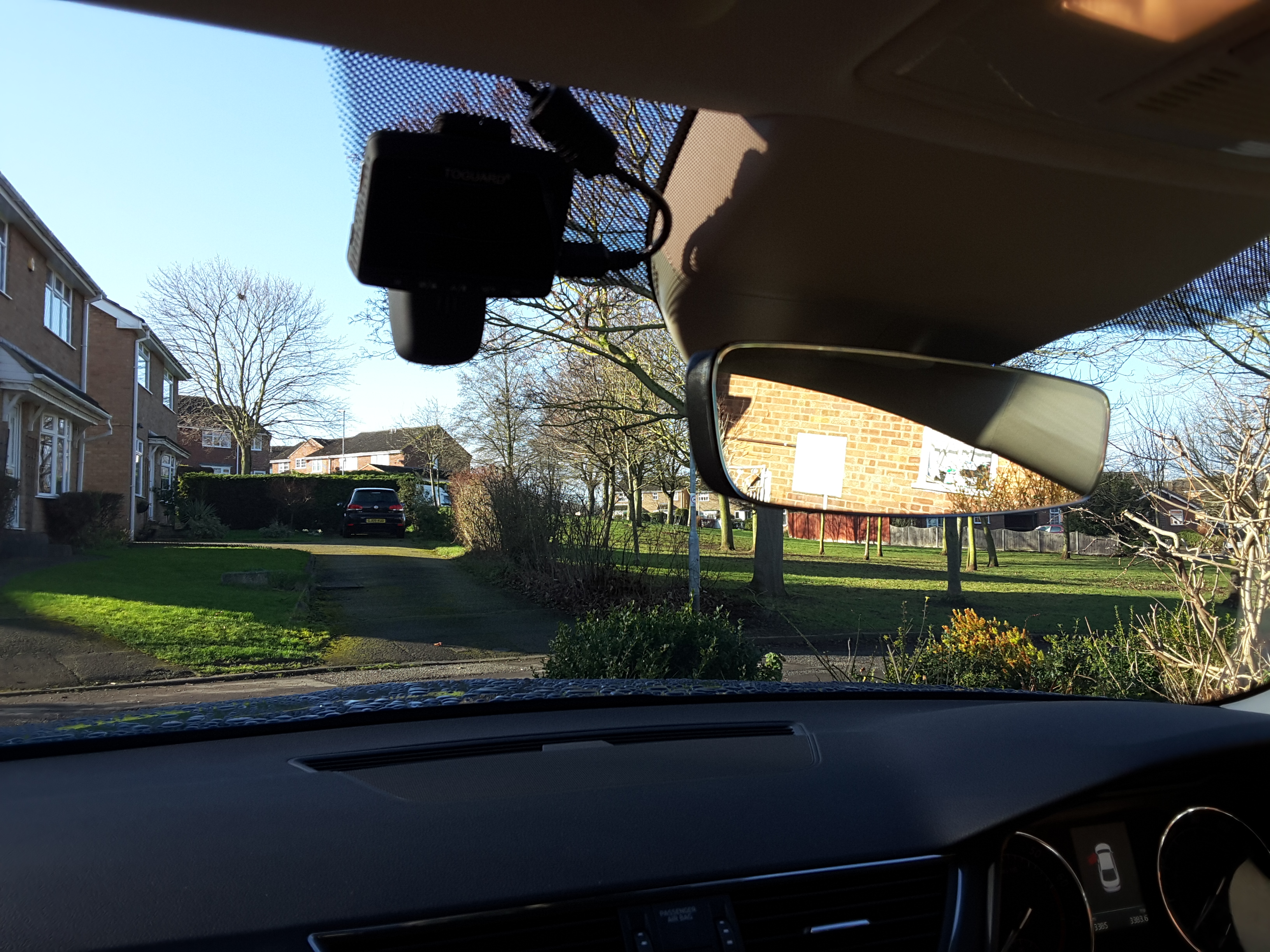

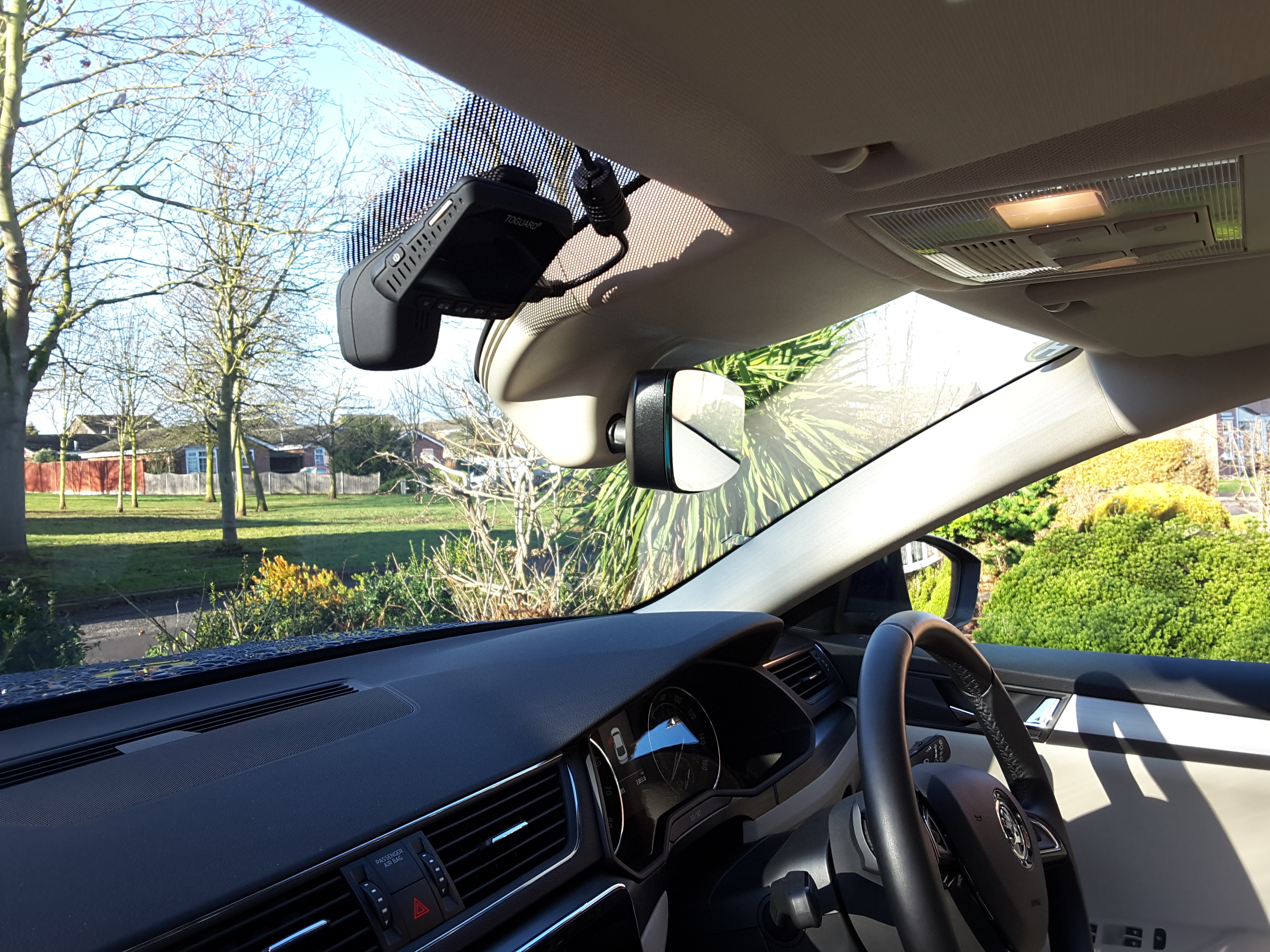

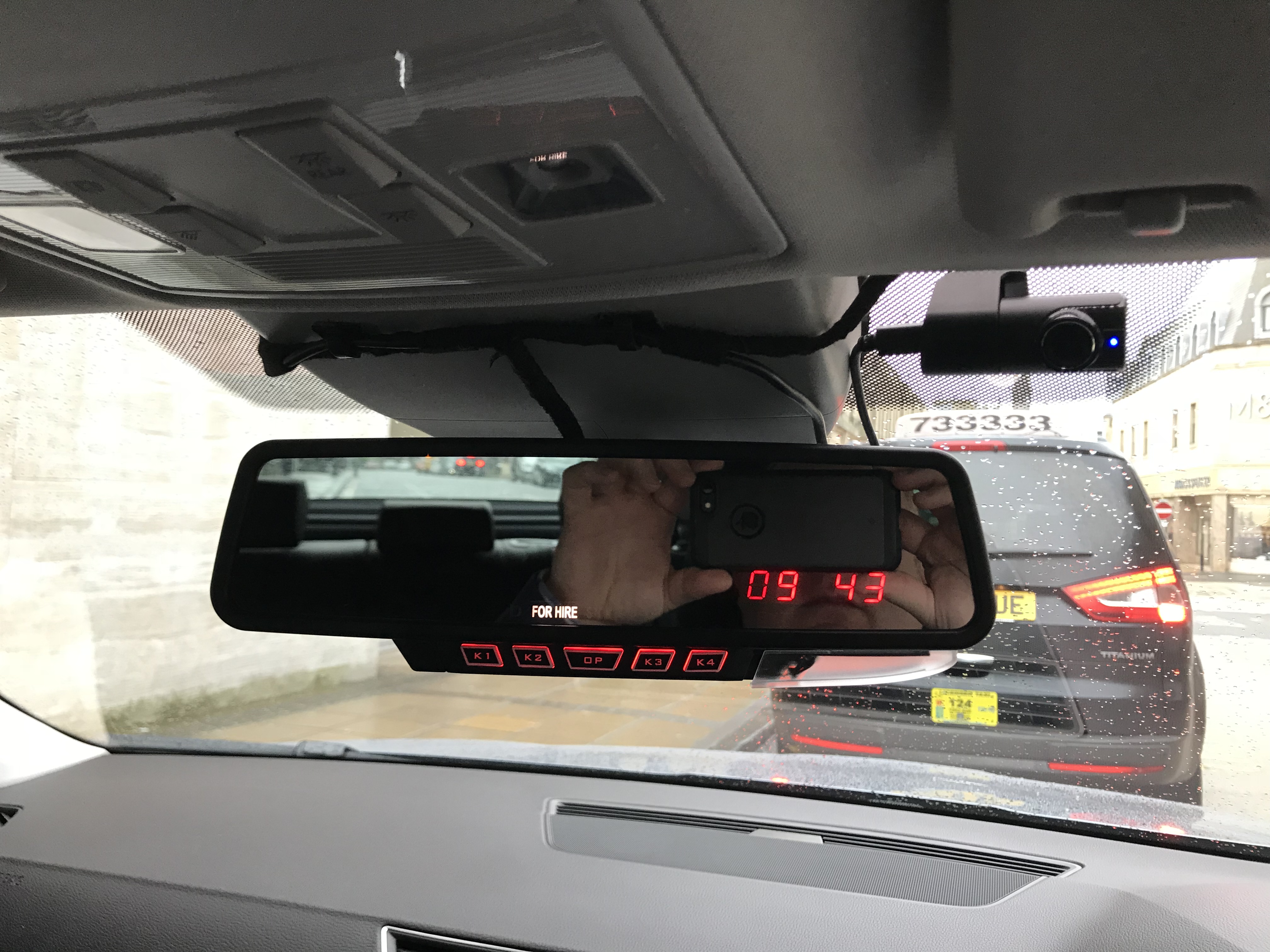

Mine is a Toguard (without wifi) that sticks onto the screen, very neat and can hardly be seen from outside as it is stuck the black shade on the windscreen.
The wire is then routed into the roof lining and down th pillar to the fuse box.
30-45 minutes should be all it takes.

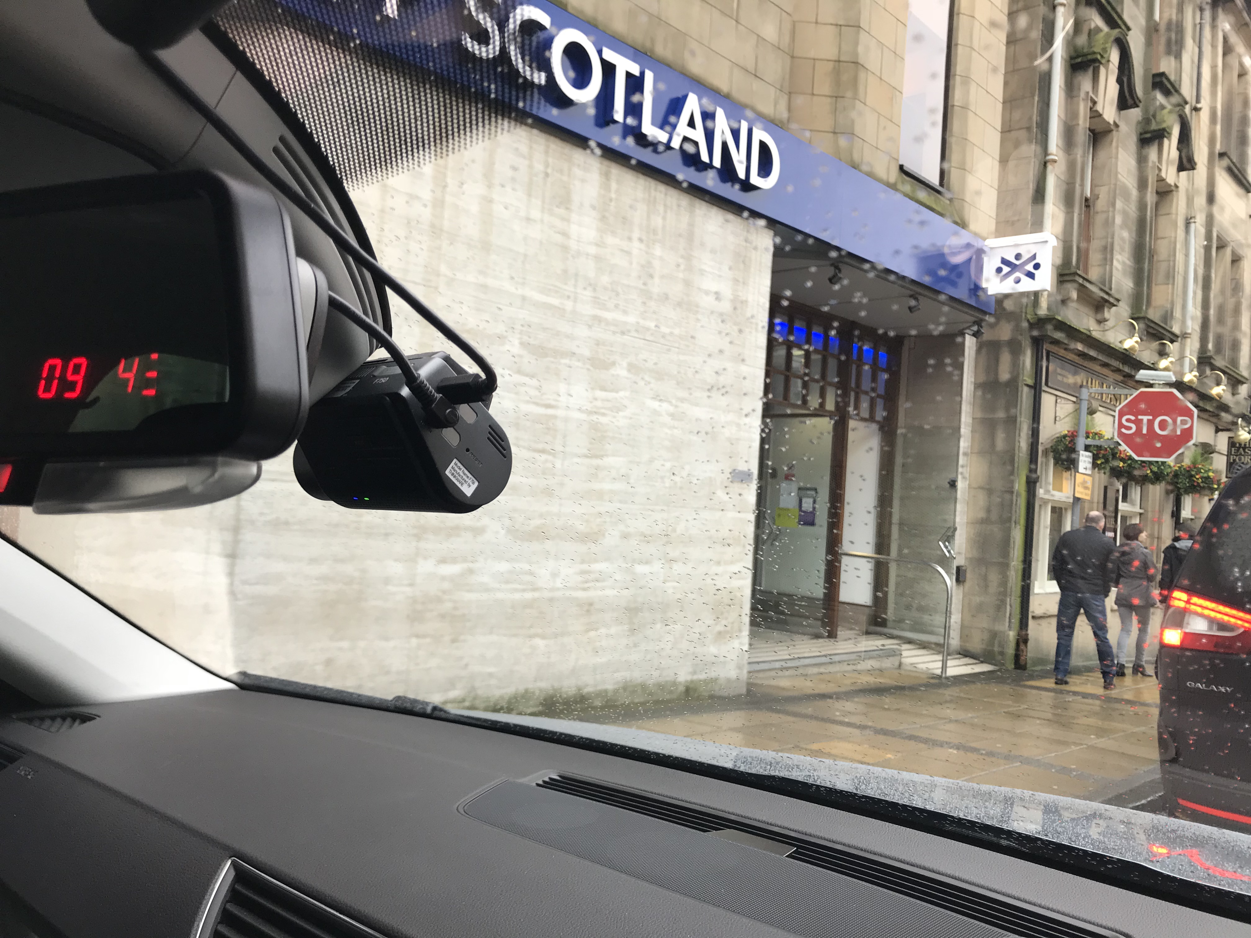

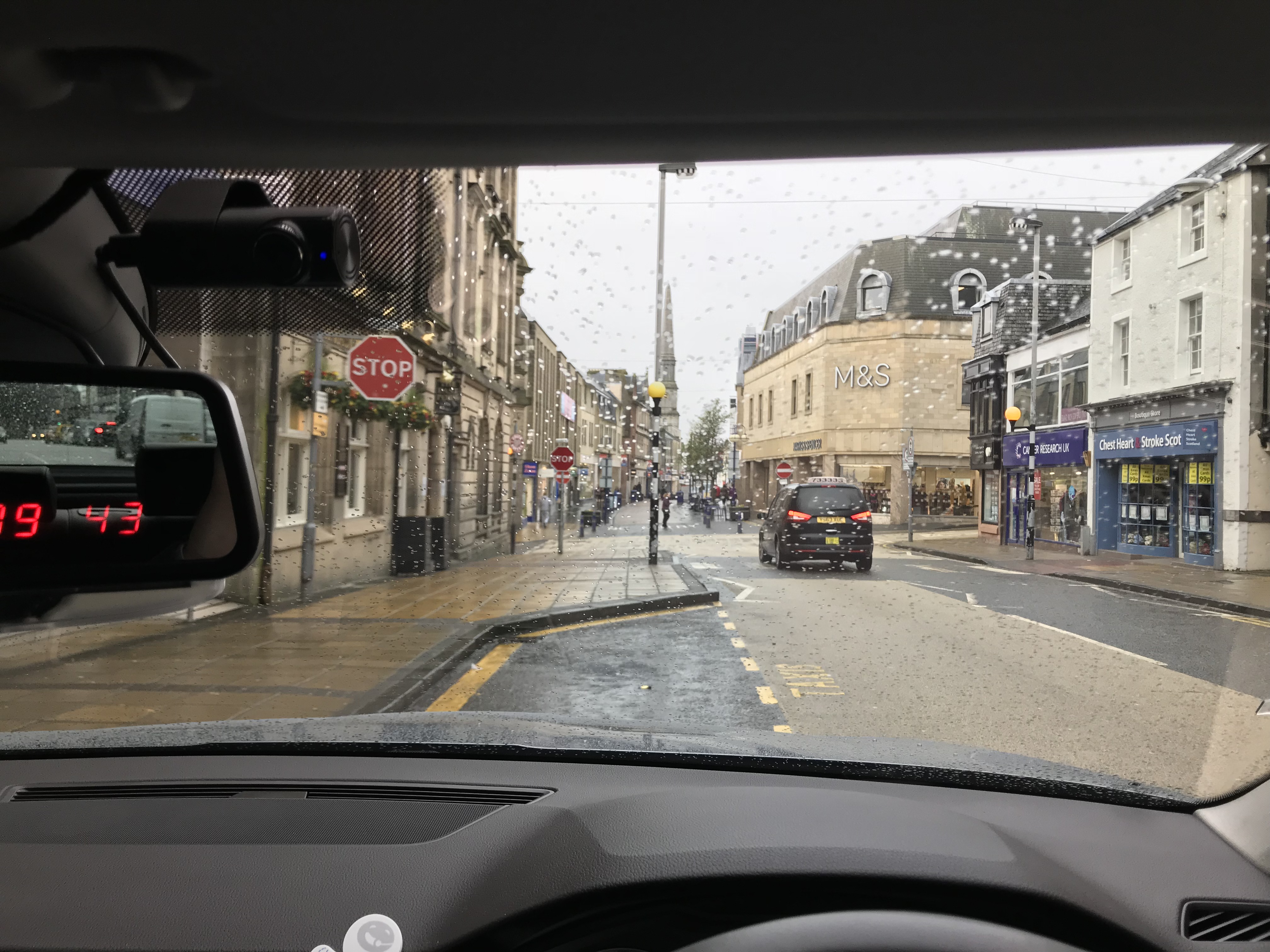

I fitted mine out of line of sight. I also have the rear one facing in in case I get a runner or worse.

I will try to get a couple of photos of the installation.
Here you go, the suppression thing is a bit too big to hide behind the roof lining.

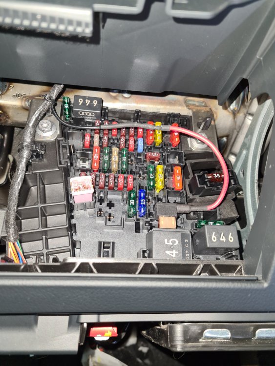

Revisiting this topic as currently trying to piggyback onto the fuse box for my dash cam...
1)  I've checked many fuses (all the ones I'm brave enough to pull out to put multimeter in) and so far the only fuse I can find that is switched with ignition is rear wiper.  Others that I expected to see switched included rear camera, heated seats , phonebox and trailer hitch but all seem to be live with ignition off.....
2) The piggyback fuse adaptor that I have (which appears to be a standard size) doesn't fit flush into the rear wiper fuse because the electric seat fuse sits higher than a "standard" fuse and so I can get the piggyback adaptor in, but not convinced it won't work it's way out over time with vibrations as it's not fully seated
3) Other fuses for options I don't have (and so empty) that may be swtiched don't appear to have both live and return connections inside the fuse box so no point trying to tap in there...
Any ideas / suggestions??

Tested again and they do appear to be live all the time...  Did some searching on this forum (should have tried harder first time at searching!)  and found someone else who used fuse 35 (diagnostic connector, camera, radar sensor, voltage stabiliser for taxi vehicles) is also switched and no interference with adapter so have used that and camera now working perfectly :)
