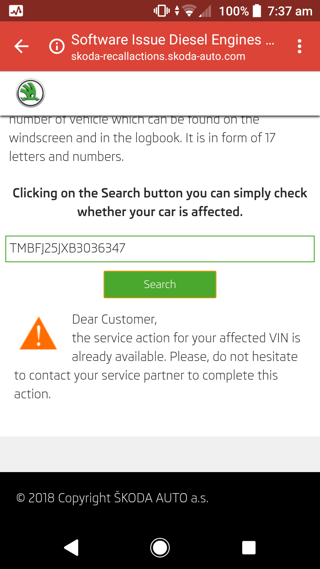

Use the VIN checker then.  There is a high chance it has, hence someone gets rid of it.

What's a vin checker
http://skoda.co.uk/dieselinfo
Put the VIN number in here, it will show if the car is one to have The Fix,
which if you read up on it you might find is not a good idea to have done.  It is not compulsory.     Your new car might have been done.
Edited by AwaoffSki
I've just checked and if I'm reading that correctly it's not had it done
