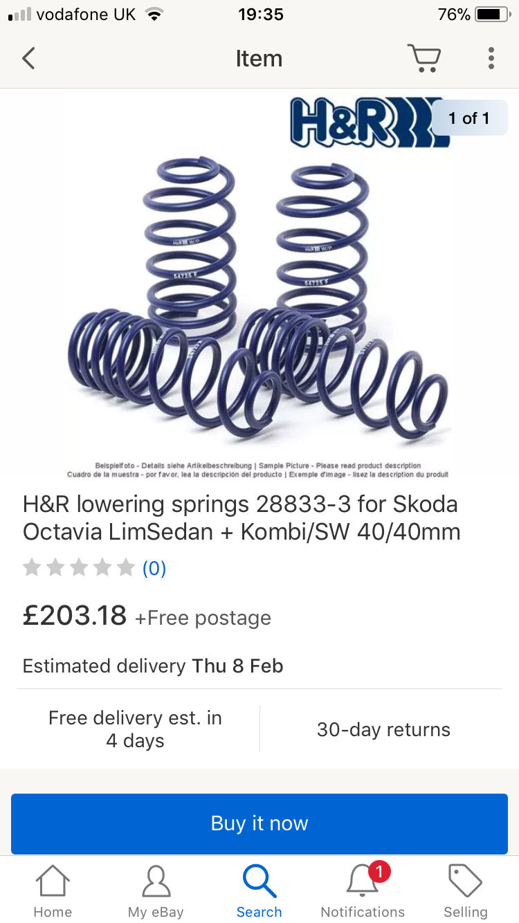

Before I order can someone give me the thumbs up to say these are the right ones.
For octavia Vrs estate 2wd 2014 model
MINE ON THE SAME YEAR AND MODEL.
£203 is expensive. I got mine on ebay.de for £50 less posted. mine are 28833-2
please check but 28833-3 are 4WD AFAIK

THe 3 says For 4x4 not sure about the 1 and 2 part, I was going for the 2?

im assuming -1 is the sedan so the spring weights are different?

Ahhh shoite sorry yes mine are 28833-2.
-3 is 4x4 but not rs and I think there is a -4 now which is 4x4 rs and the -1 is for a lighter front axle weight.

Yeh I’m guessing I need the -2 :-) least we got that sorted
