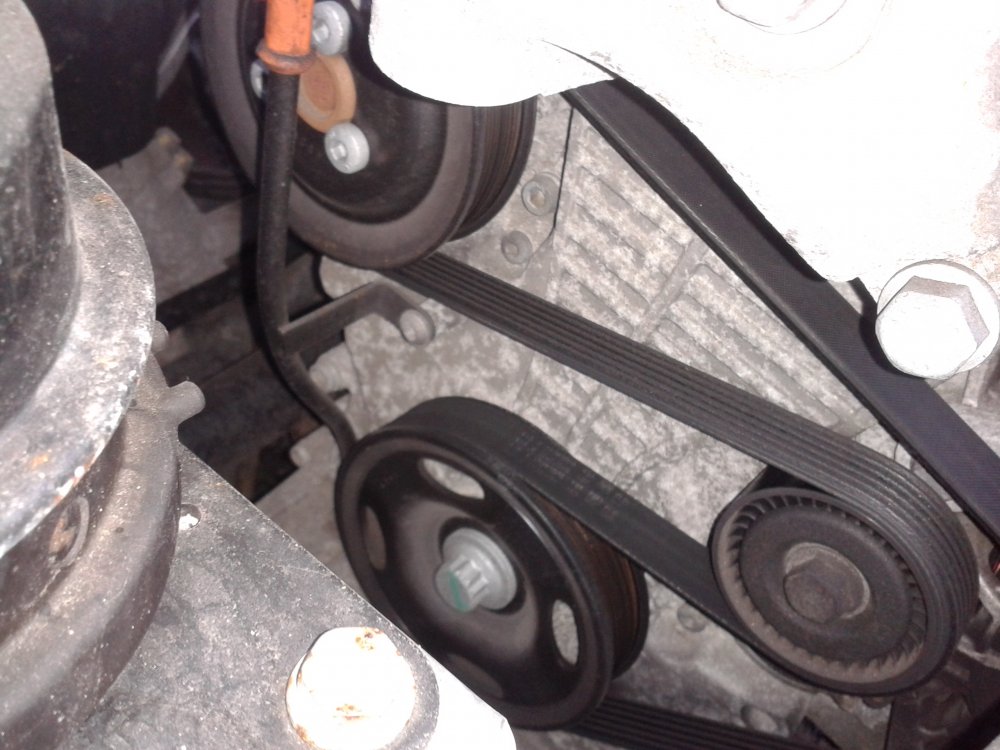

Does the FABIA 1 HTP 60 CHF engine have a timing belt or a chain?
I've attached a photo of the left side of the engine.  If I hadn't read on here that the HTP engines (around 2010 age) have a chain I would've thought that the photo shows the timing belt.

That's the auxillary belt. Chain is under the alloy cover behind there.
