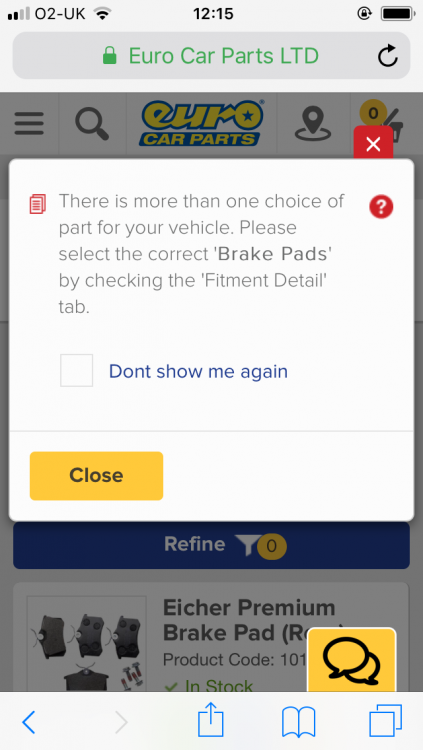

Hi guys, haven’t posted in a while, but I’m due new pads on the front brakes so gonna change discs aswell whilst I’m there. Just a question about which? And the fitment?
I’ve been on euro car parts and found some pads and discs both brembo but it says I need to make sure I have the right fitment as there is two types?
Any idea which fitment is for mine? Thanks
2013 skoda fabia Monte Carlo 1.2tsi - hatchback
reg - GV13 SUH
This is what I mean

Just phones TPS in Crawley and he wasn’t really sure what I was on about but he did give me the official part number of the pads and discs that are fitted to my car already they are as follows:-
5k0698151 - pads
6r0615301d - discs
does this help? Thanks

So judging by the oem
parts I’m looking at these discs:-
https://www.eurocarparts.com/ecp/c/Skoda_Fabia_1.2_2013/p/car-parts/regular-service/car-service-parts/brake-discs/?10444079A&1&6190048b1c75ce83104b4778fb7963e9d54f068f&000027
And for pads these :-
https://www.eurocarparts.com/ecp/c/Skoda_Fabia_1.2_2013/p/car-parts/regular-service/car-service-parts/brake-pads/?10144113A&1&05b1068abdd3cc8c933e09686927a4a4fa7ed5f2&000036
Can anyone confirm for me please, I’m a novice when it comes to parts, but the discs are 288x25 and the pads are same fitment detail as the oem and they fit discs with 288 width so should work but just need a double check
Go for it!
Take a wheel off and measure the disc to be sure.
