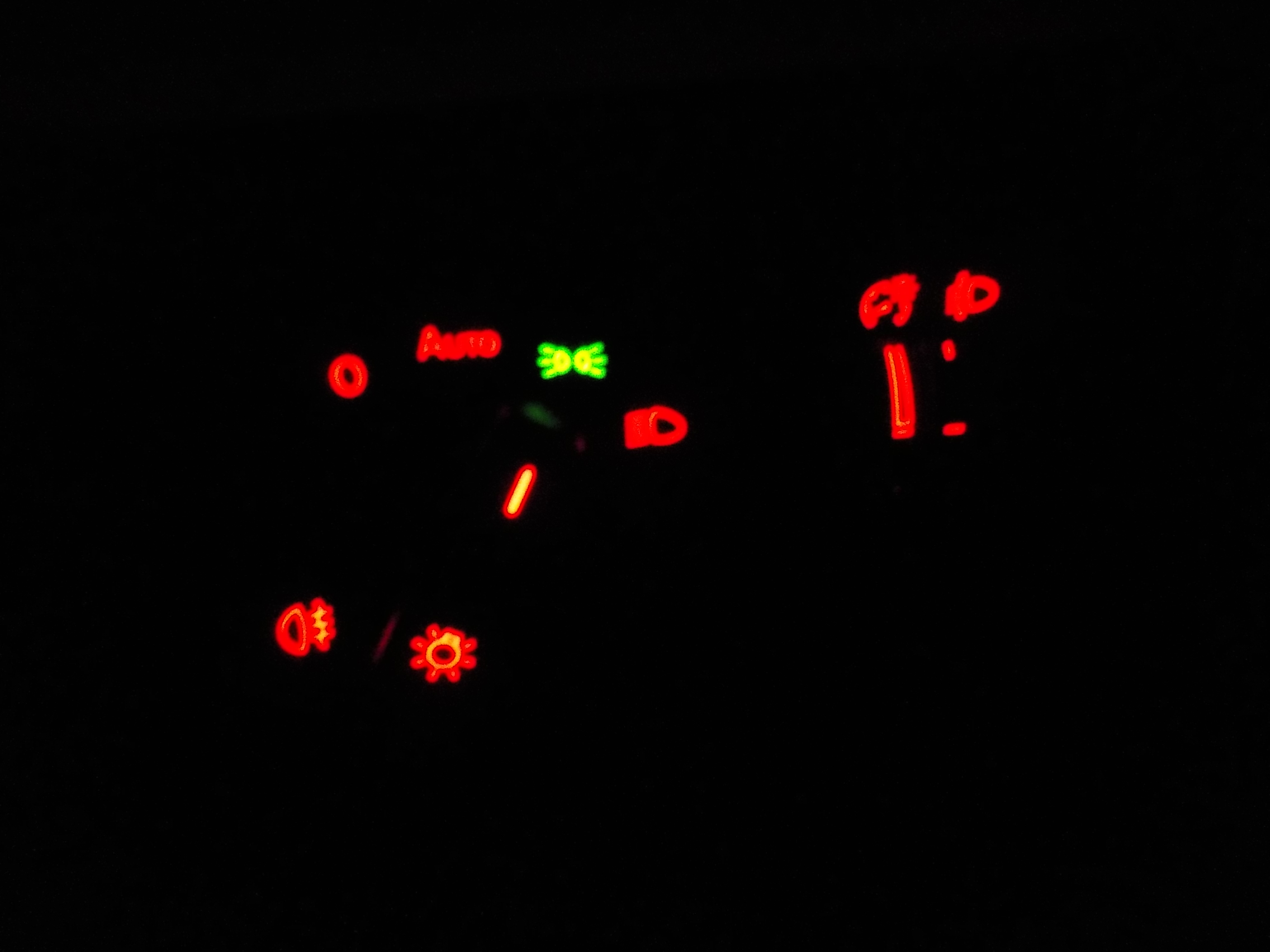

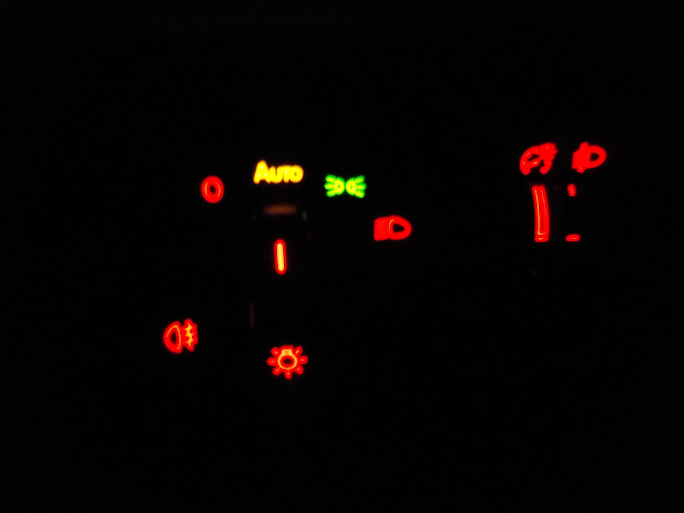

I referred to the colour on these switches as the illumination on many aftermarket switches is backlit with RED where Skoda switches are usually GREEN. Have a look at all your instrumentation at night and the switches for windows, lights etc are green. The switch you were looking at is backlit red. Hope that makes sense.

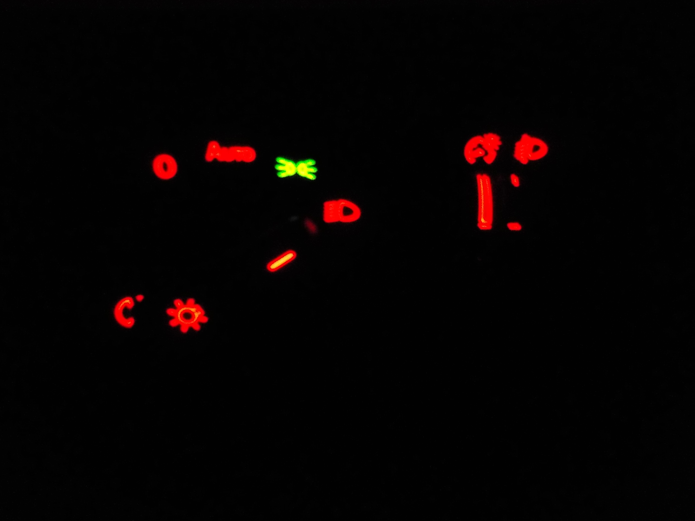

Heres a thought... You say you want constant lights on. How about biting the bullet, fitting an auto light switch which has the little sensor and leaving the sensor inside the dash/bulkhead or even, mounting it on the dash as per usual but just under the black surround of the windscreen? This will prevent light hitting the sensor, thus keeping lights on constantly! Will also serve to act as auto lights should you want to use them occasionally and also be a bonus when selling the car to the new prospective owner. Nothing then stops you turning off the auto lights or using the switch in the normal way whilst still leaving you with the constant function you so desire, without any real changes to the wiring. Auto lights are simple to fit AND remove. As long as you retain the old switch, you can revert to stock. With the sensor on the dash, you just move it a little, so light CAN hit it, if the desire takes you.
The only issue is, the switch you pictured had front and rear fogs, I think you said you only have rear so you might want a different switch unless you want to retro-fit front fogs too!
I was thinking of doing that, as for the fogs - well I dont actually have to fit them do I, just ignore the switch position.
