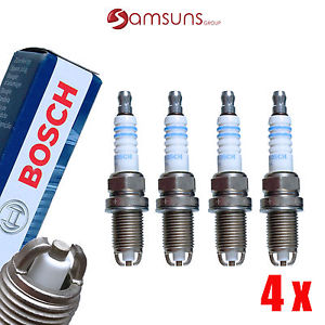

well those Ngk sparks already where in my engine and the engine was too shaky - engine wasnt working calm it had its own trembling... i was looking for beru sparks but i could find a dealer for those and i ended up using bosch +7 with 2 pins or whatever those are called and i have to say my engine is calm and less noisy has better power and runs smoother... if you want me to take a pic of the box i can do that so you guys can try and see if these work good for you too... whats your opinion on bosch sparks ? is 2 pins better than 3 that ngk is using ? any pros and cons ? if you know more than i do please write a comment and present your own expirience or knowledge :) i hope i made a good choice choosing those bosch sparks :S

added pic of the similar spark plugs
The outer pins are the earth electrodes. Any claimed advantage of multi-earth electrode plugs over single electrode ones is based on lower erosion rates meaning that the gap stays in spec for longer (based on an argument that the spark always takes the shortest path from the centre electrode to the earth(s)).
thats true, but more earth elecrodes means less space for combustion and angles from which fuel can "pickup" that ignition... thats why brisk manufactured spark without earth electrodes... and thats probably why ngk with 3 pins runs poorly compared to others i guess... even tho it should be opposite but... oh well.. its just the way it is
@djape92 - Well, we're in agreement about multi-electrode plugs then. I've never liked them (but don't agree that OEM choice is always best. On the PSA TU family you get better running with NGKs than the OEM Champions).
