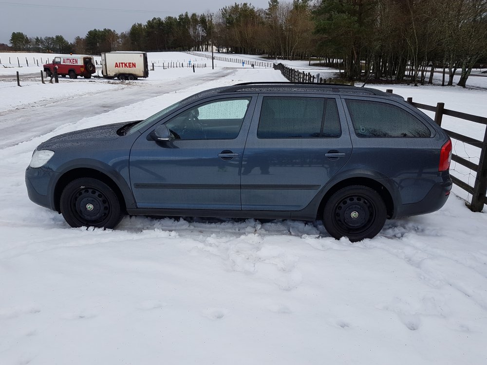

Not a Kodiaq owner, but steelies  all the way for me in my Octy Scout.
One main advantage is if they get dinged or scratched I could probably repair them myself. If your Second Alloys get damaged they will look tatty (and will probably get worse if left) and you would probably have to get them repaired professionally. Unless, of course, you don't care about the aesthetics, in which case get the steelies!

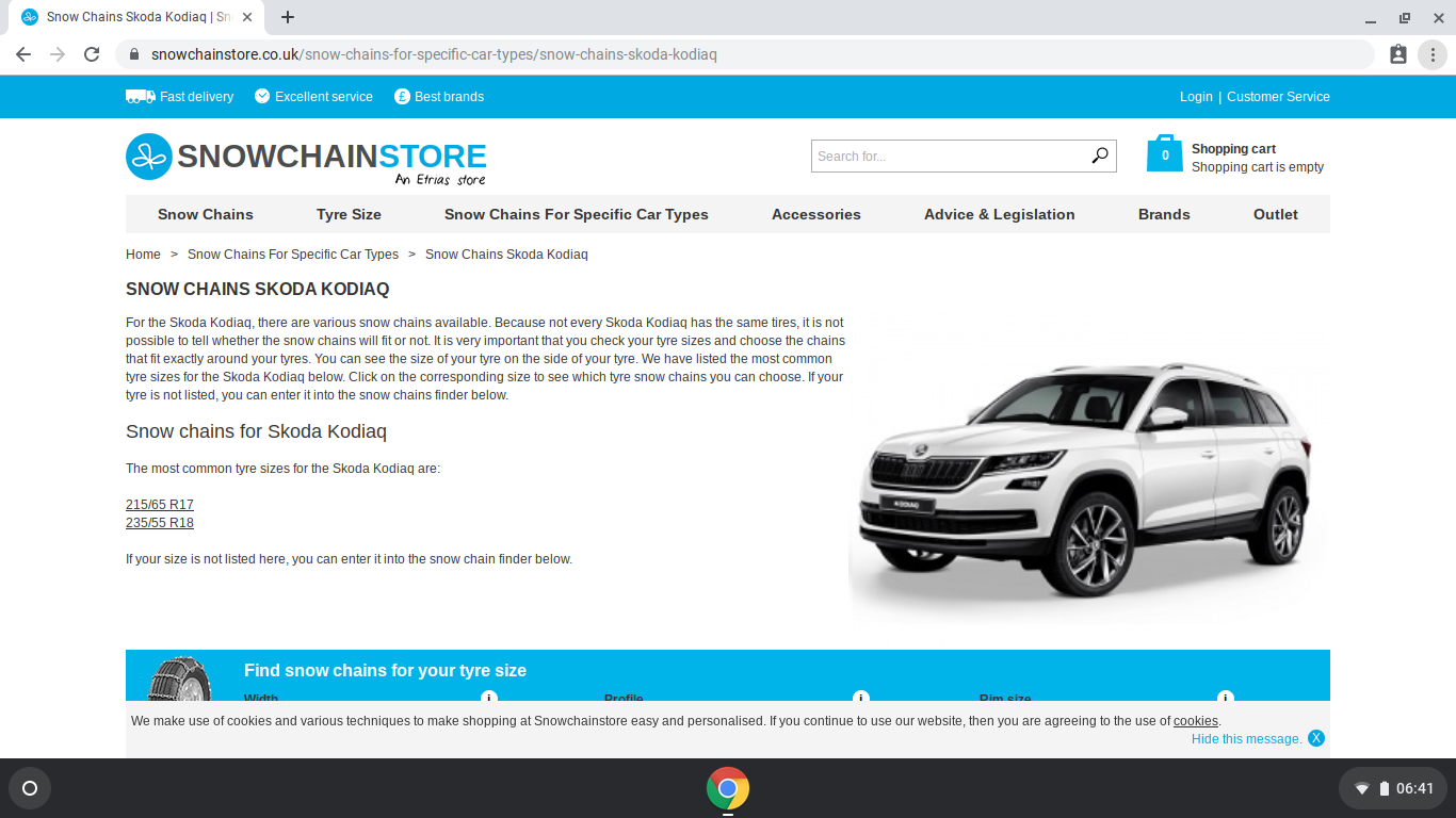

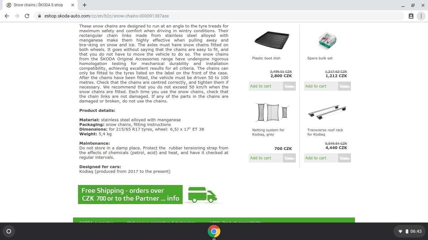

Where did you get this info?  Skoda seems to sell chains for the Kodiaq.
 Cheers
@LooseHeadPop
Welcome to the forum.
That is fine if Skoda sell chains to fit bigger sized tyres.

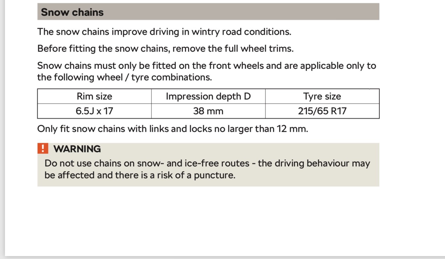

The Owners Manual is the place to check what Skoda have printed on the recommended sizes of tyres / wheels to use with Snow chains.
From the owners manual...
Thanks for this info. RTFM, you might say. Impressive resource, this forum.
The issue presumably is one of tyre width rather than radius. The specified tyre has a nominal radius only 3mm less than that of my 235 50 19 tyres, but is of course (roughly) 20mm narrower, thus allowing for the addition of 10mm chains without risking contact with the suspension/steering gear.
