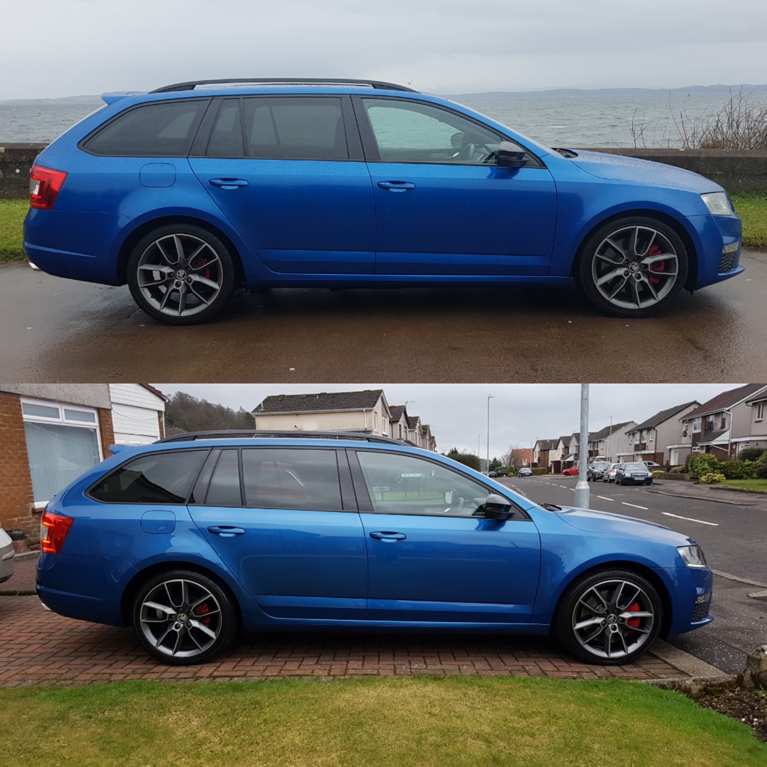

Unrelated but could you post some pics of it now it's lowered as I have a set of the same springs waiting to go on and can't make my mind up whether it will be low enough.
I'll try get a pic tomorrow and post it on here. The front wheels definitely sit neater beneath the arch. There's not too much if a difference at the rear. Subtlety was what I was hoping for.

20 hours ago, Kahunajb said:
Seems odd that it coincides with the wheel rotation, could be caliper related but wouldn't of touched them when fitting the springs.
Top pic is lowered. Makes just enough difference for me.

Thanks for the photo comparison. Can definitely tell especially the front but is subtle as you say. The standard vrs ride height does look ridiculous as well as how far in the arches the wheels sit. I'm  going with 15mm rear 12mm front spacers too.
