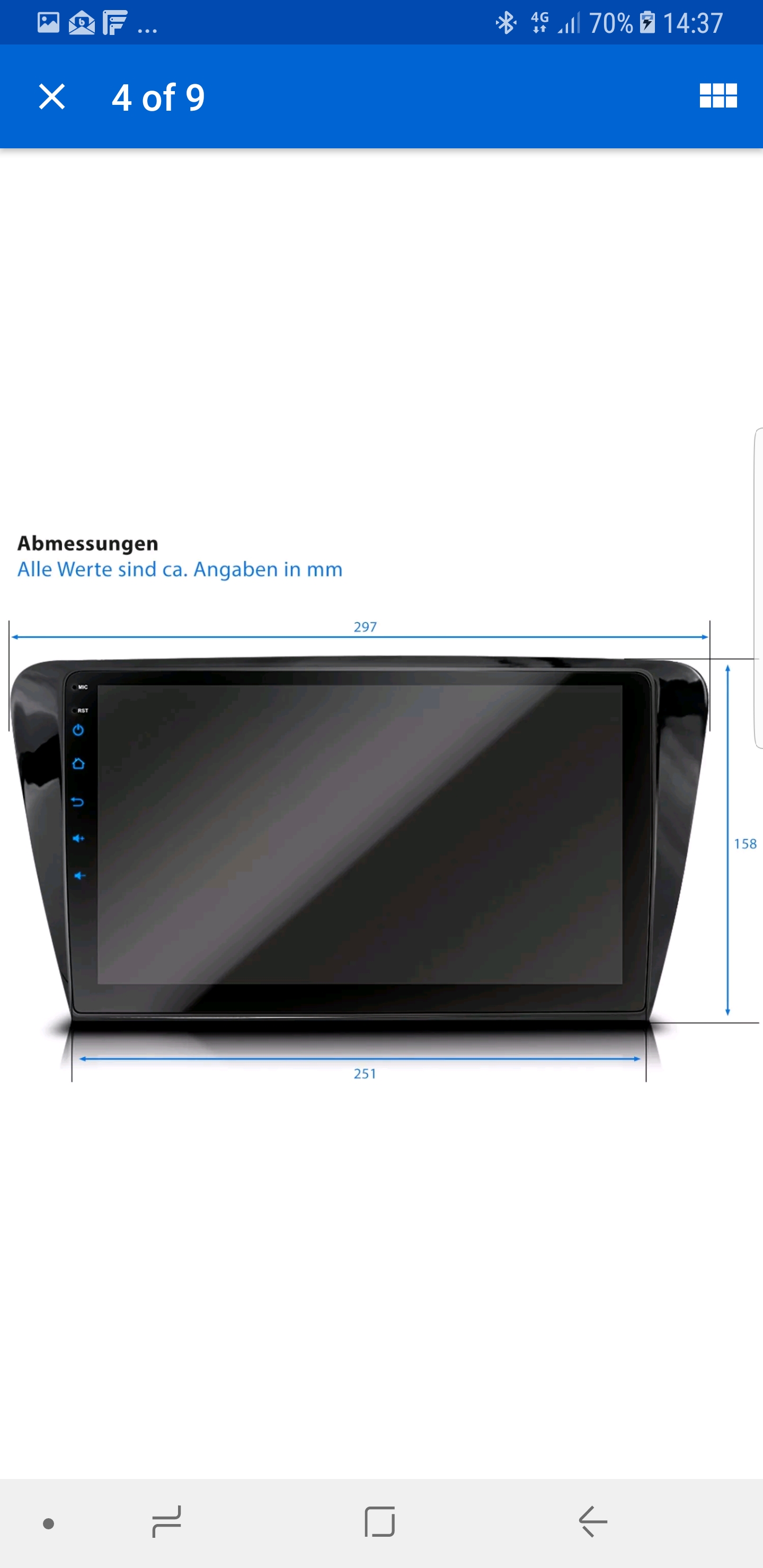

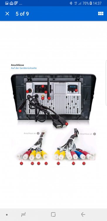

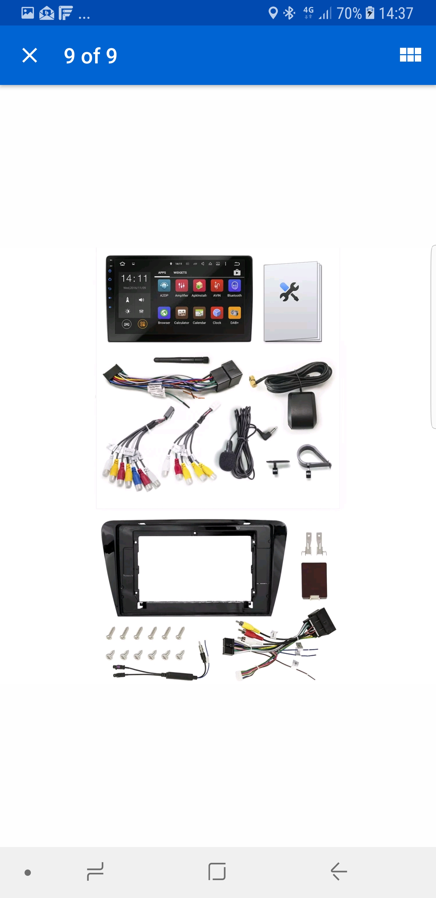

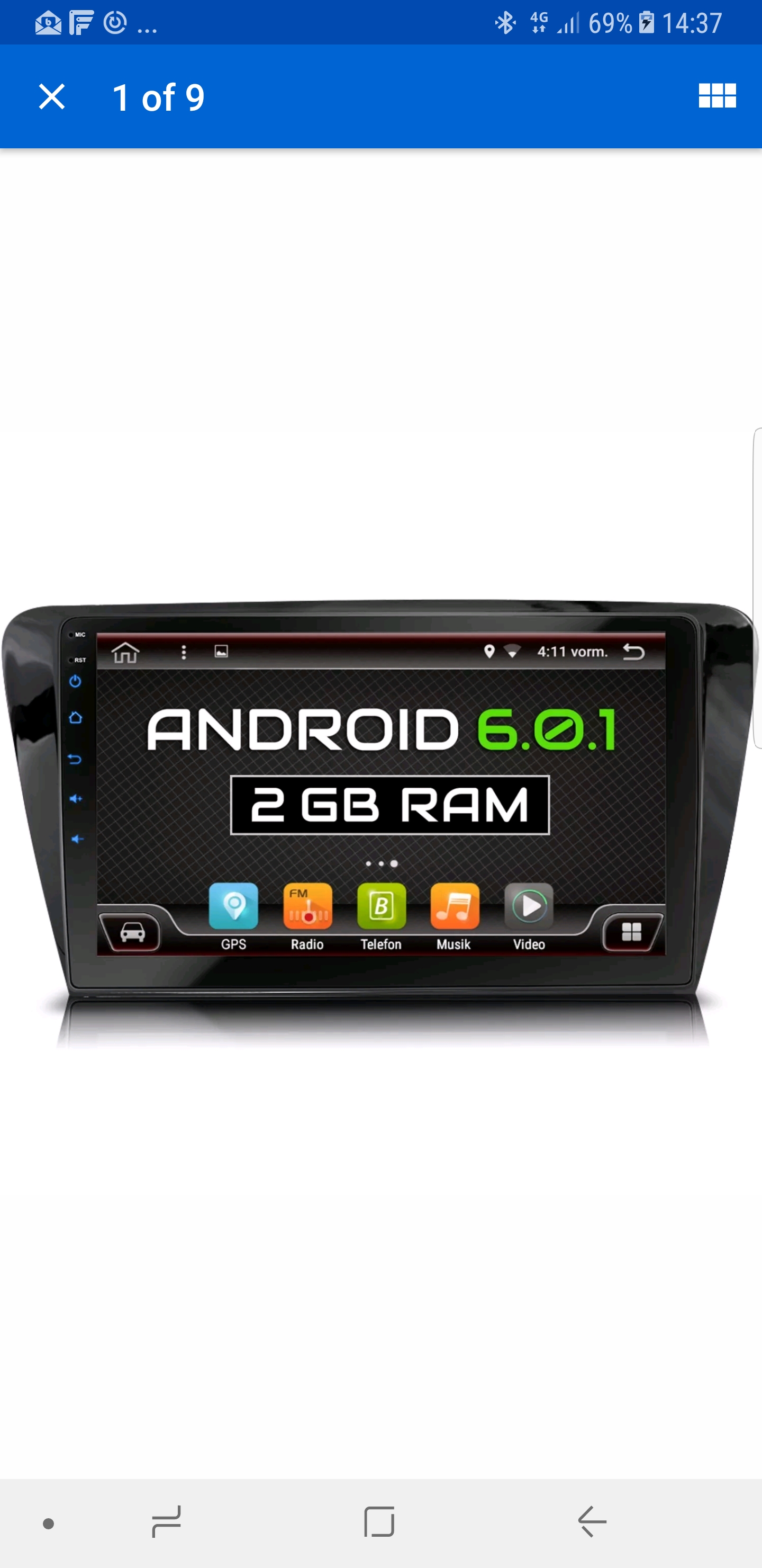

Hi guys I would like to get some help from some of the experienced Skoda owners. I have bought an Android head unit to go in my Skoda Octavia 2014 to replace the original one
I have purchased this one from eBay as it showed up compatible with my Octavia 2014
https://rover.ebay.com/rover/0/0/0?mpre=https%3A%2F%2Fwww.ebay.co.uk%2Fulk%2Fitm%2F222515625776
As I got in touch with the technician who is coming to fit it in it's telling me that it will not fit in as my media unit is in the glove box and the screen is just a screen in the middle. I'm not bothered about getting my car data displayed on the main screen like mileage and MPG and Range and everything I just want this unit to fit in and if it can play media then that's all I want please let me know if it is possible or advise me of the right one if not I am attaching some photos of the headunit I have purchased
yeah you got the correct one. you need to use the connectors that came with the head unit to attach to the plugs from the rear of the unit in the glove compartment. effectively the dvd player becomes redundant.  You still have all the maxidot/steering wheel canbus functions too.
the trickiest job is placement of the antenna for gps and dab. looks like you got the one with built in wifi antenna
Edited by JohnnyType2
Thank you very much for your reply mate that has helped me a lot and relieved a bit of stress I was having for the last 3-4 hours. I was only confused because the guy who was trying to fit it in on coming Monday said that it is not compatible which I thought was a bit strange as it's compatibility was Verified by the owner and manufacturer thank you very much for helping me it has got a built-in Wi-Fi antenna and I'm going to ride the GPS antenna to the glove box onto the side of the dash and the mic on my right hand side I do not have the dab adapter and to be honest with you do not know which one to buy but I'm not fussed about that once again thank you very much for your help.
