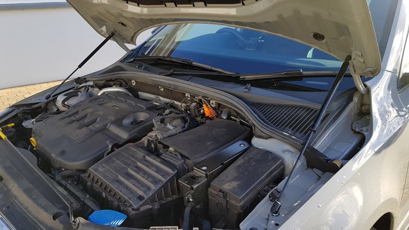

very easy install just need the correct torque bits. Its well worth doing as its a heavy bonnet and the struts will even hold up in v windy weather
When I installed my own (from Superskoda), I could not tolerate zinc color in parts.
So I painted them to match the body colour:

The video posted by silverden is self-explanatory, but if anyone wants a translation of the Polish subtitles anyway, here you go:
Bonnet strut installation - Skoda Octavia III
List of parts needed:
  • 2 x 52 cm gas struts;
  • 2 x ball stud bolts, M8 thread; 2 x ball stud bolts, M6 thread; washers
  • 10 & 13 mm sockets
  • M10 socket key
Installation:
  • Unscrew the bonnet fixing bolt (with socket key)
  • Unscrew the wing fixing bolt
  • Screw in the ball stud bolts in place of the removed bolts
  • Attach the gas struts
  • Repeat on the other side
  • Unfortunately, before attaching the gas struts, we didn't drop the bonnet stay  :-)
  • So we had to temporarily unclip the gas struts again at one end
  • And the final effect
  • Thanks for watching

I bought a pair but only needed to fit one, have kept the other for my neighbour, they were dirt cheap on E-bay, less than a tenner the pair I'm sure and came with several sets of different ball ends.
Fitting to the RHS was easy and I just used a suitable washer in the hole that held the rubber grommet for the OE stay to make up the diameter and a pair of clamping washers either side, at the bottom end the ball joint stud fitted straight into one of the wing bolt holes. I gave the pistin rod a slight tweak at the end to stop it being strained.
I did not fit a reinforcing bracket at the top, if you open and close it with care there is no more load or deflection than given by the OE spindly stay.
Found the listing, they were £7.28 delivered with the different end fittings when I bought them:
