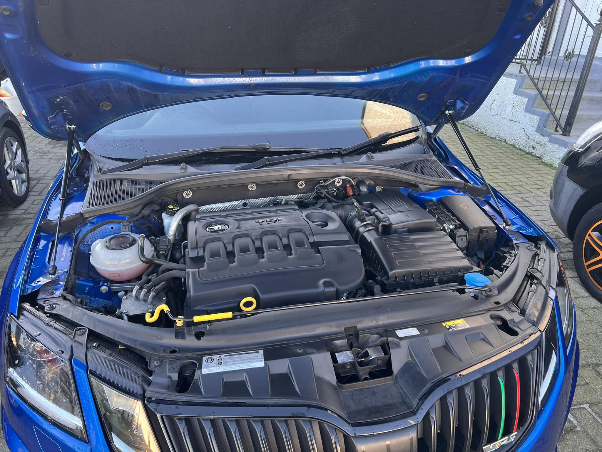

  • As per ahenners post that he kindly did in another thread that makes it easier for everyone. 👍   No I went for Febi Bilstein ones. The Superskoda set came in about 50 euros including deliver
  • I know this thread is quite old now but thought I would add my experience.  I have just completed this mod (my first mod on the new car) and wanted to share what I used and where I got it from, hopefu
  • Here you go...................

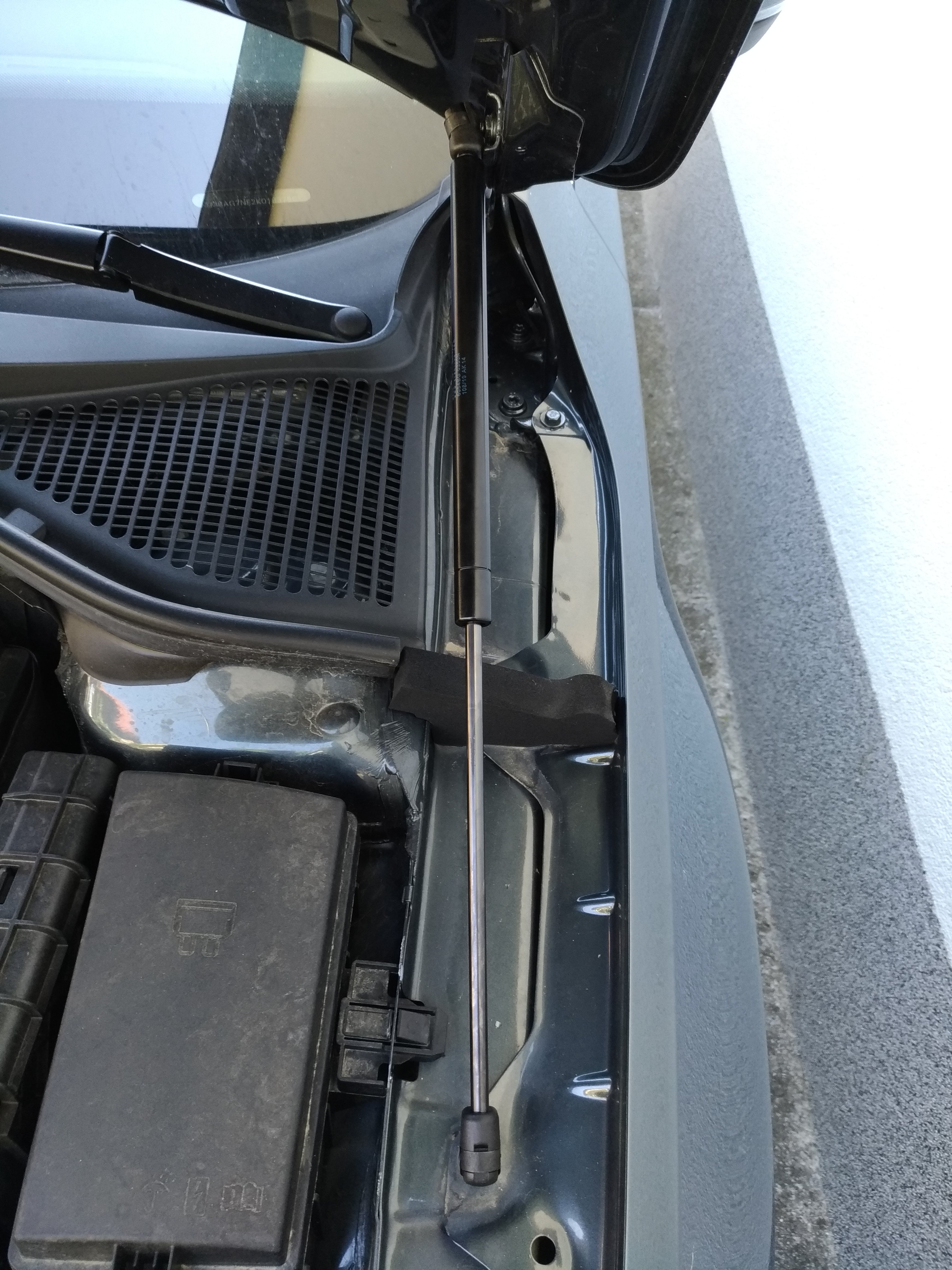

The Febi struts are perfect in strength, they can lift the bonnet unsupported after initially lifting it. They slow before they come to a stop at maximum extension too.
2x Febi Bilstein 27709 struts. About £14 each from an eBay motorparts seller.
2x M8 ball joints with a 10mm ball head and 25mm thread length: https://www.sgs-engineering.com/x4-ball-extension
2x M6 ball joints with a 10mm ball head and 12mm thread length: https://www.sgs-engineering.com/x2-ball-extension
Above ball joints came to a tenner with delivery.
2x M8 and 2x M6 washers. Bought from an eBay seller for a couple of quid.
You also need an M10 spline bit to undo the bolt on the bonnet which I didn't already have.
Painted the washers and ball joint bolts with a touch up kit I already had to make them blend in and look more OEM.
Total cost probably about £42 but happy with the result.

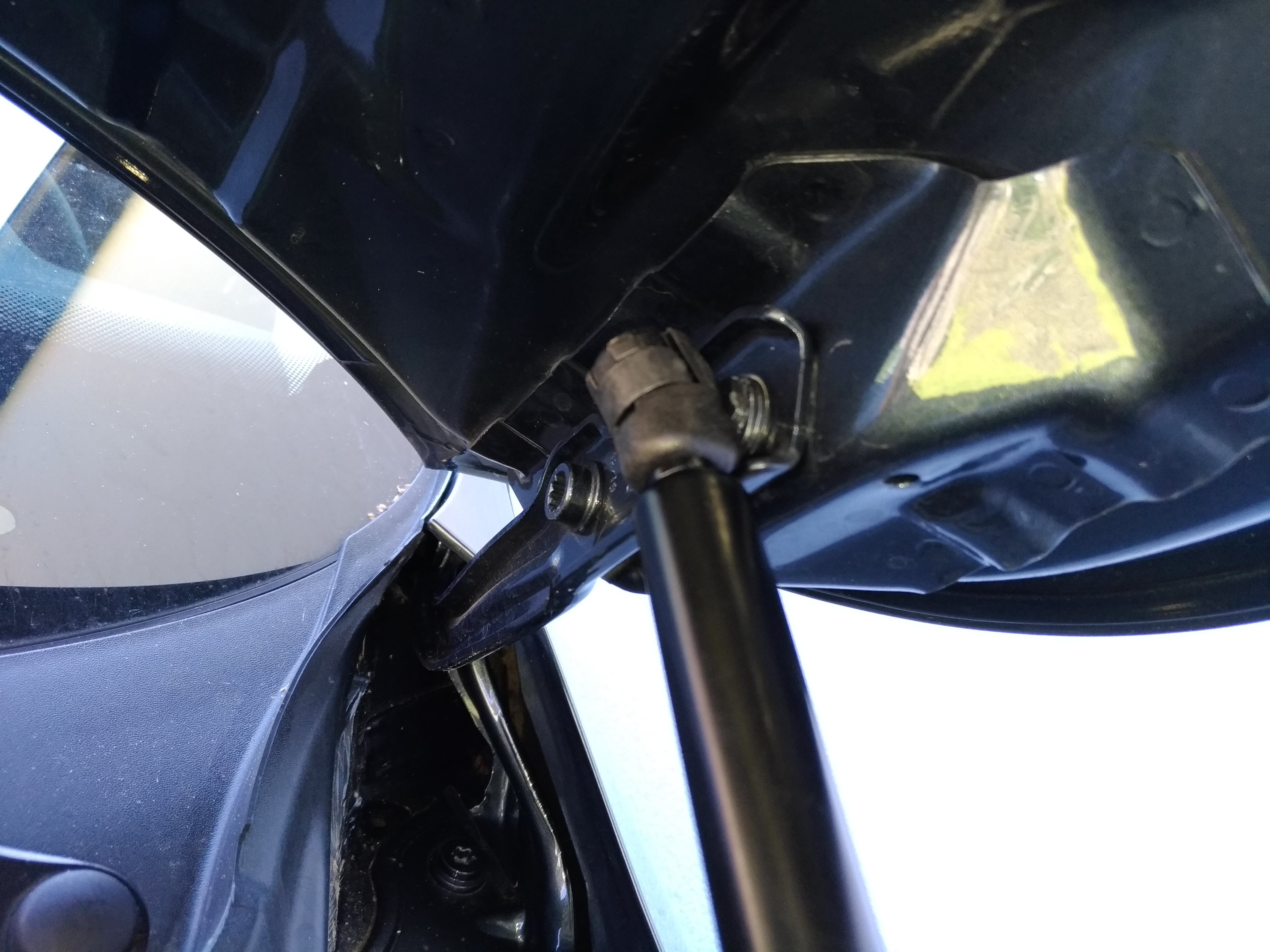

Completed this evening. Took about 20 minutes. Would have take 15 But I picked up wrong spanners. A little dab of copper grease on the balls should keep any corrosion away.
What is quality of ebay bolts? Could strouts brake them...? It arrived everything, must paint bolts and washers. I cant find those m6 and m8 bolts, only ebay.
Strouts are Stabilus 350N 50cm (hole to hole), bought them in local car parts store. 1 costs about 14€.
Fitted today. Couldnt find M10 spline. Thats not torx, something like VW set of bolts M10 size. Strouts are Stabilus 350N 50cm hole to hole. It works great. 350N seams realy just the right force. 50 cm length of strouts can be 1-2 cm longer. With 50 cm hole to hole is a bit lower ther with arm. Arm puls the hood even higher. Bolts and washer i painted whole with touchup kit, basecoat and clear. Basecoat peals easy, when I tightened up. So need to touch up more a bit. But overall is better when painted. Must put some greese to keep water away of inside bolts holes. Hood bolts needed 2 washers each. Plastic head of struts now are close to those hood metal holders. Bolts are long ones 25mm.
