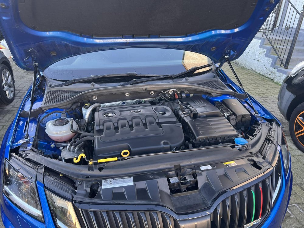

New user here! I'll be putting a post in the hello/goodbye section soon with all my car details etc. In the meantime I have just ordered the parts for this :-) They will be delivered on Monday but it will be a couple of weeks until i get around to installing as i'm off on holiday. I'll let you know how it goes!!
And for those whose OCD needs them to remove the old stay. It took the second bang on the head to sort my OCD out and refit the stay.:wacko:

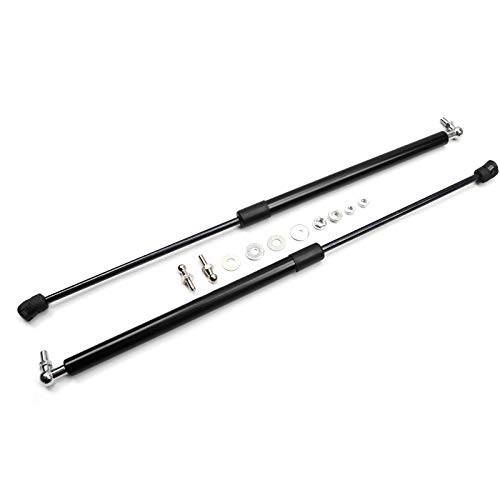

I bought a pair but only needed to fit one, have kept the other for my neighbour, they were dirt cheap on E-bay, less than a tenner the pair I'm sure and came with several sets of different ball ends.
Fitting to the RHS was easy and I just used a suitable washer in the hole that held the rubber grommet for the OE stay to make up the diameter and a pair of clamping washers either side, at the bottom end the ball joint stud fitted straight into one of the wing bolt holes. I gave the pistin rod a slight tweak at the end to stop it being strained.
I did not fit a reinforcing bracket at the top, if you open and close it with care there is no more load or deflection than given by the OE spindly stay.
Found the listing, they were £7.28 delivered with the different end fittings when I bought them:

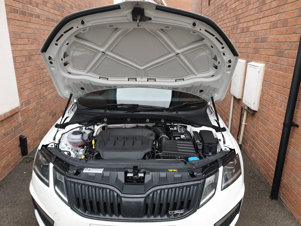

That's mine all fitted, is it just me, when you've finished the job, you carn't stop opening and closing the bonnet?
Thanks to Gusto and others who have posted on this subject.
@NZ100 yes! I’ve never opened and closed a bonnet so much in my life after fitting these.
Did you remove the original bonnet holder or have you left it there as a back up? I was going to remove mine but I ended up leaving it.

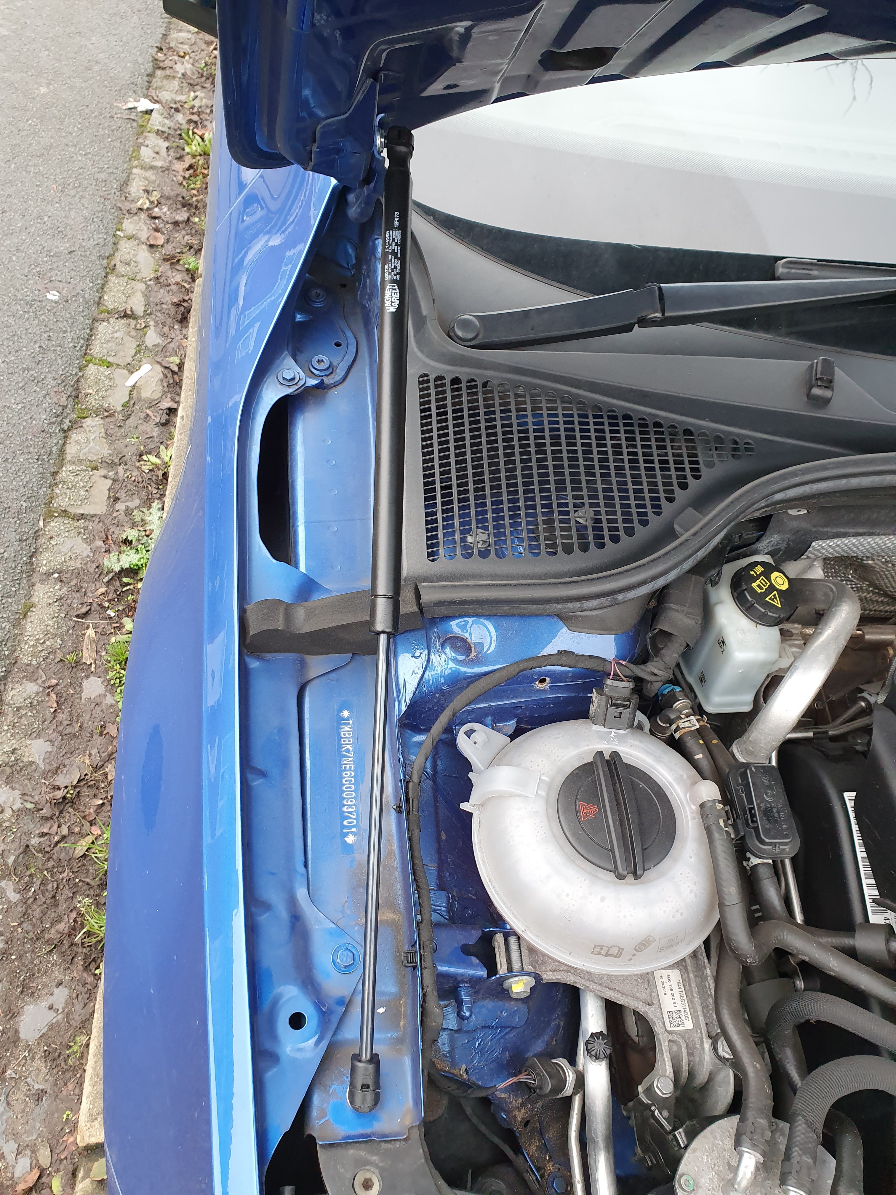

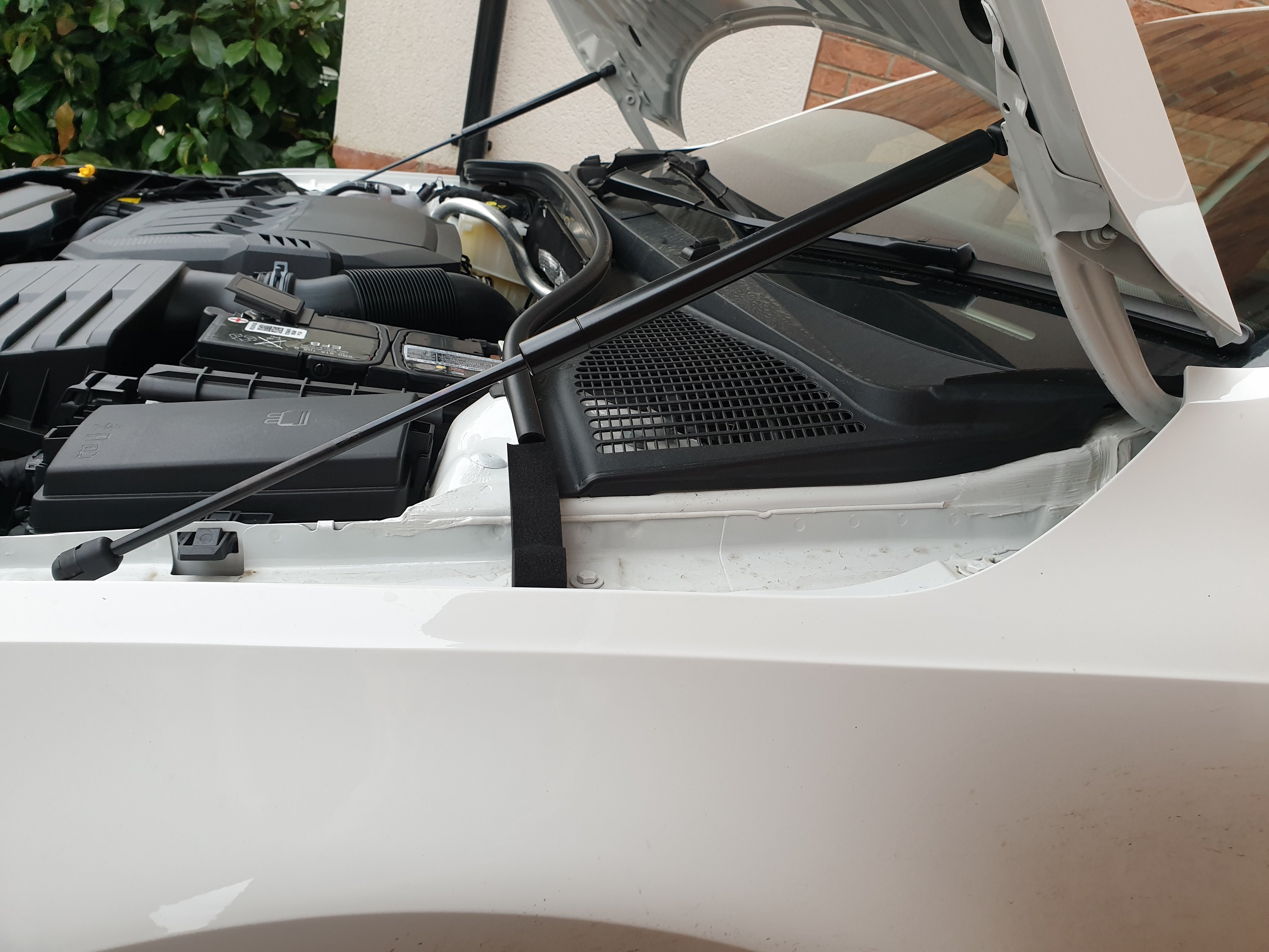

Mine shown on page 6 of this thread.......

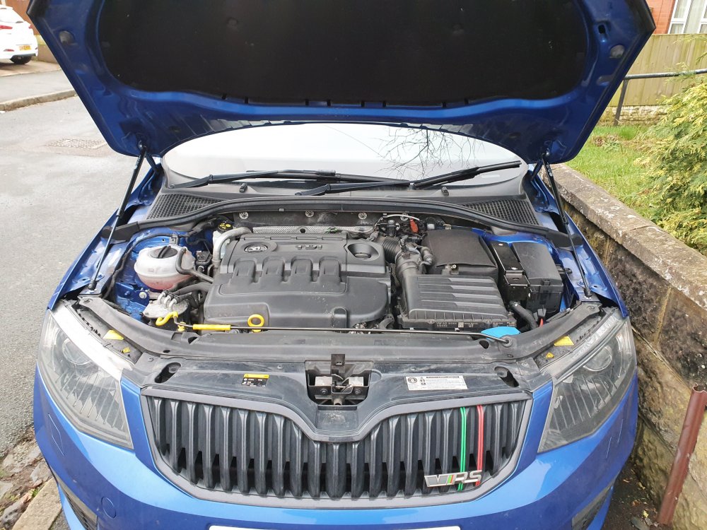

Hello I just make to my Skoda but I  use from the previous  car Skoda Octavia 2 from boot gas struts and put on the screws  from the light 😉 till the shortest  came I must wait  a little.
Works  very  well and is very  softly 😁

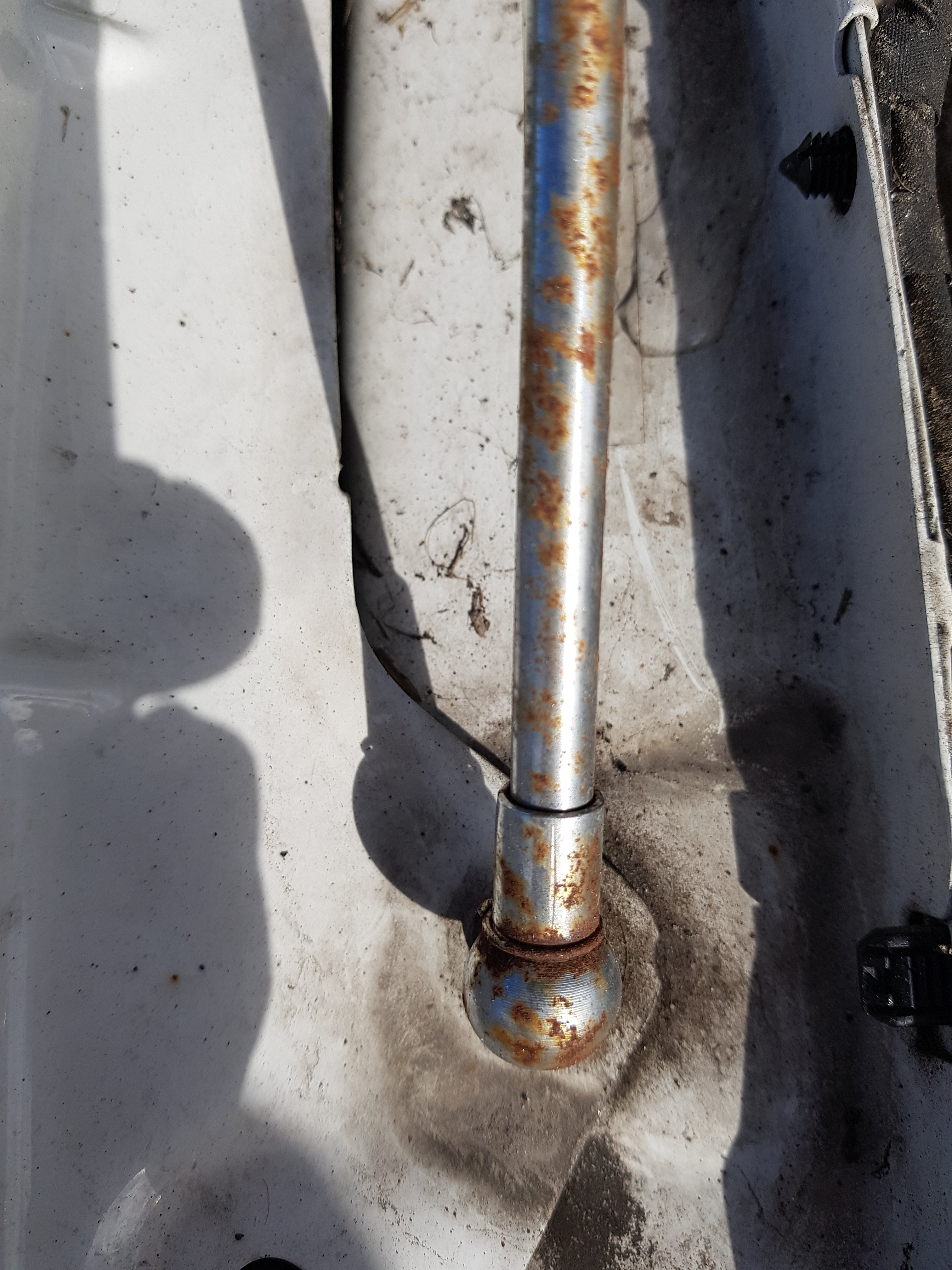

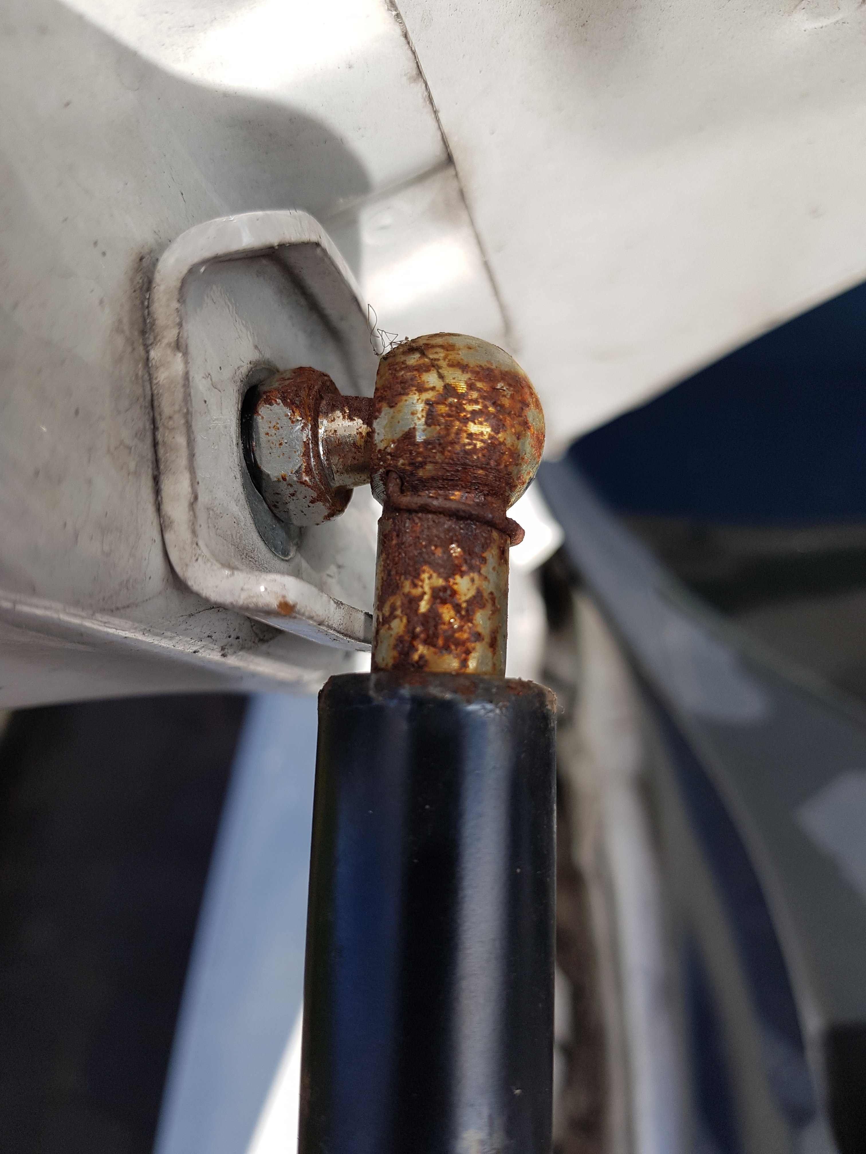

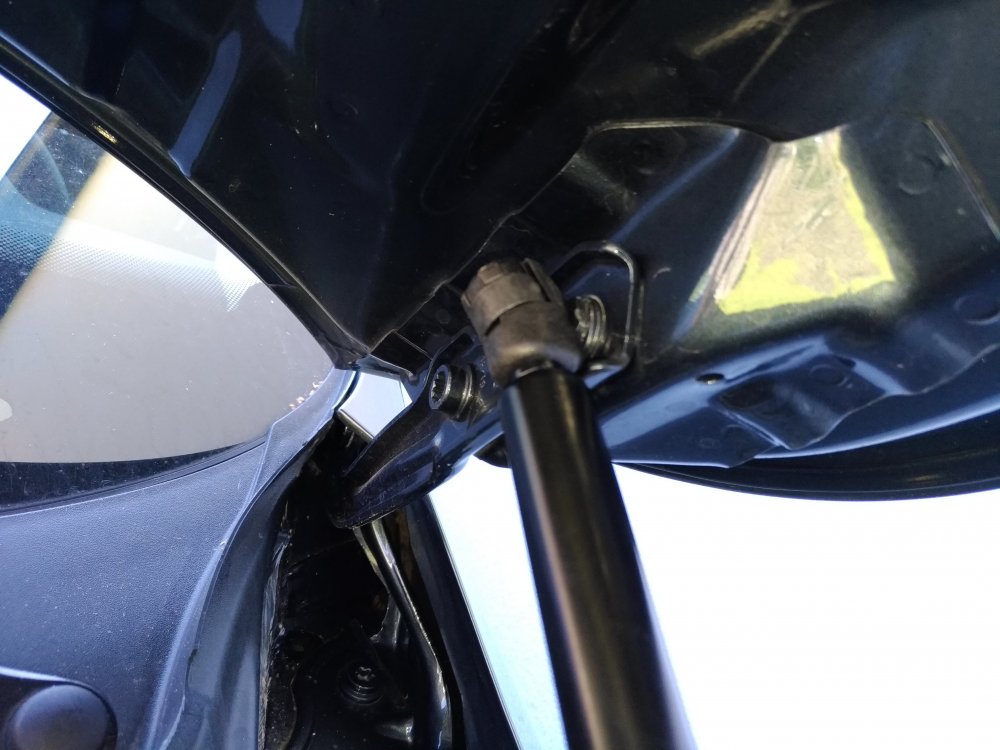

Anyone else's go really rusty over the winter?
Bought mine on ebay and was shocked to see the state they are in after just a year. Most worrying is the little clip that holds the ball in the socket looks well rusted and like it could snap then the bonnet would come crashing down.
Forgive the dirt of the car :)
