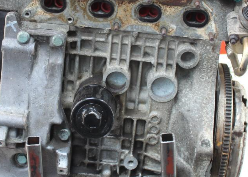

Look down between the back end of the alternator and the exhaust manifold.
Part number 030115561AN according to this page.
