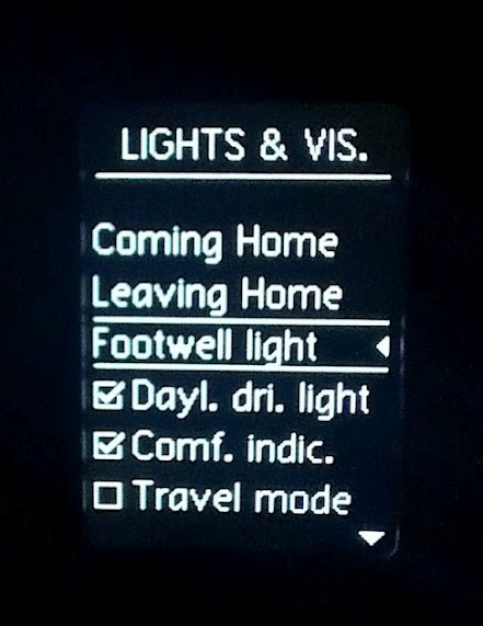

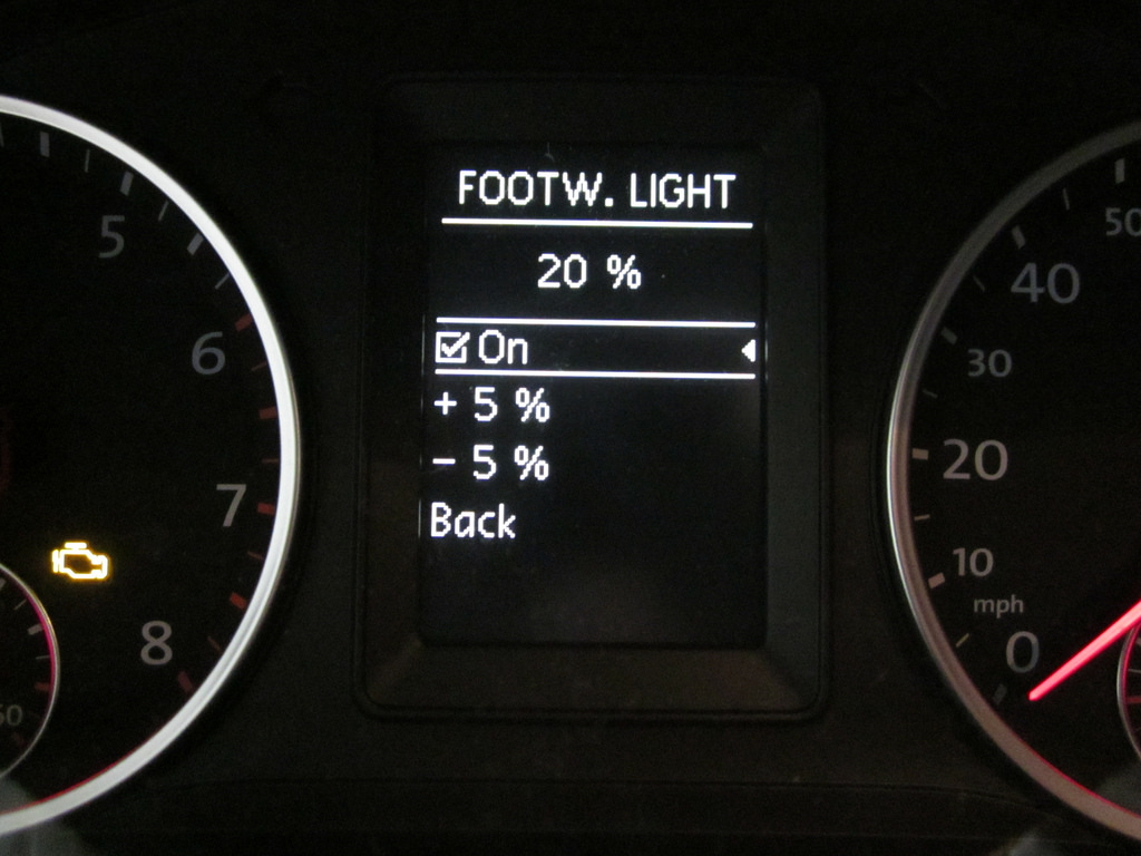

if its anything like the mk2 Octavia, then its under Lights & Vision.
5a8e187eadd29_mk2footwell01.jpg.22169ed46d4deec0a70a4aacd0d6eda7.jpg 5a8e188212247_mk2footwell02.thumb.jpg.4fdc4154f004909d8cd669f131fe07c7.jpg
It most likely needs to be activated via VCDS, try and find someone local who is able to help. :)
