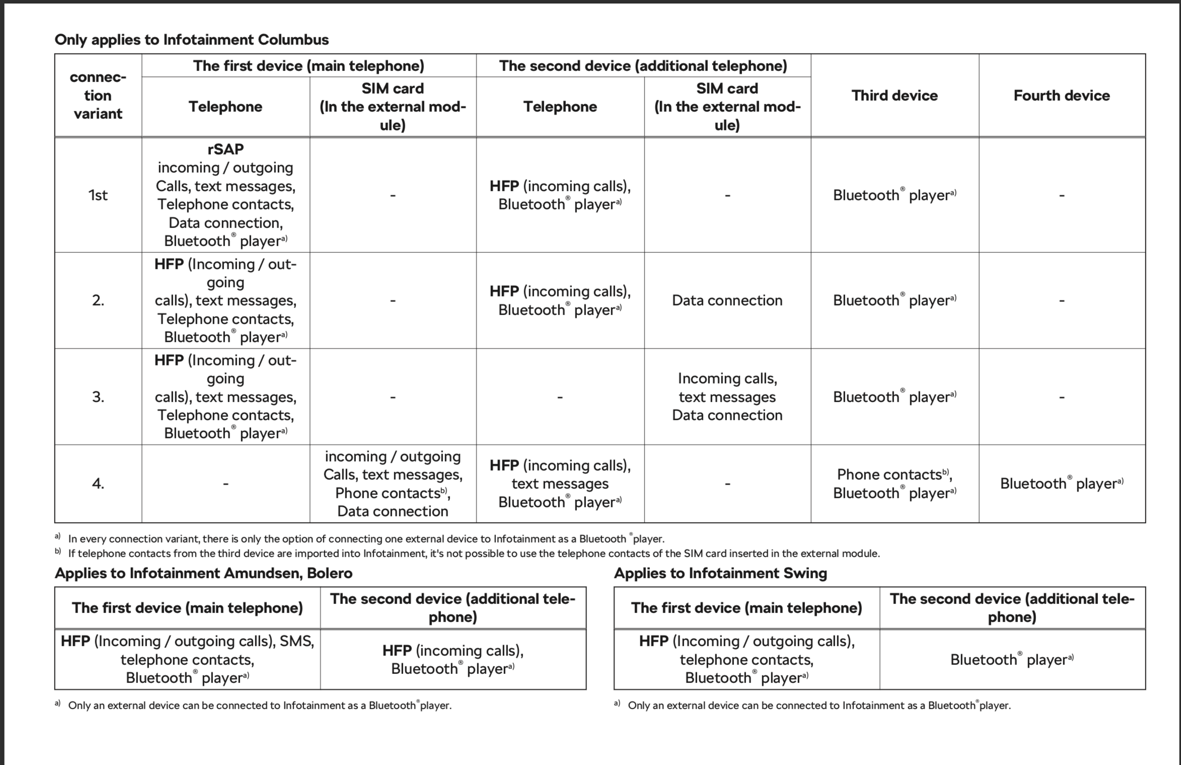

You can connect multiple phones via bluetooth simultaneously but if using CarPlay it will not allow a second phone to be connected (Amundsen at least) via bluetooth.
Skoda Connect App does not require a data connection between your phone and the car, this app is updated through the web.
Skoda OneApp requires that you are connected via USB or Wifi to the infotainment system (not sure if it works when using your phone as a hotspot)
Your infotainment system will need a data connection (SIM card, Phones Hotspot or USB CarStick) for traffic updates, online destinations set by Skoda Connect App, etc.
So you can use two phones at the same time via bluetooth and use the above apps but not when using CarPlay or Android Auto afaik (applies to my18 cars at least). You can only connect one phone at a time to CarPlay.
