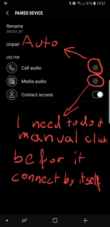

Now i have new phone Samsung galaxy note8. the rns 315 and phone are connecting automatic only for calls but not media as it did with my old phon Samsung galaxy s7 edge. If I wont it to be connected with media to I need to do it maunal every time I sit in my car befor it connect automatic. Attach a Picture to see what I mean. Do you have any idea what to do to work properly?

If my phone have newer bluetooth protocol and the rns 315 older why when i do manualy work but not automatic? So i can explain it this like that no mather what version is of bluetooth the phone. The phone have all the version supported so head unit can recognize it and it should connect. I find out this if the call audio connect first it is unable to connect media audio. So the first it need to connect media audio and than call and than call audio. This mess up the rns315. If could be fixed it will work prfect.
