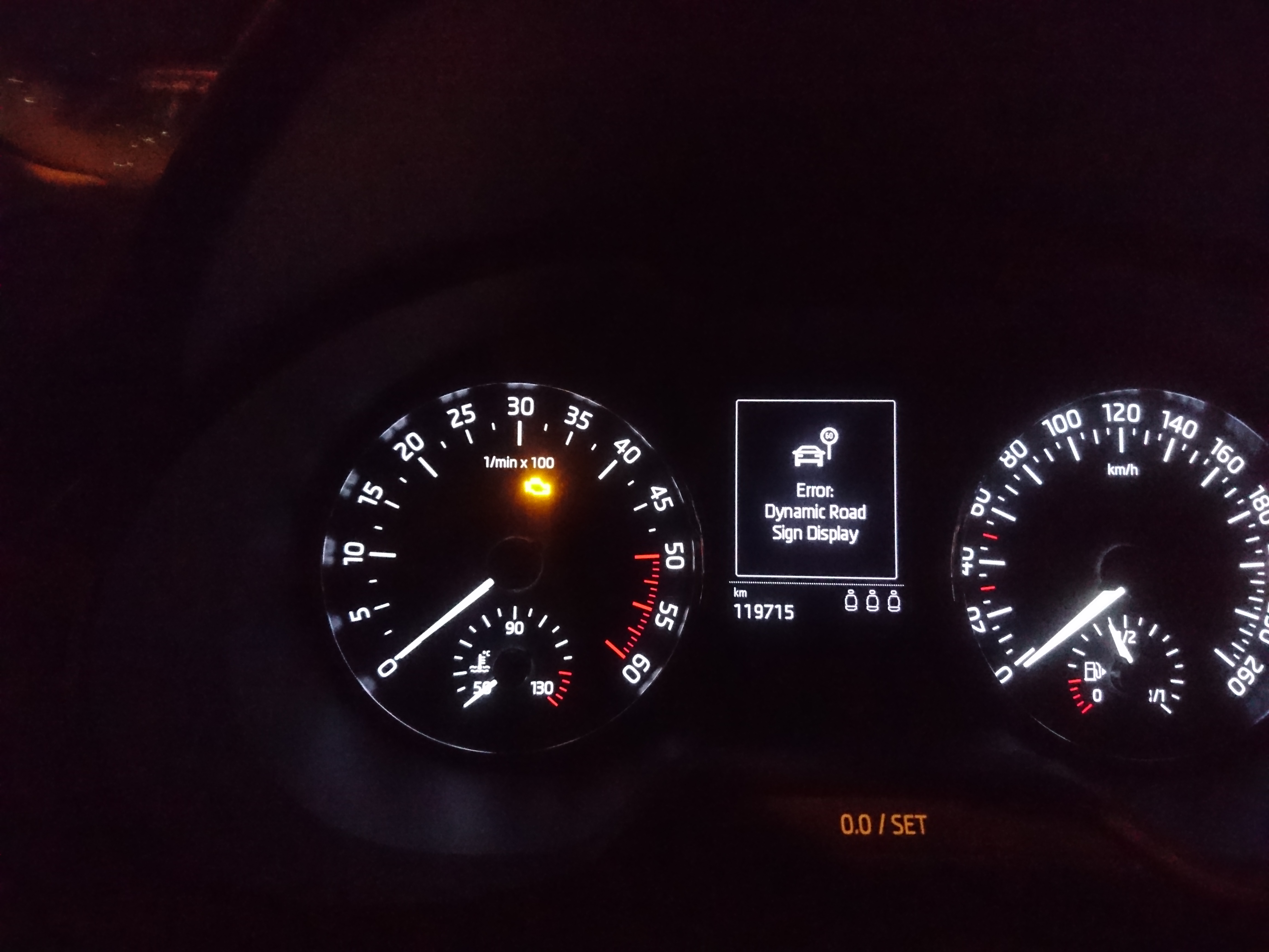

Hi. Could somebody help me? I own OCTAVIA 3 2.0tdi with mib1, Amundsen and b / w maxidot. A friend played with VCDS and "accidentally" ticked traffic sign recognition installed. Now I have a constant warning of the Error Dynamic Road sign Display on ignition, even though everything is restored to the initial values. how do i fix this ??? Thanks in advance
DId your friend perform a soft reset in VCDS after resetting the coding/adaptations?
Edited by wg100
Try force rebooting the headunit. Press and hold the power button until it switches off and on again.
we tried force reboot of headunit but not soft reset of instrument cluster whit vcds
Should i go back to instruments in vcds and tried to do soft reset of it
Also check for fault codes and clear them.
Won't hurt to try.
Post an autoscan.
Was it a genuine VCDS cable and software 18.2.0? Have you checked the logs/coding directories to double check what changes you've made?
