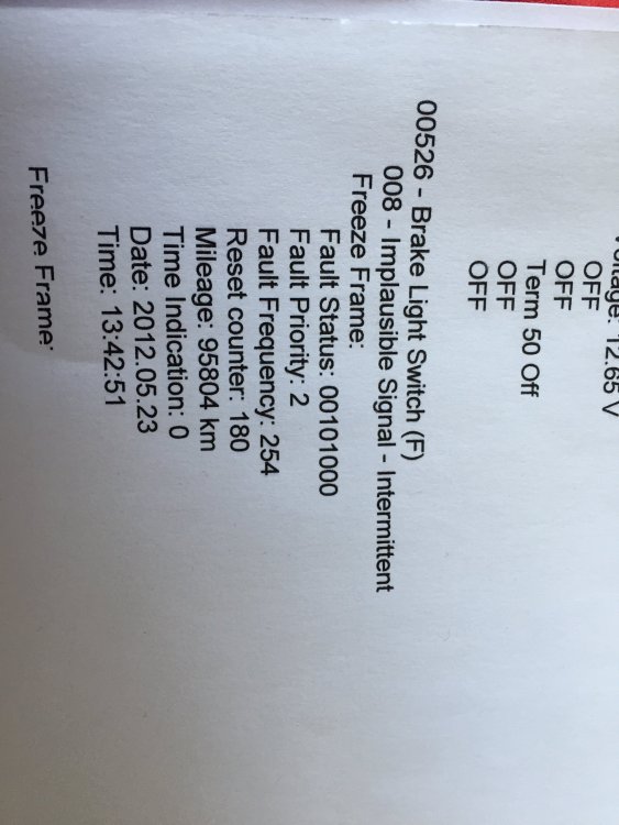

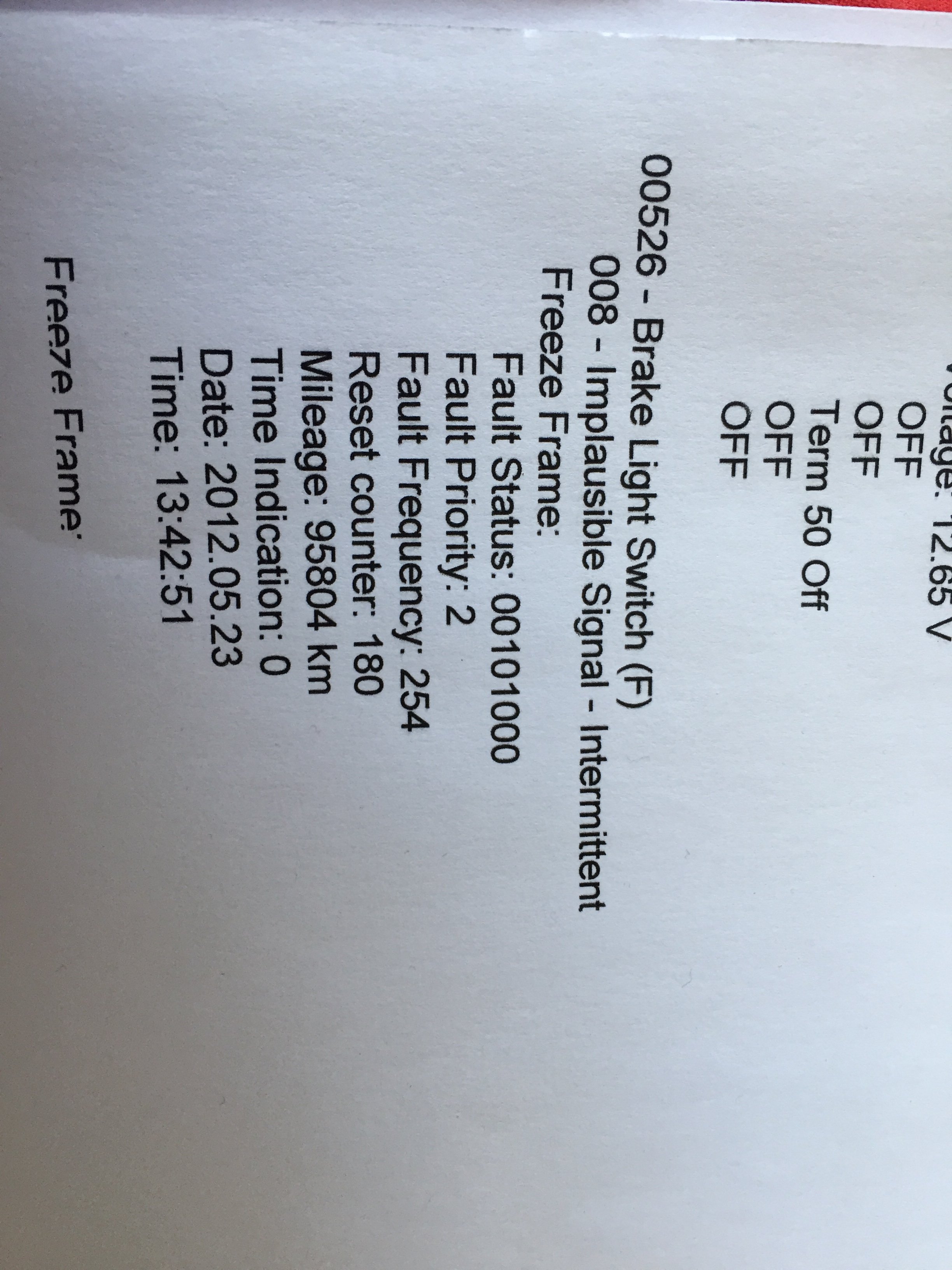

Can you post a full VCDS autoscan?
I have all printed so i took picture if you need more I can take more pics.
