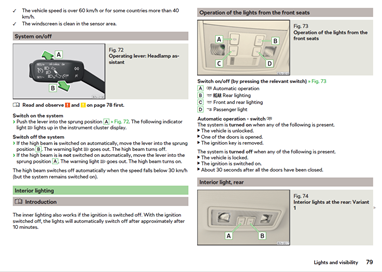

Hi Alan and welcome. There is an auto setting for the interior lights, shown in the manual as below. That may be what you need.

That might be it, i'll try the A button shown in the manual and report back later.

So I tried last night and with the A button pressed in the out position the interior light don't work at all.
I have copied this out of the manual and found with the button pressed in:-
Automatic operation of the lamp - switch
The system is turned on when any of the following is present.
› The vehicle is unlocked. - yes it does turn on the interior lights when I unlock the car.
› One of the doors is opened. - yes it does turn on the interior lights when I open the door before and after journeys.
› The ignition key is removed. - Now technically I don't have a key but when I turn off the ignition with the stop button (Which I would assume is the equivalent of removing the key) the interior lights do not come on. This is the part I have an issue with, when I stop the car and before I want to leave, the lights should come on to allow more to collect my things before opening the door.
Thanks guys, can anyone confirm this is how their superb behaves?

According to the manual there are 3 triggers for interior lighting:
1. Unlocking the car
2. Opening a door or the boot
3. Removing the key from the ignition
It would seem that only 1 and 2 are applicable with KESSY, with no substitute for 3.
