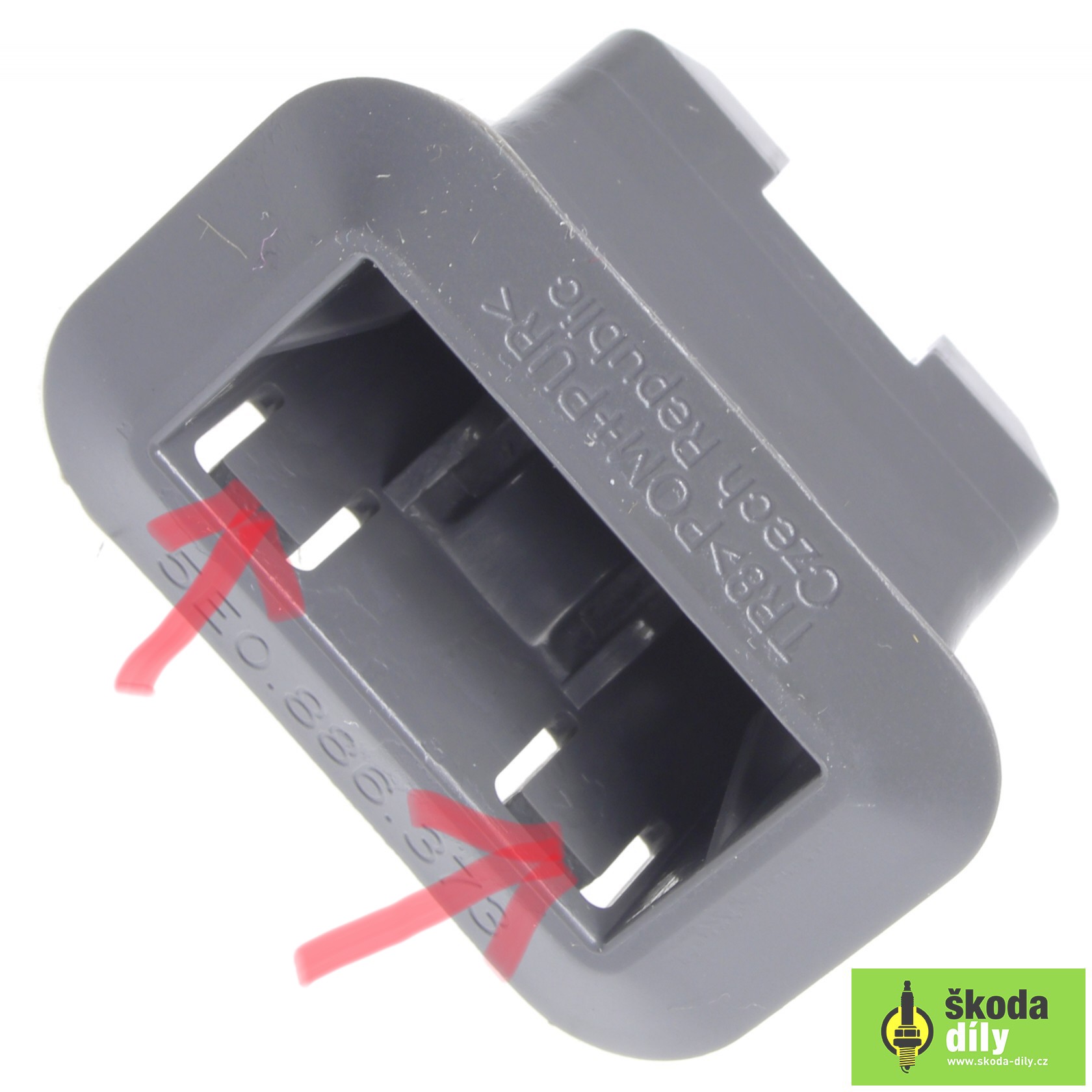

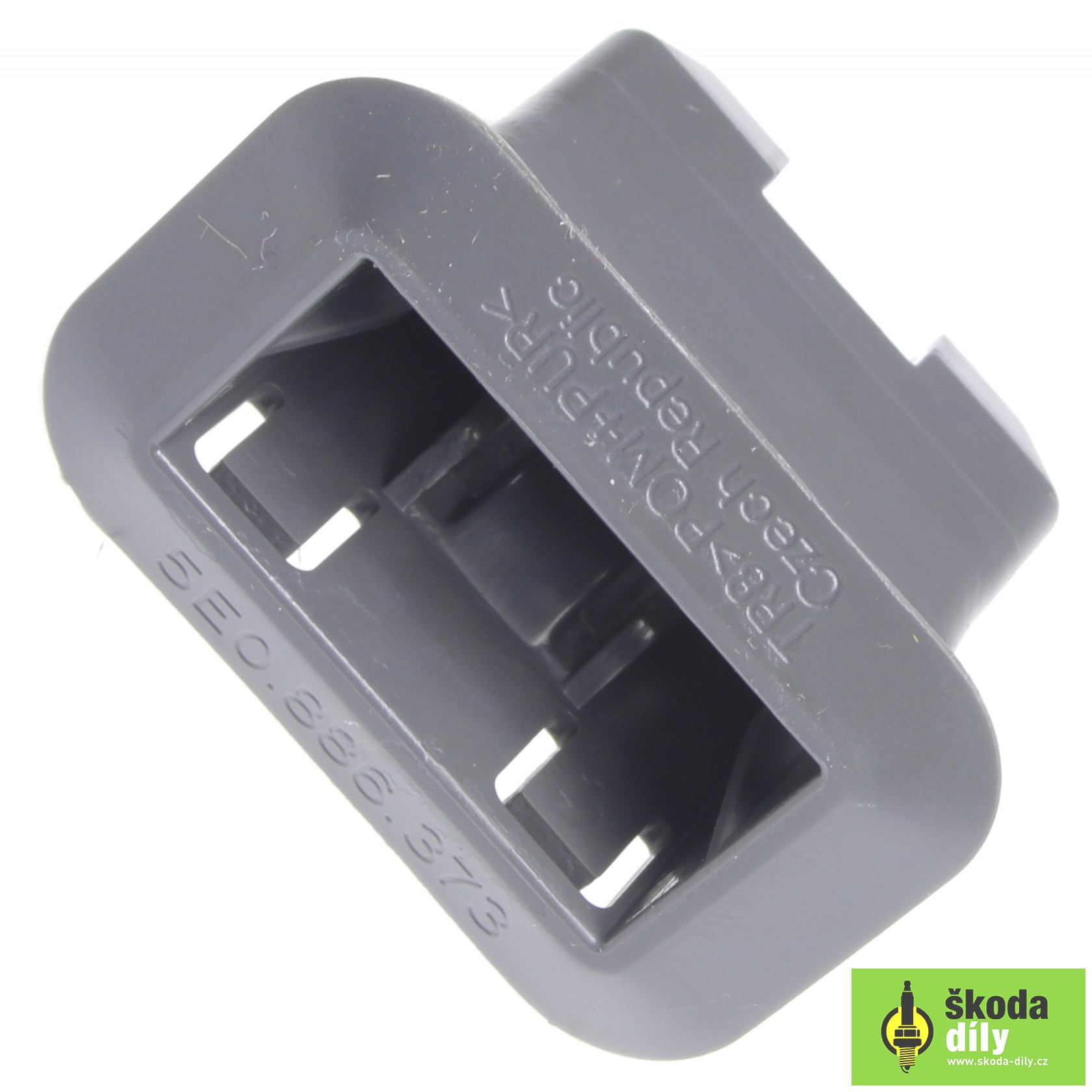

The plastic clips that lock the U-shaped rods are single use. Part number 5E0 886 373.    Simply clever :blink:

There are four little clasps retaining the clip, they are tricky to release without scraching the metal around, so I broke mine with a tiny screwdriver to loosen the clip.

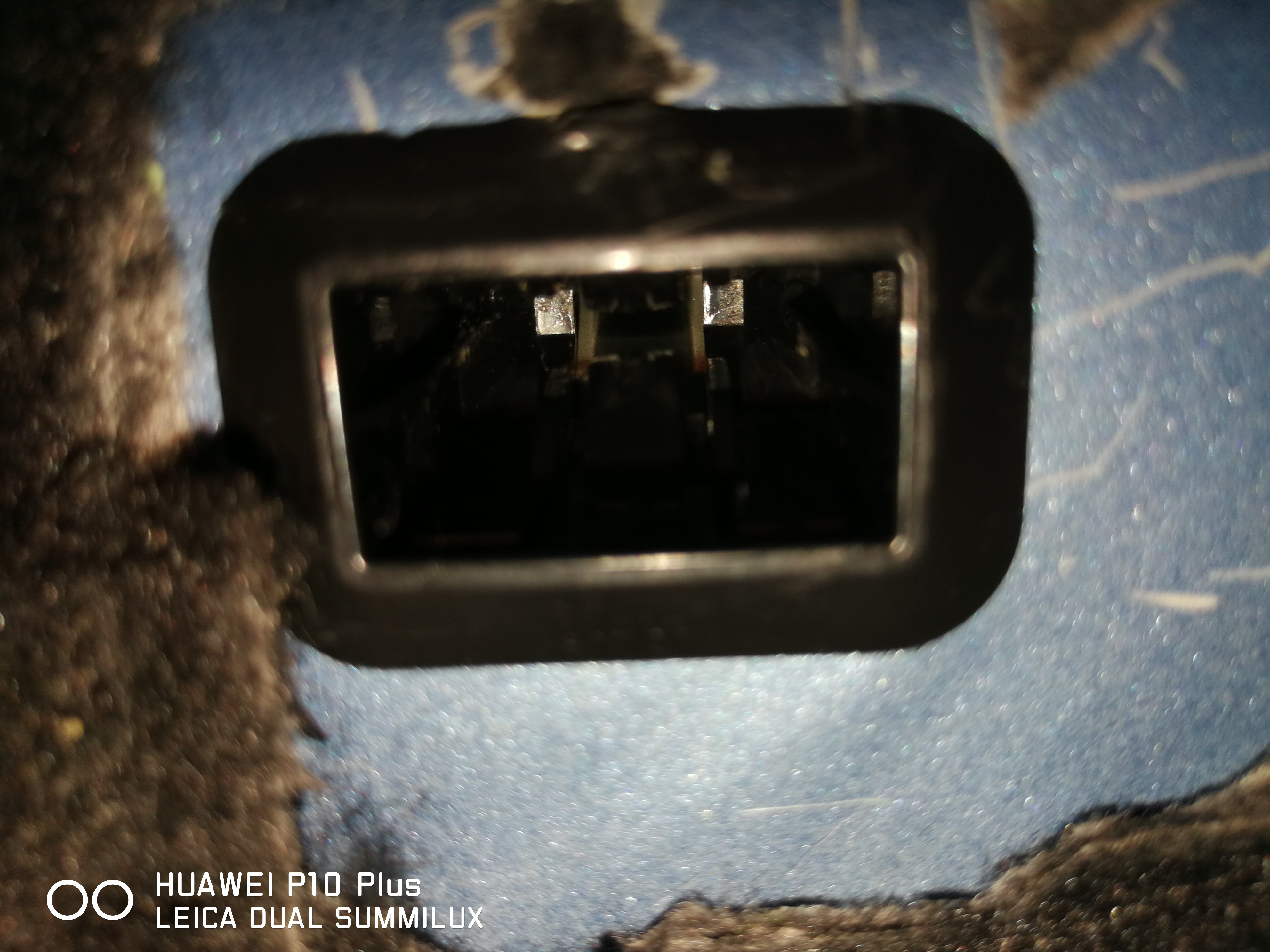

That's the picture of mine..do you think this is dam damaged?
I didn’t fix them. Broke the clasps so they can be extracted without damaging the base, and plugged the new ones. I don’t think they are meant to be fixed. Inside there are two pins that catch the U shaped thingy and bend to lock it tight, after you pull up the seat they remain bended and can’t lock any more. Every time the seat is lifted a new clip should be inserted. Damn “clever” engineered. They cost less then one euro each, though. Good luck changing them, mate!
I've already ordered them. each is £1.68. so now i think i can put the leather cover back and with new Grommet there shouldn't be any problem of locking the seat base.
