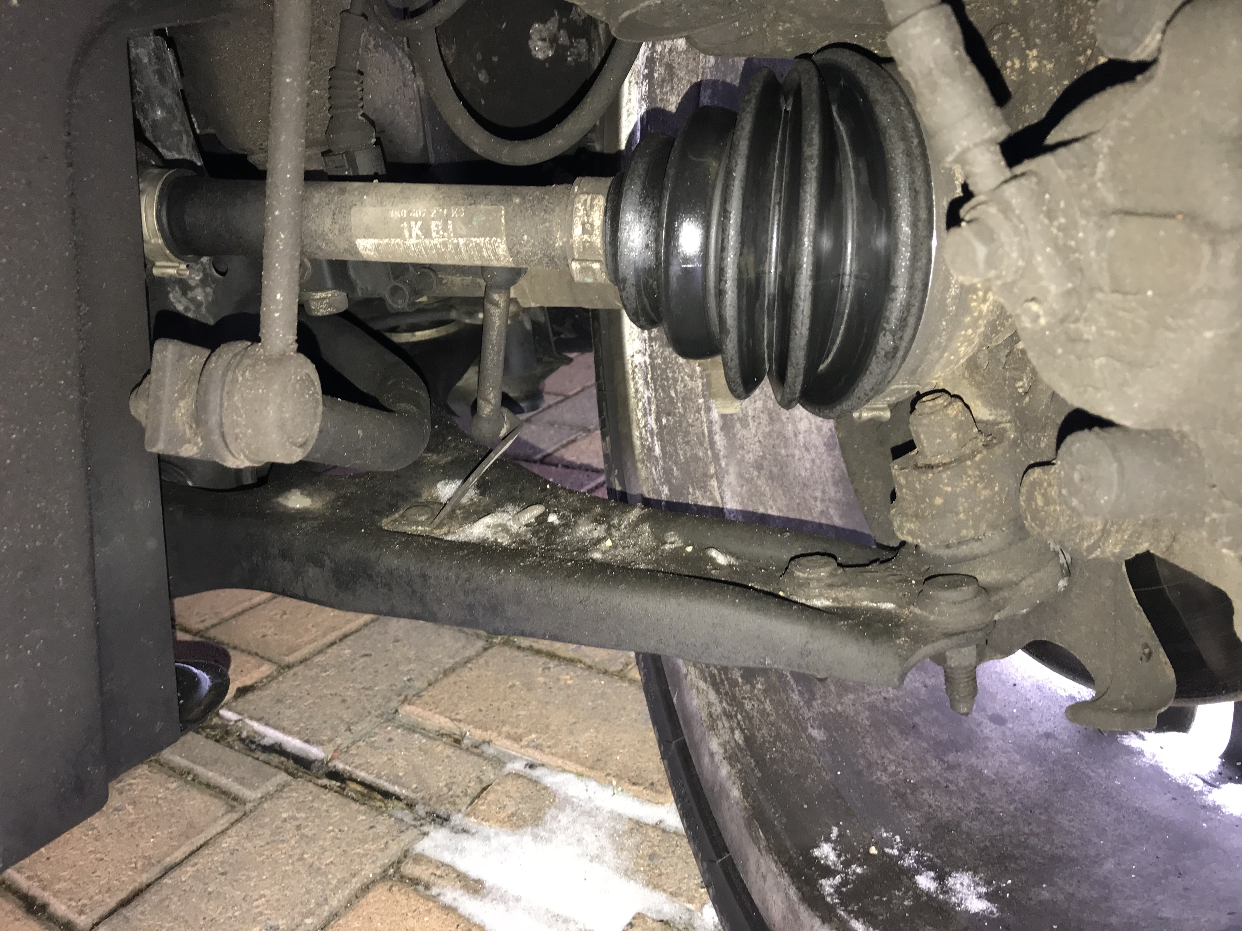

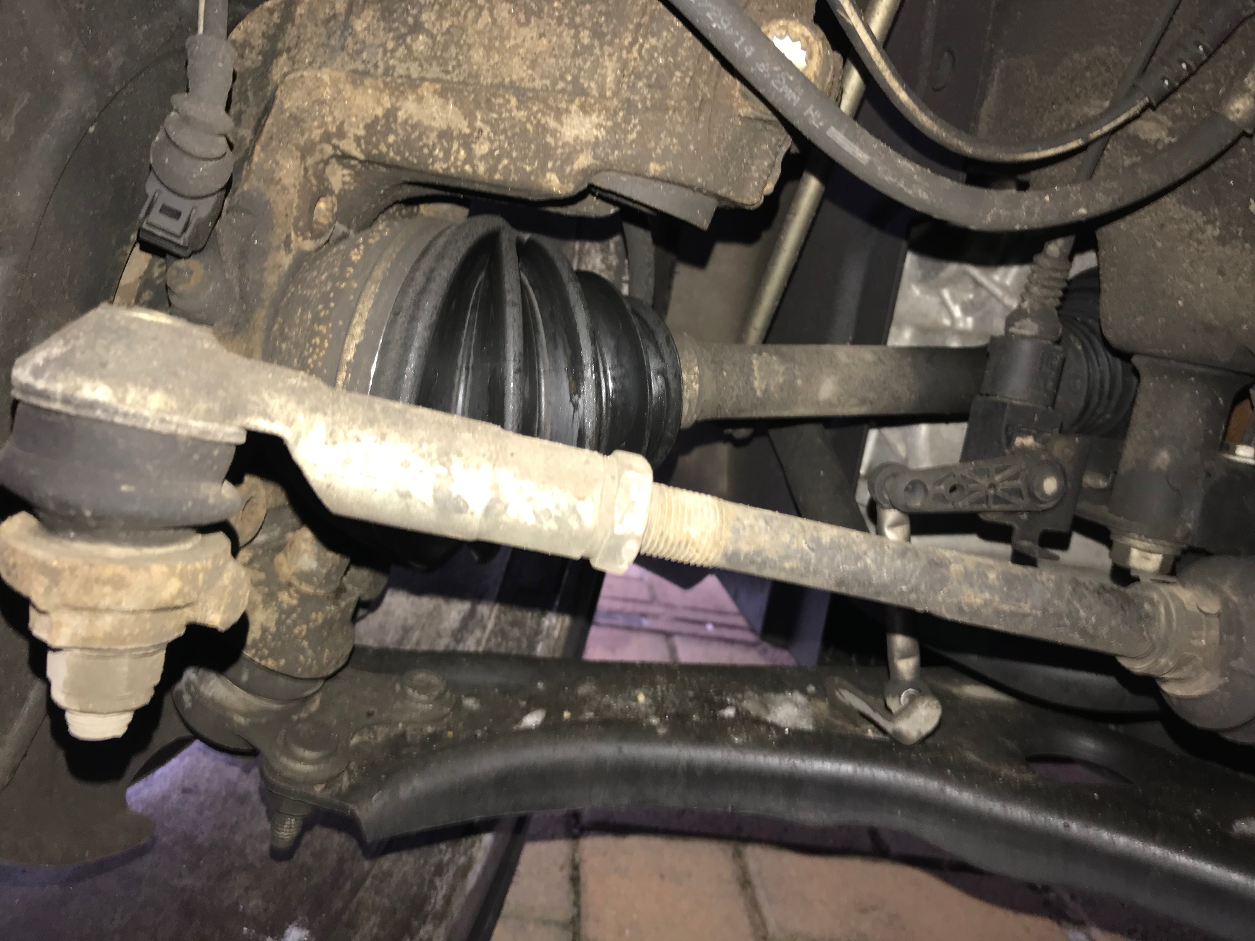

Super, thanks all, I visually checked with a camera and it looks safe enough to at least take out for the alignment check.  To my eye I can't seen anything obviously bent out of shape (in comparison to the other side).
Rear shot, wheel turned in
Front shot, wheel turned out
