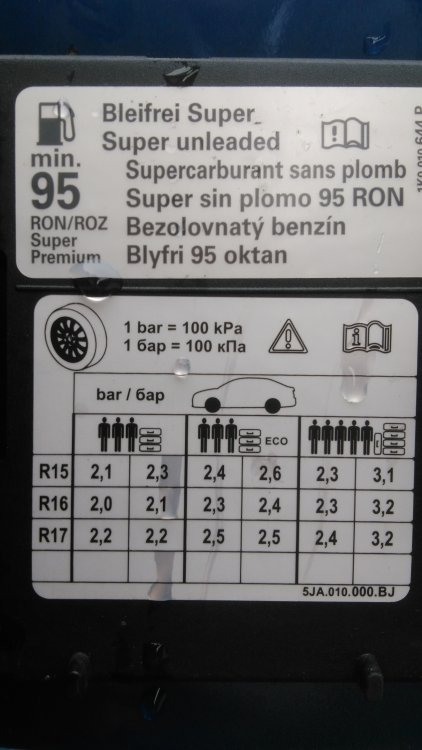

Hi, I have 185/60 R15 tyres but somehow I have lost the sticker located on the fuel flap. Does anyone know the right tyre pressure or  have a photo from the sticker. Thanks

I posted a picture of the filler flap on this forum a few weeks ago...
here it is again.
UK specification 1.2TSI Rapid sport (2017).

I have just added the picture to the "Rapid Documentation" folder, hopefully it's appropriate for it to be there.
Great. Thanks so much.
