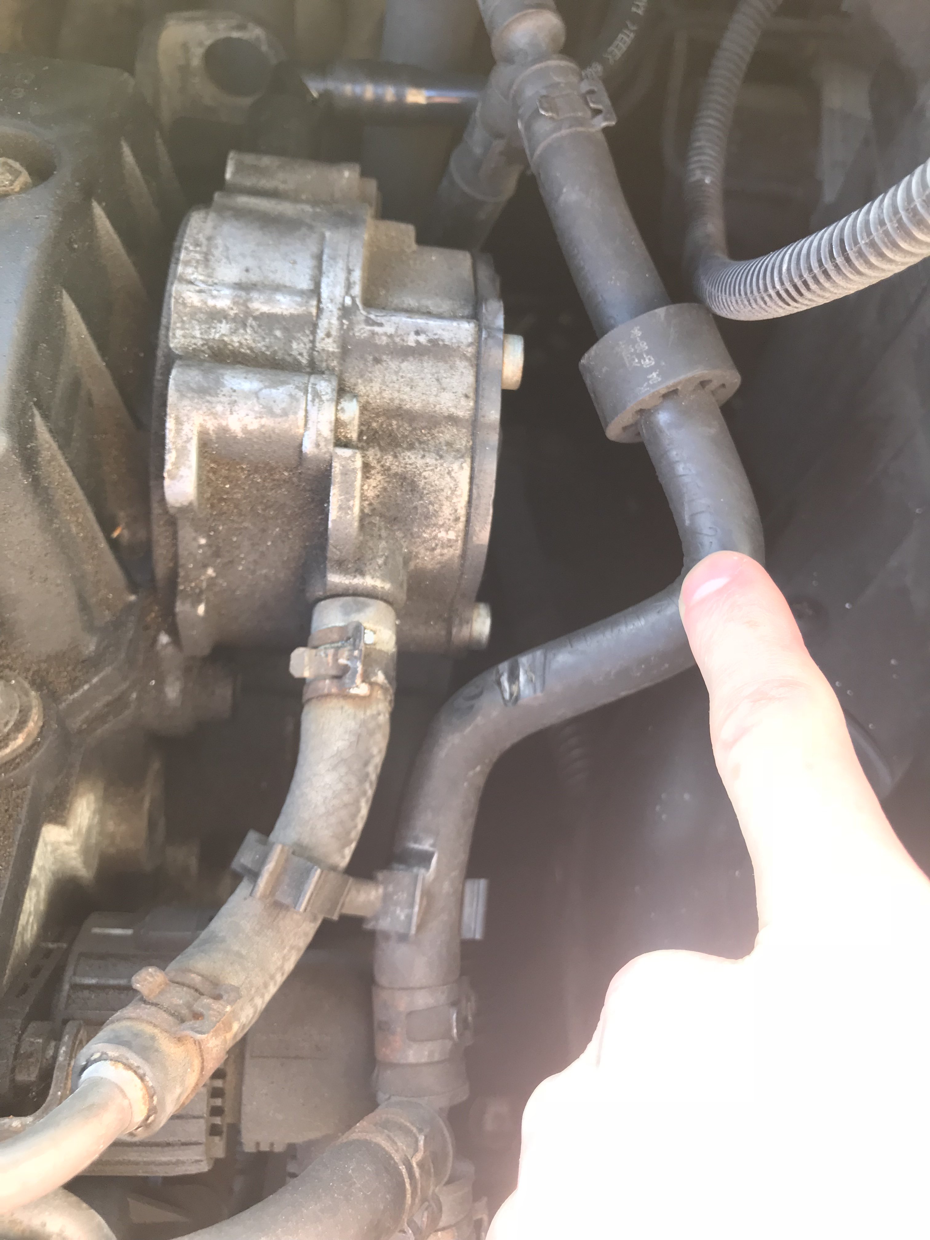

I attach a picture of a pipe also around the tandem pump that I noticed was damaged by clips. I’ve moved the clips to prevent further damage but could this be related? I don’t know what this pipe does?

That damaged pipe looks like part number 6Q0122447CE which is a coolant pipe.

Thanks!
..and explains why I can’t find it in vacuum line diagrams.
So. That’s not the cause of my now poor braking again and poor spool up of turbo at low speeds.
Rechecked all visible vacuum lines and all seem securely connected. Hmm
