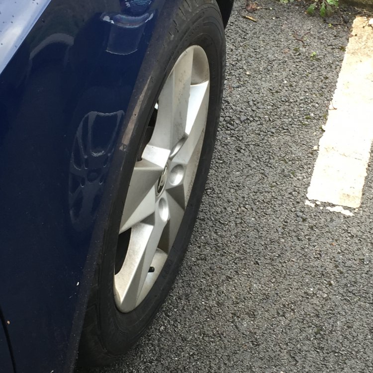

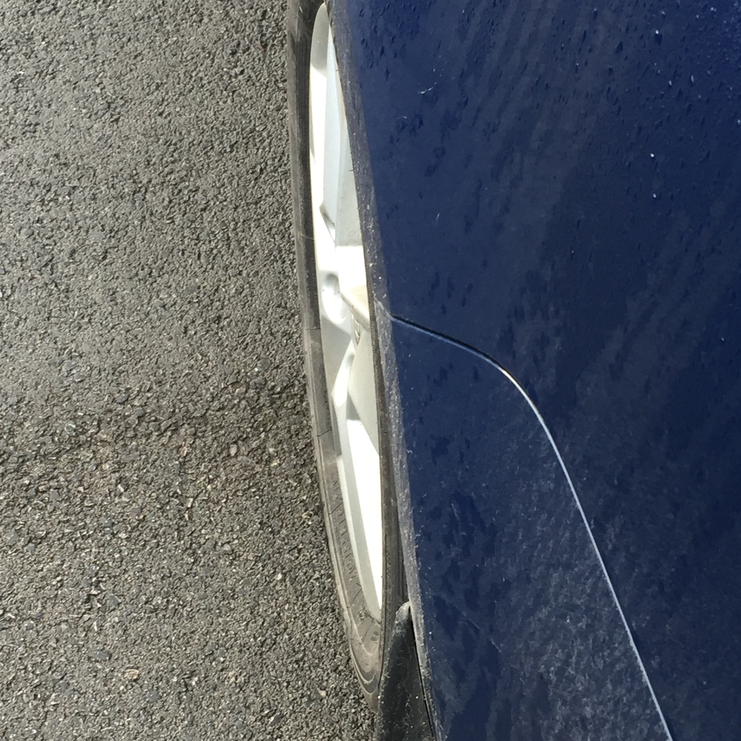

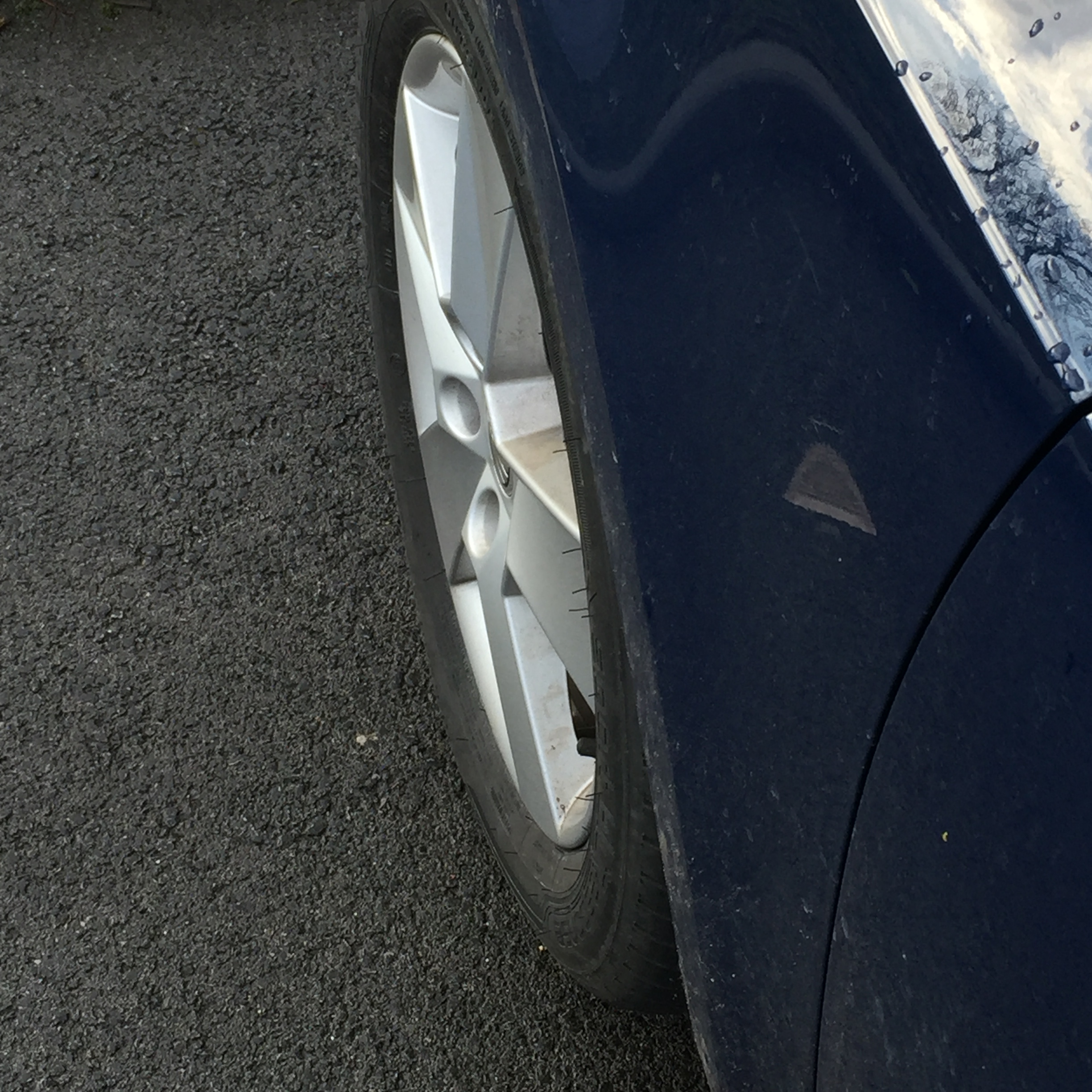

I’m following the manufacturer’s table for the tyre pressure (2.2 bar for both front and rear) but the tyres, visually, seem to be under-inflated. I attach some images for reference.

Yours  don't 'look' underinflated to me.
I have the same tyre sizes and I use the eco pressures of 2.5 bar in order to get better mpg (I hope).
The tyres at the eco pressure also look OK to me , but they are still a bit flat at the bottom . A consequence of having pneumatic tyres.
If you run at the manufacturers recommended pressures, the function rather than the 'look' is met.

Hi. Mine look the same and I check the pressure very often. The reason for their look is the width of your rim (the J number); as they are on the narrow side the same tyre will bulge more that on some wider rims (aftermarket ones are usually wider). If you go too wide (as per modified cars) it might actually push the tyre over its intended width and that would yield the opposite look.
