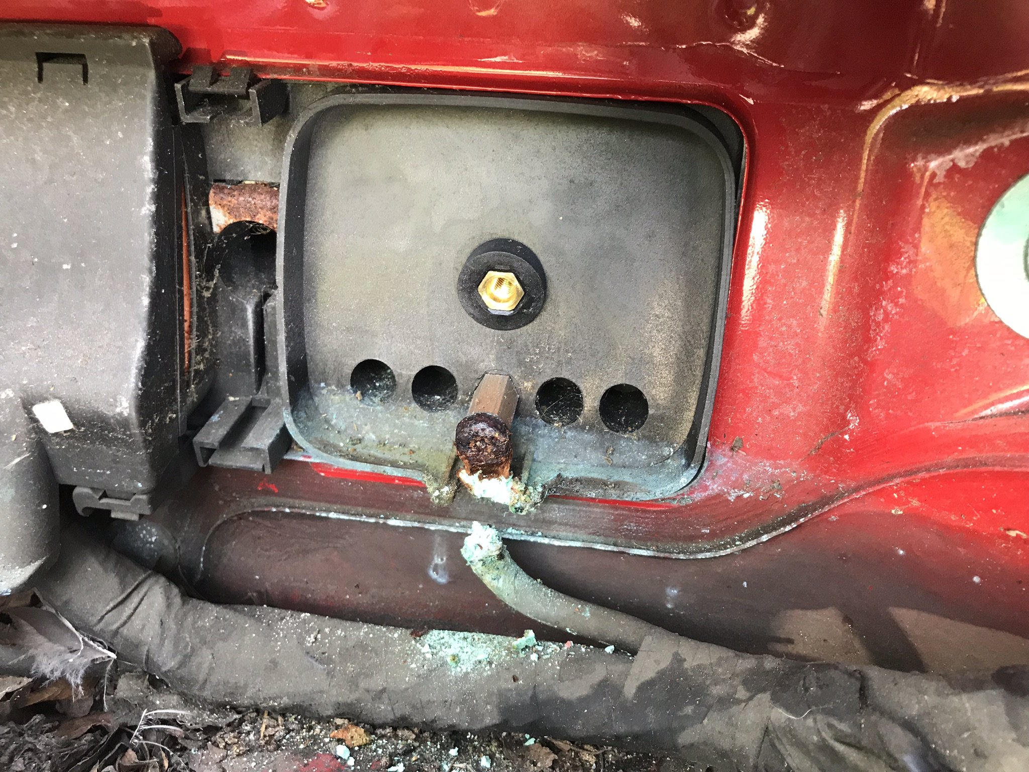

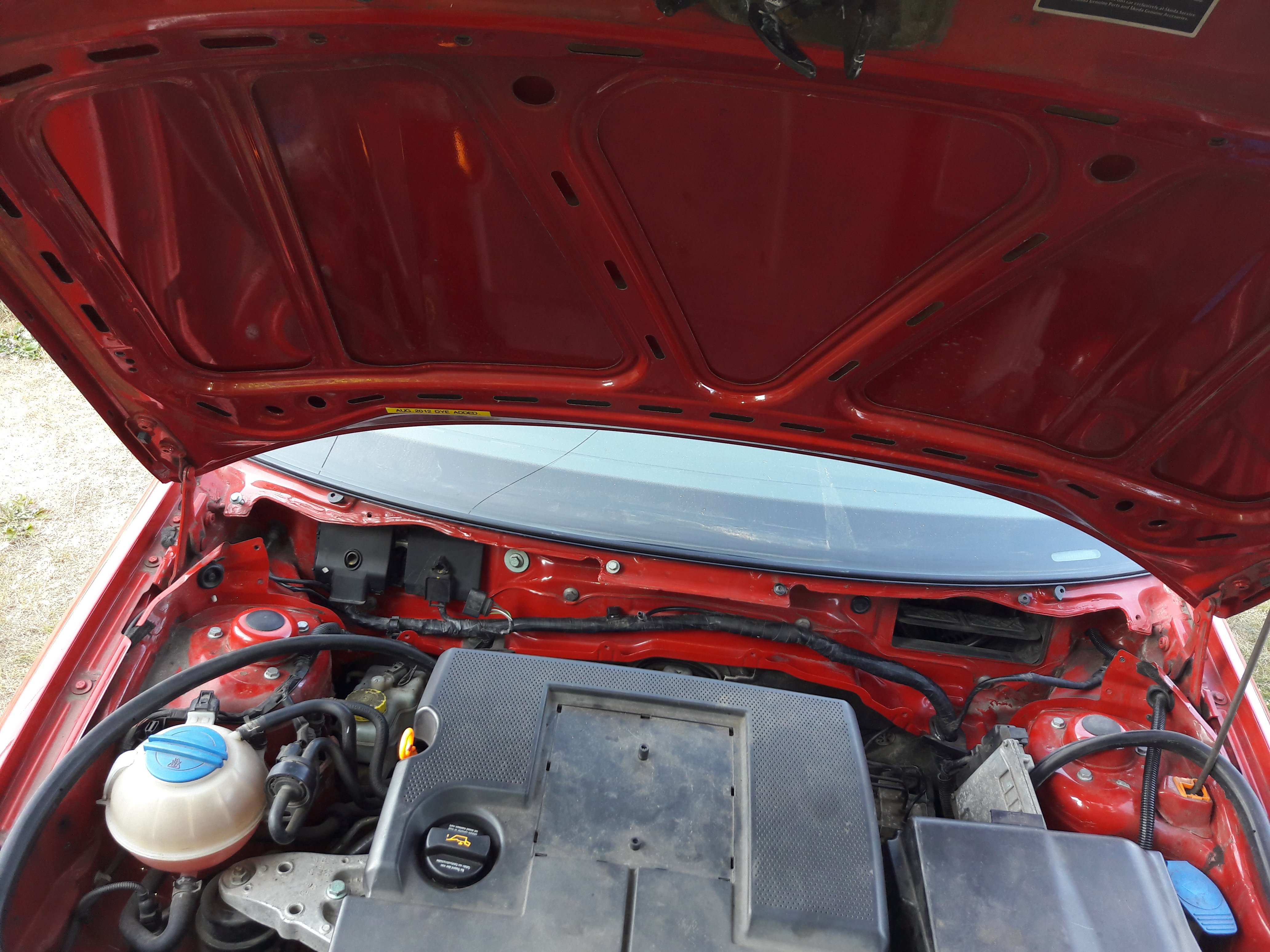

Got there in the end.  Main power lead to terminal 30 was corroded and snapped.  Location - in front of driver, under windscreen.  To access, remove wiper arms, plastic scuttle cover under windscreen, wiper mechanism, and black cover over terminal 30.
  • Sponsor
Blimey! Looks as if the scuttle drains have been badly blocked and that whole area has filled up with water. You can see the tide mark.

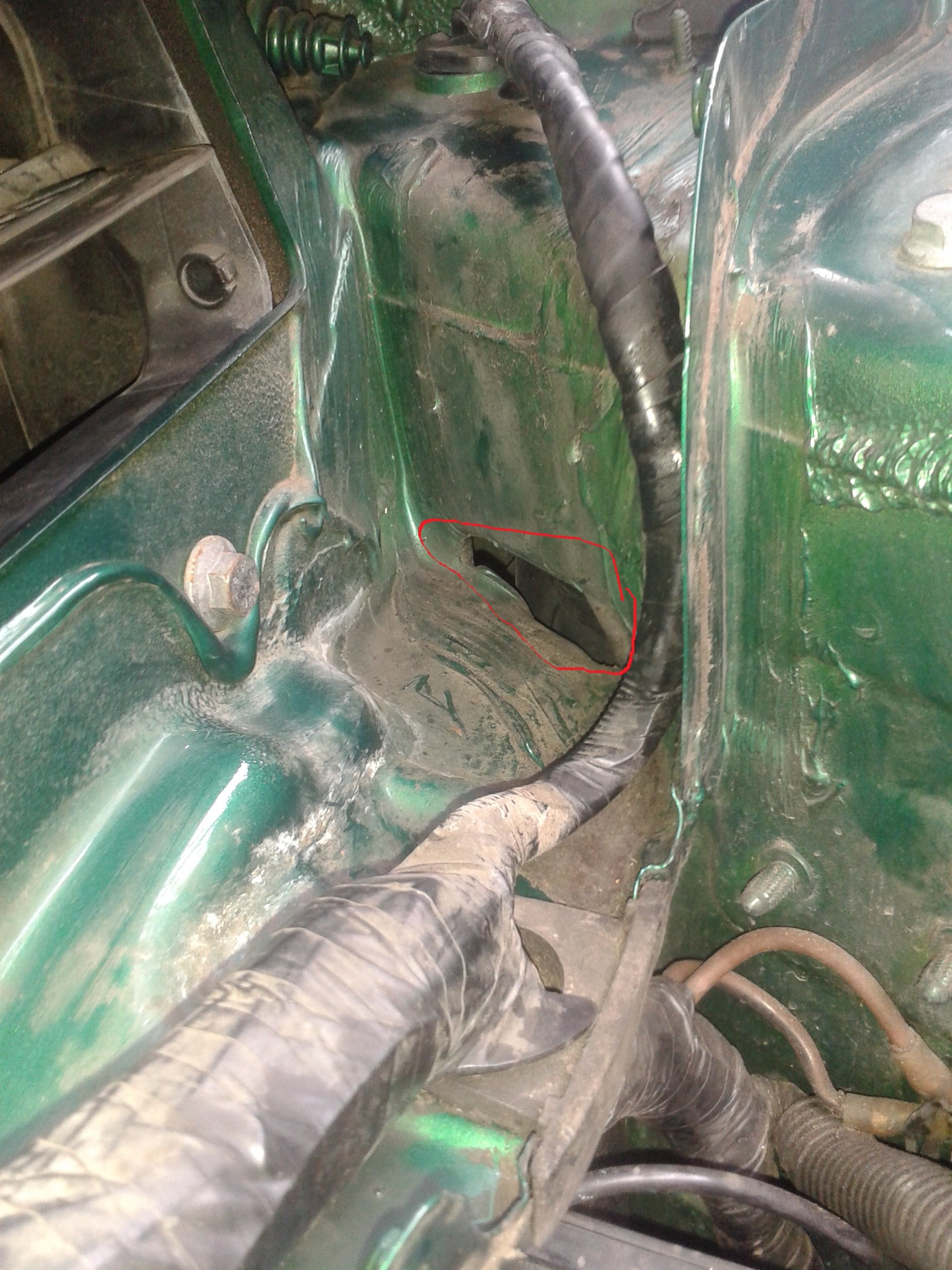

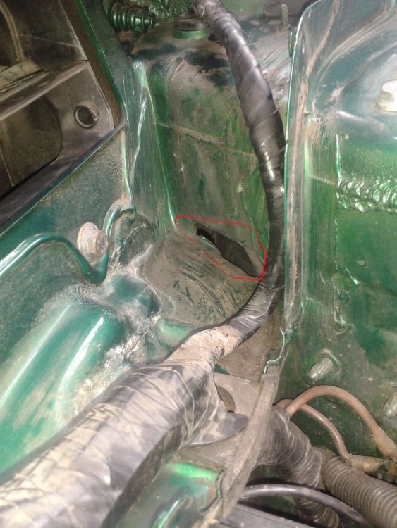

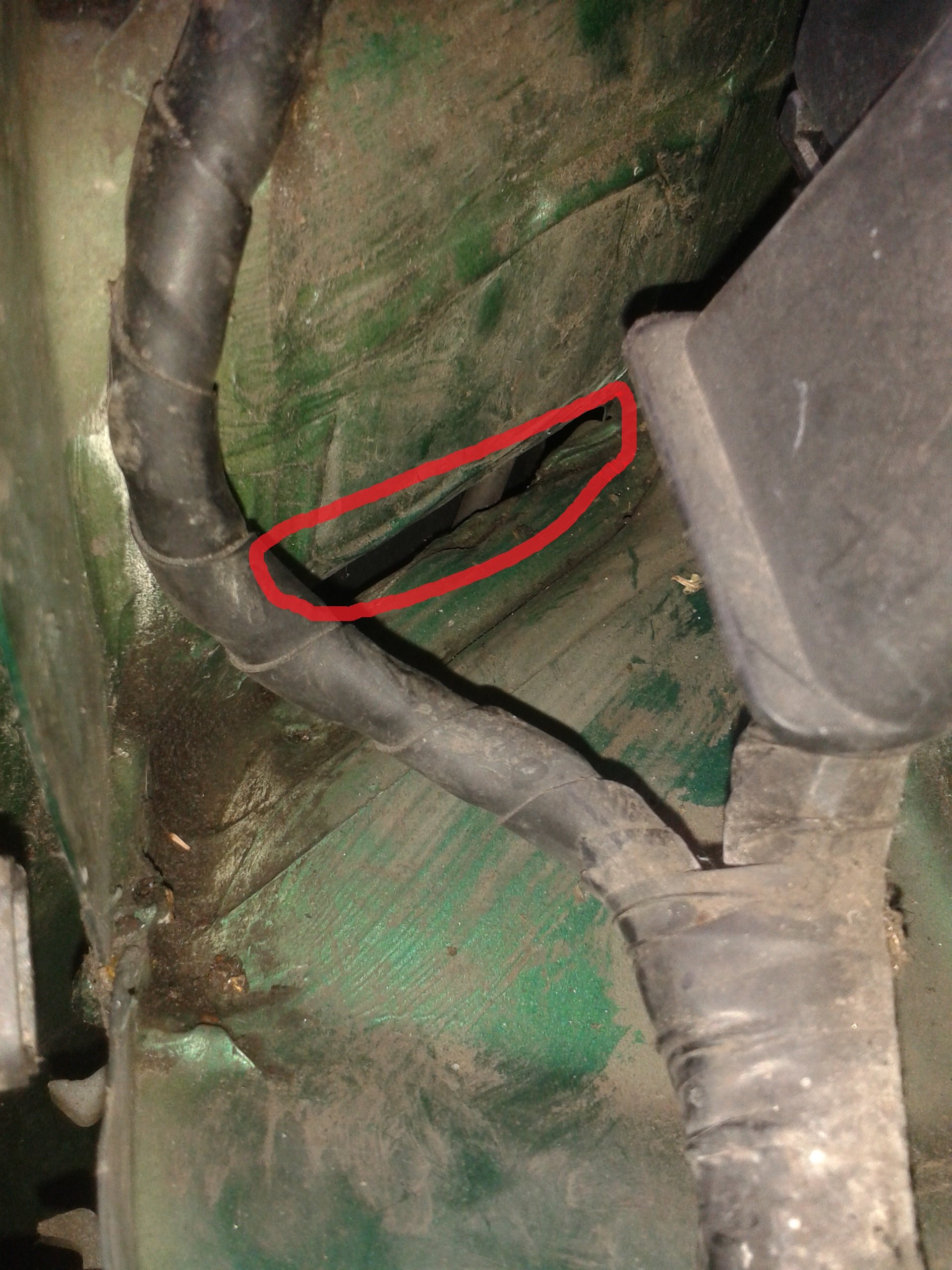

Big holes at the extreme ends. Here are some not very clear pictures of my Polo, which I should imagine is almost identical to the Fabia:

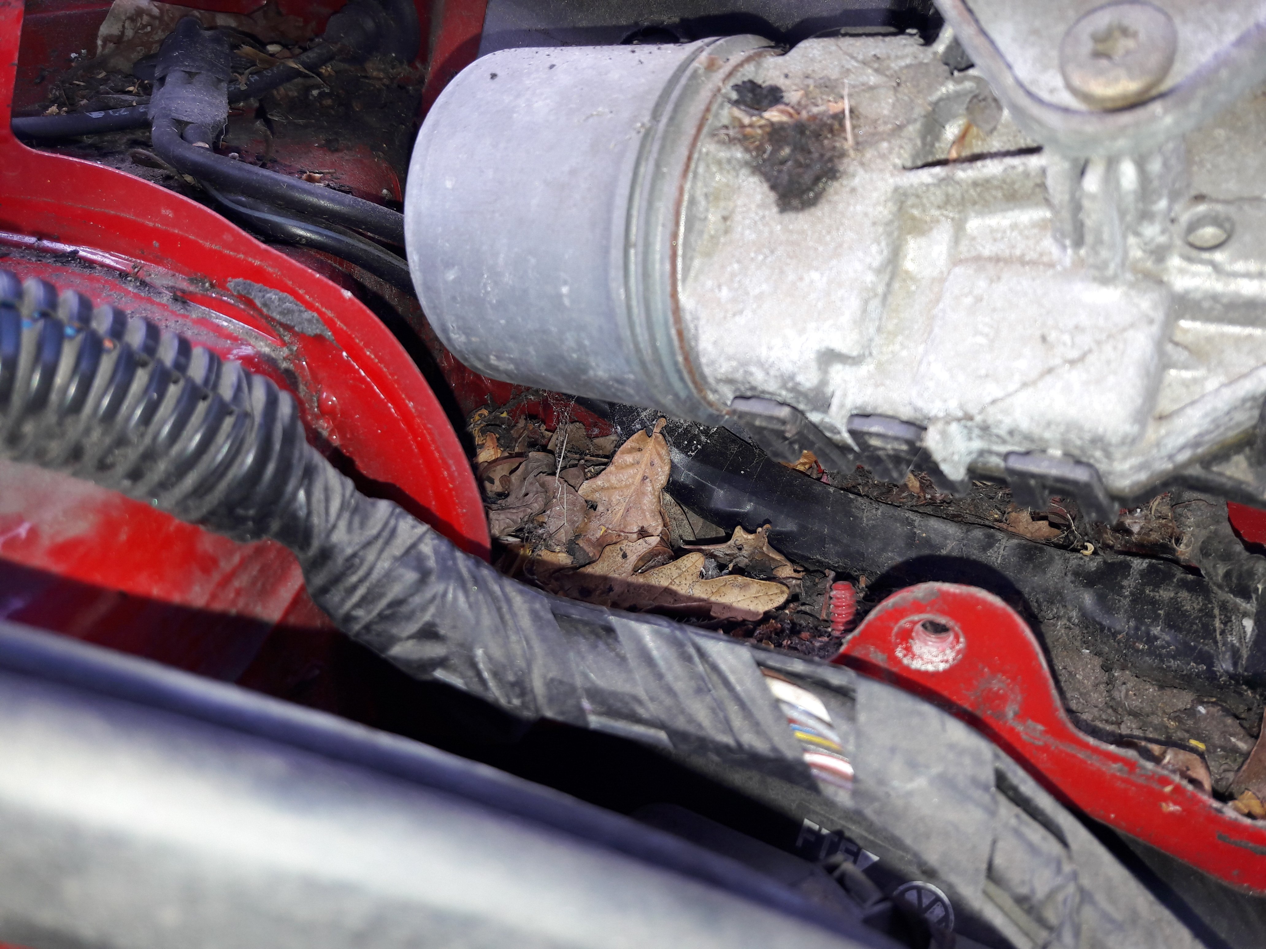

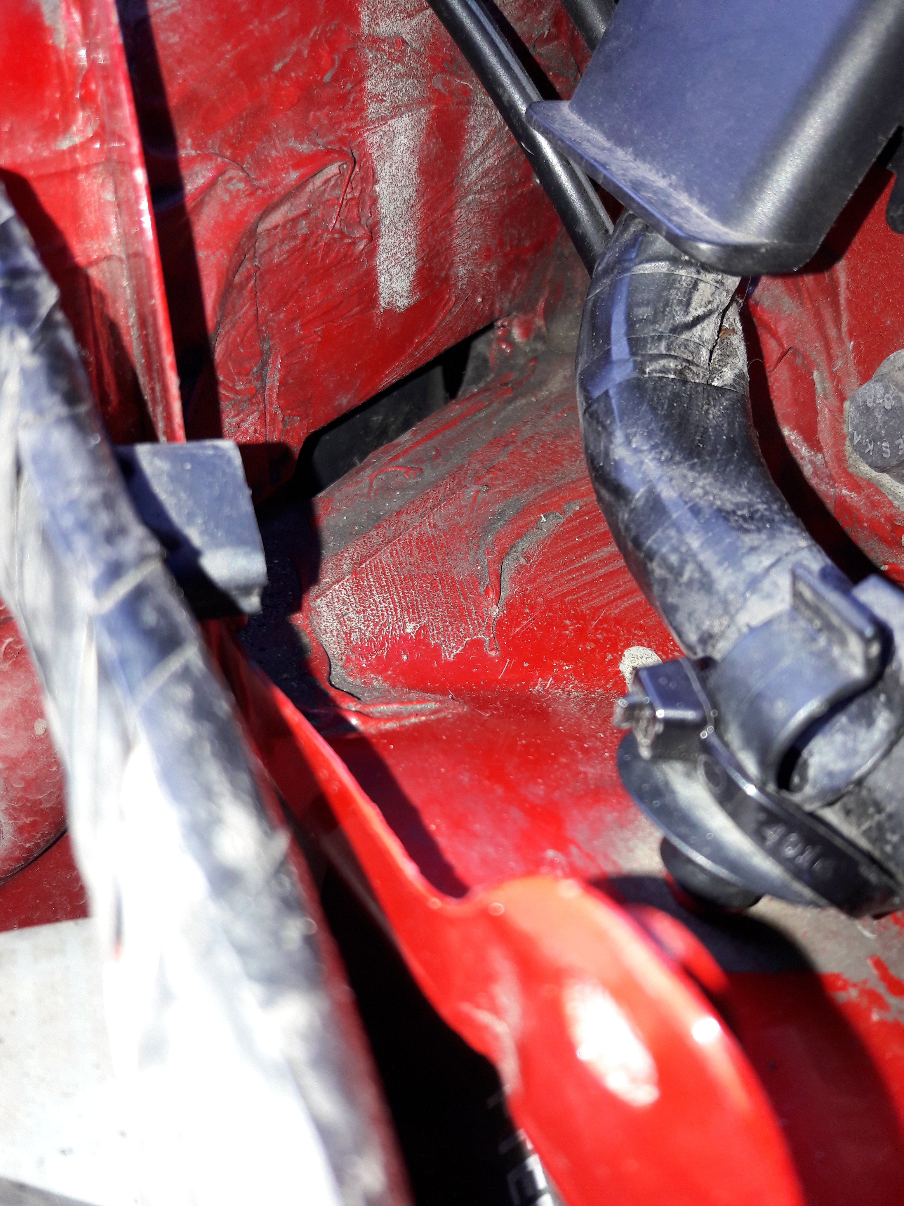

Don't worry about that, I took some of my own today, it does look very much the same as the Polo.  Had been meaning to clean out the scuttle on the missus's car for quite a while, and your story motivated me to get round to it. Learnt a few interesting things while I was at it, including 3 build faults on the car, and something I didn't know about the way the wiring connects through into the cabin, in the other box next to the one you opened to discover the 'corroded all to hell' terminal 30 wire connection.
If you haven't got round to checking the drains yet, I'd suggest that it may well be easier to go from the wheel arch area - by removing the arch liner and pulling stuff out of the hole that's revealed with something 'hookish' - though I haven't actually tried it that way. The one you should concentrate on is the driver's side one, it seems to be the more vulnerable to blockage, and surprisingly is pretty much independent of the other one.  There's a bit of a 'watershed'  high point in the middle and unless you park on a very steep side-slope, all the water going into the driver's side of the scuttle is going to exit at that end.
