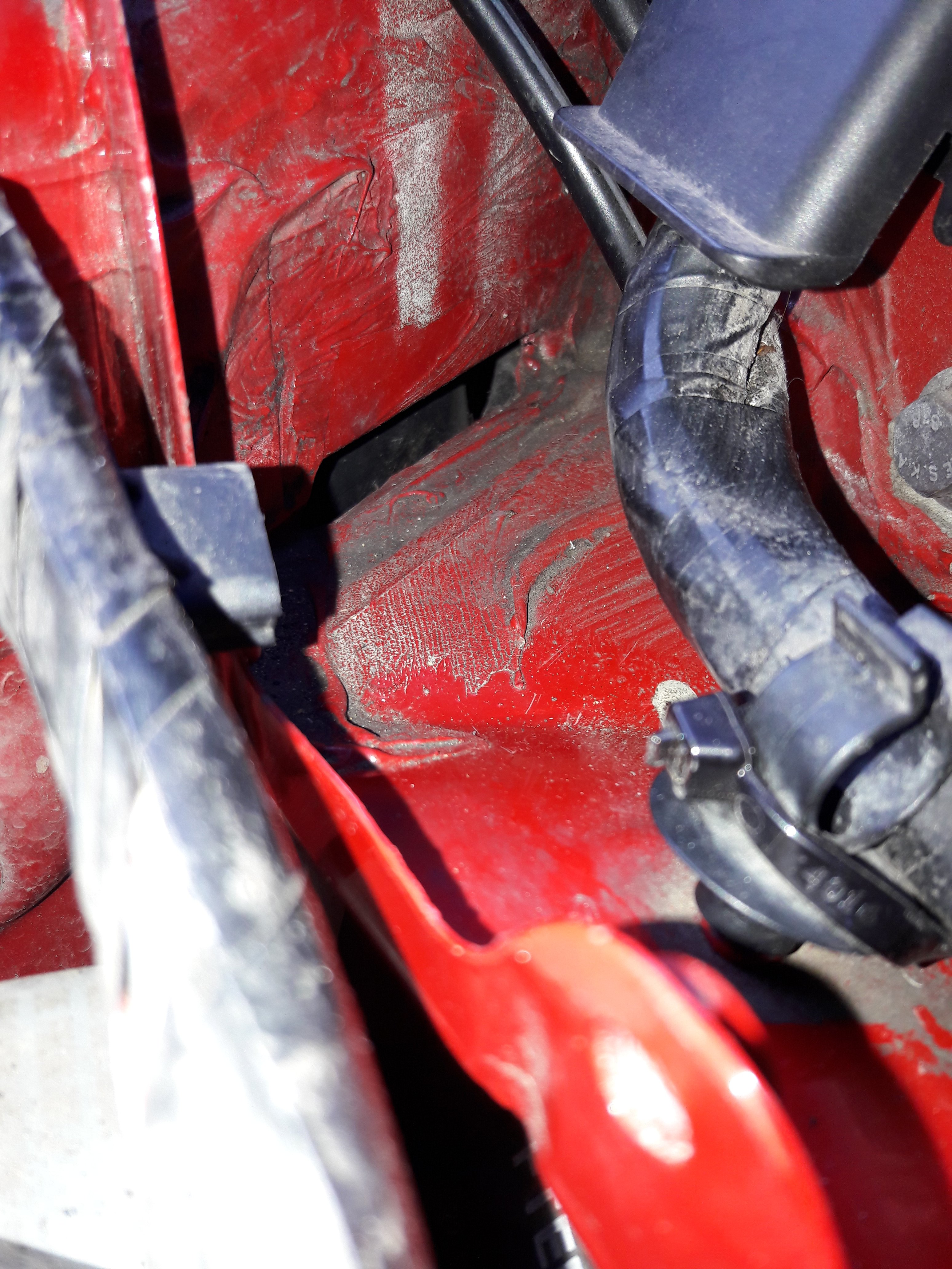

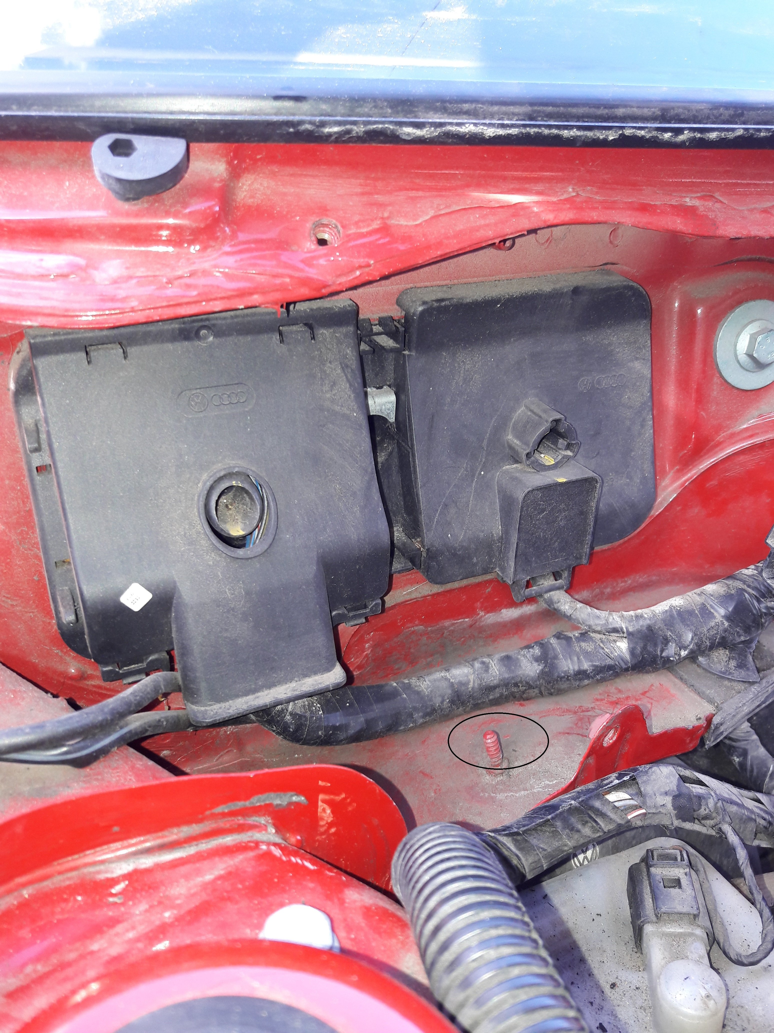

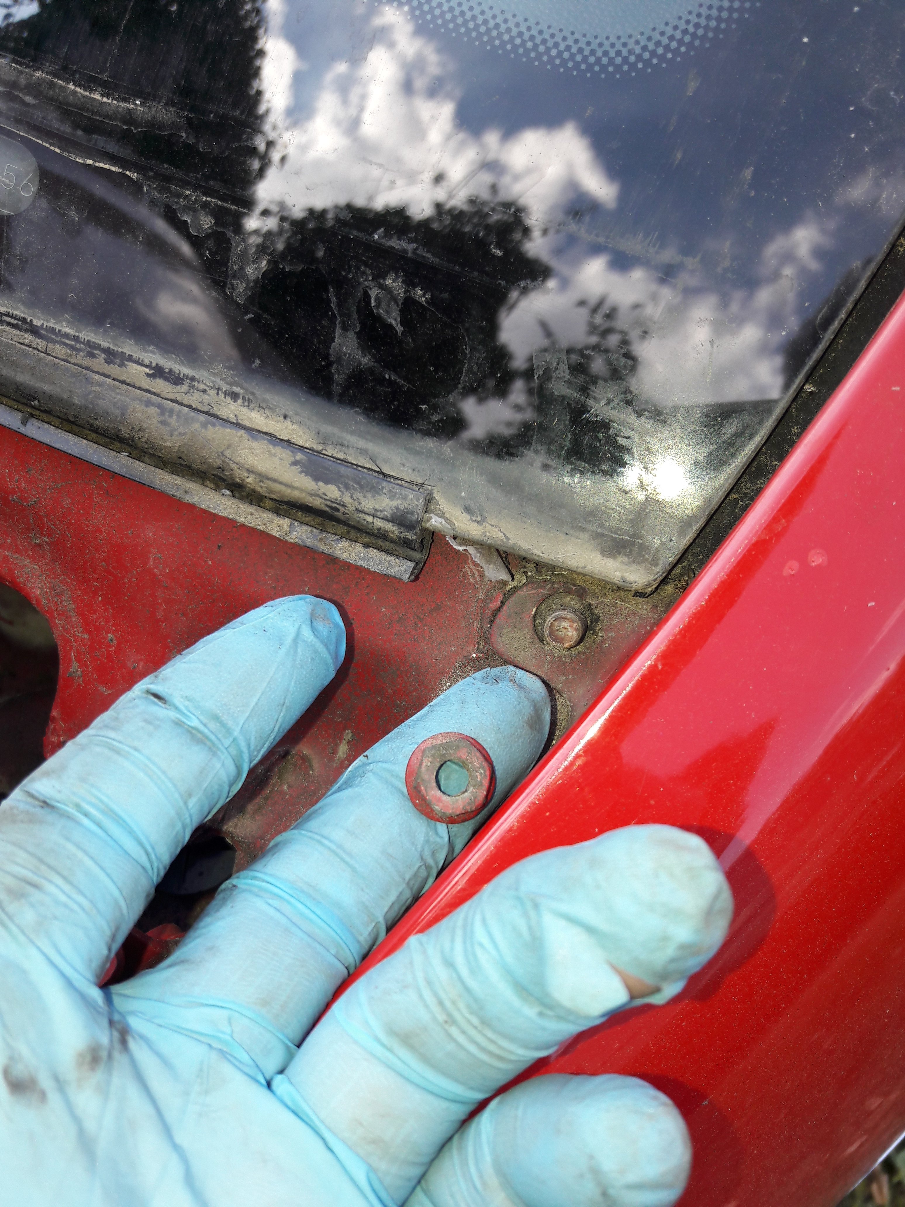

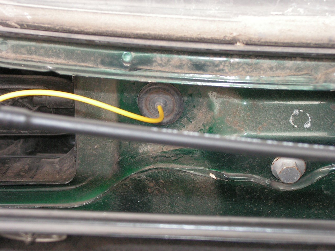

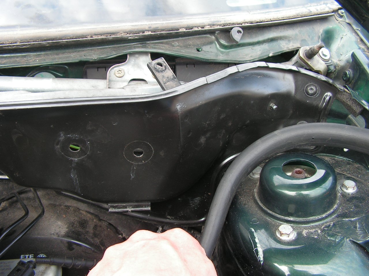

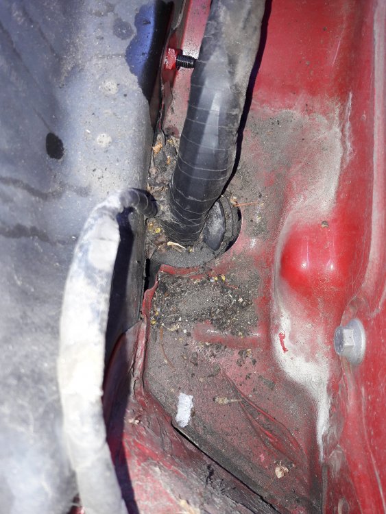

A loose nut in the waterbox, belonging to the top corner of the nearside wing (possibly hinting at a replaced wing at some point in the car's history).

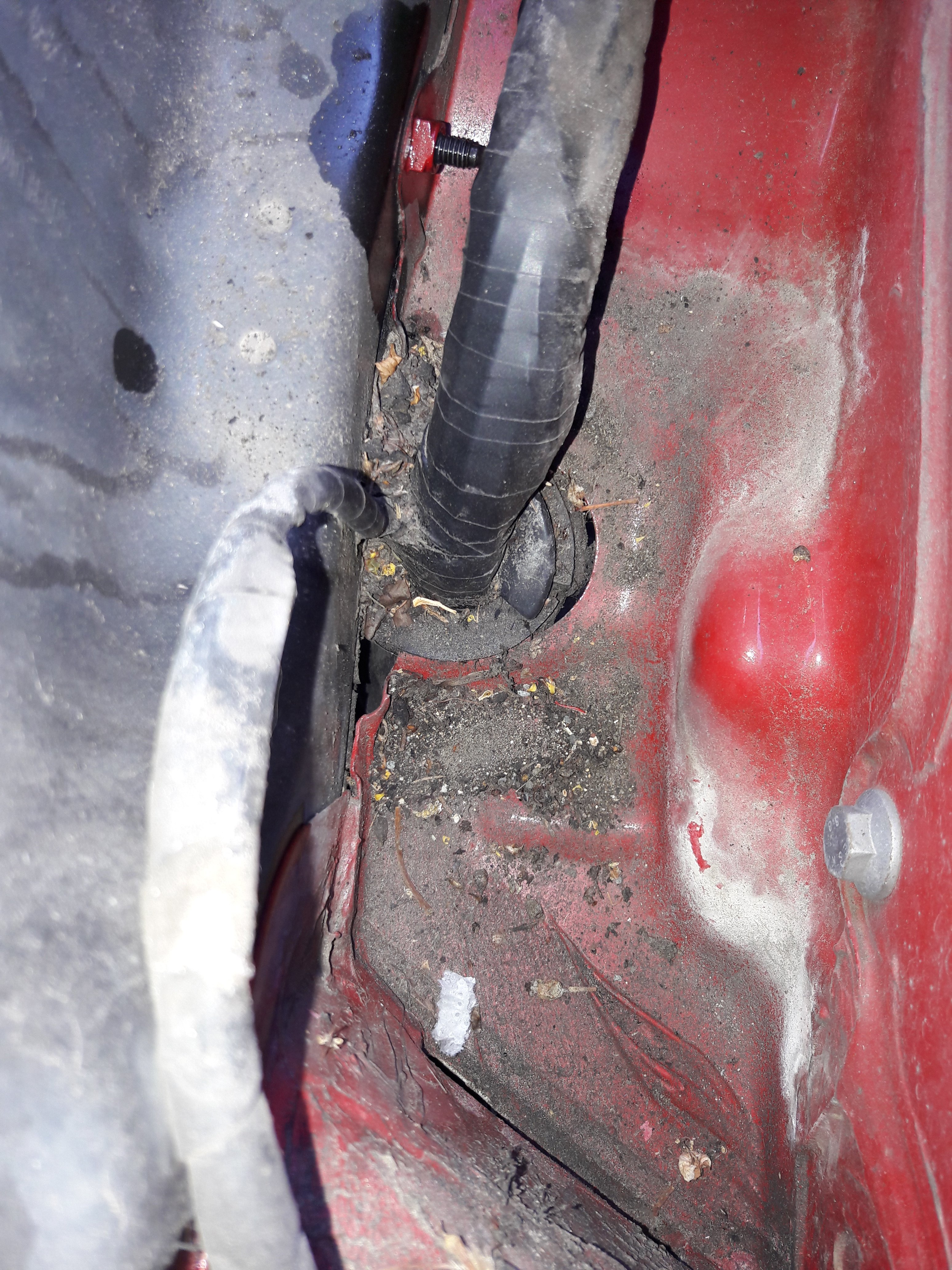

A mis-positioned (and so badly leaking) grommet where the main bunch of engine bay loom comes down near the ECU.
A missing loom support clip over by the connectors that take the wiring through into the cabin. This meant the loom was sitting on the floor of the waterbox, partly blocking the path for water heading out towards the offside drain hole (improvised a fix with an unused one off the front panel of the waterbox).

I see. Surprising what can be found when working on them sometimes.

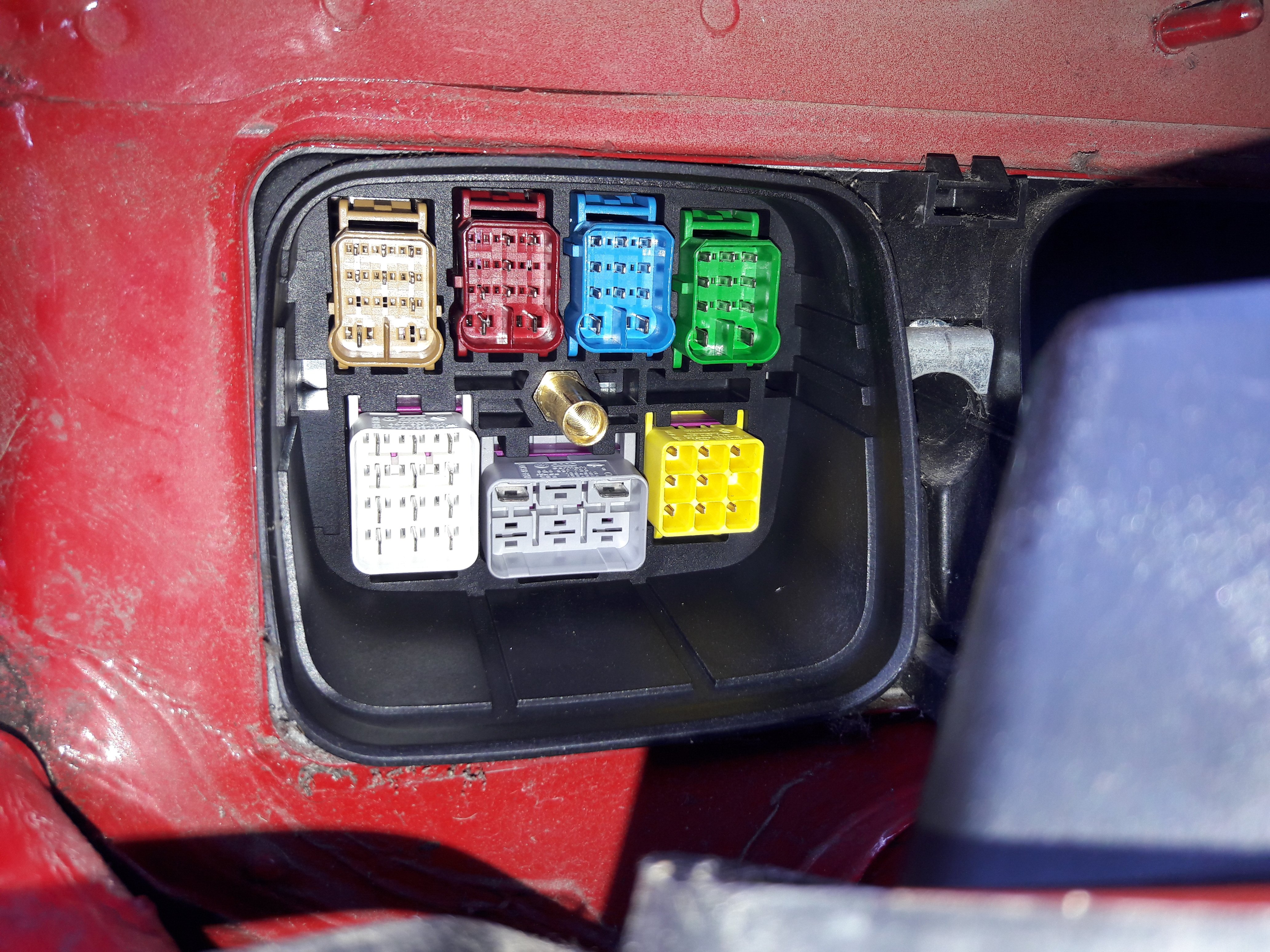

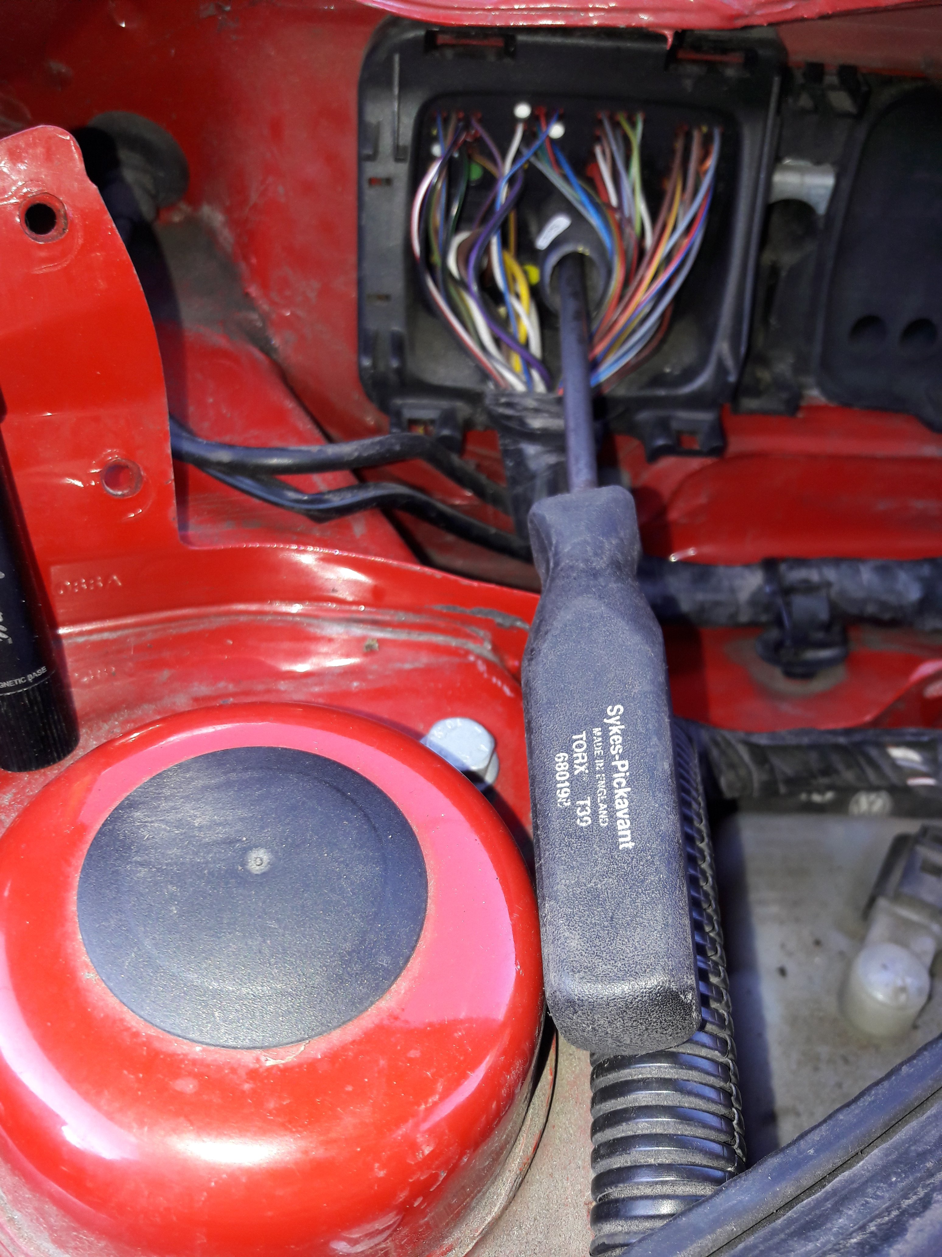

Just out of interest, did you take the terminal 30 cover off to have a look at the cable?
  • Sponsor
Yes Lee, A T30 torx bit takes the cover off that box, to reveal - in my case - a pristine, clean dry connection. Failed to photograph it though.

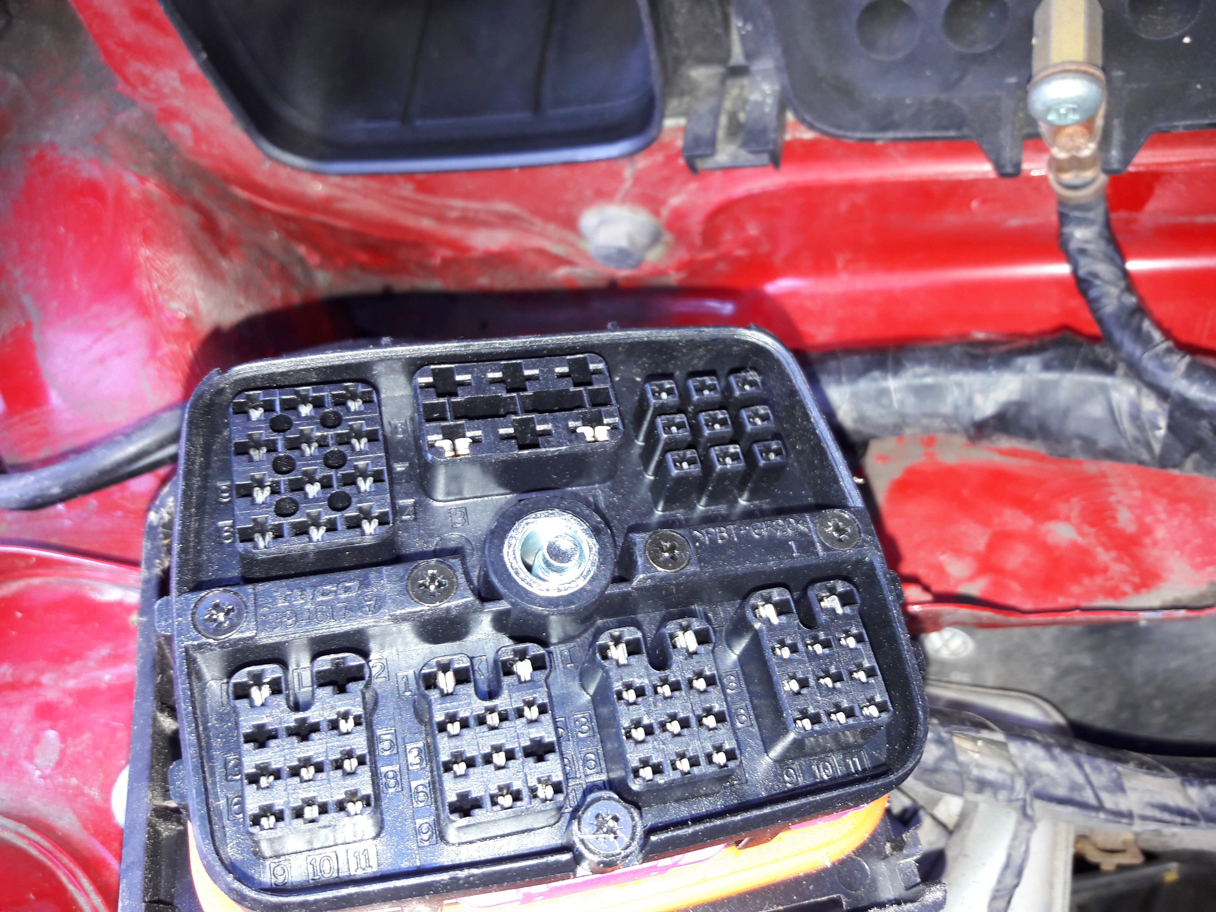

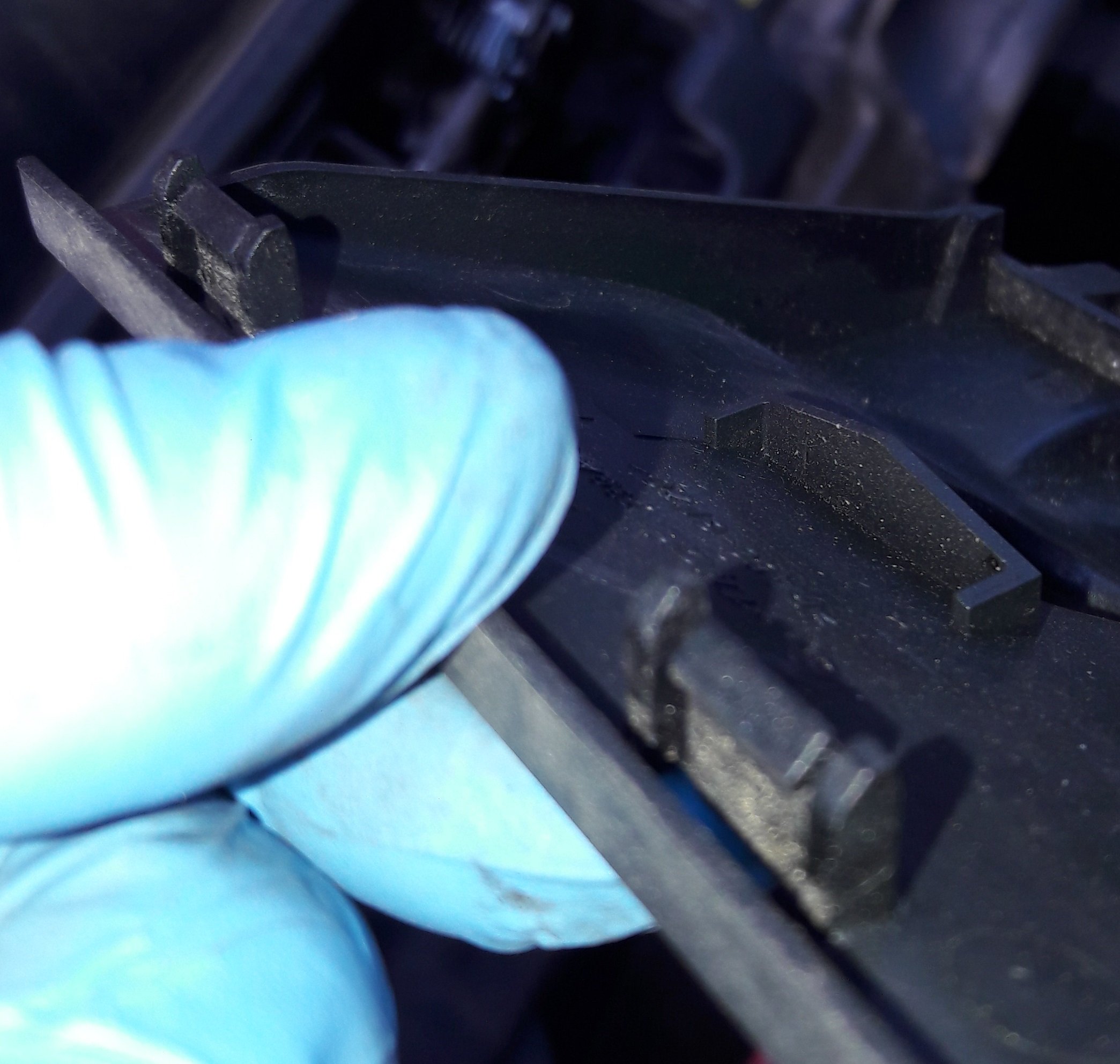

What was really interesting was when I took the cover off the other box, which involves a couple of 'ramp' clips at the top of the lid being released.
Was curious about the T30 torx screw up the middle of this connection box, so I had to undo it to see..
I didn't know that was how it worked!  Means you can potentially run new wires from the connector in the last photo as all those crimped socket inserts are removable. Can just make out the purple locking clips at the bottom of pic, there's another set on the opposite side.
Ah, I did photograph my terminal 30 connection, I've just noticed, on the right of the last pic.

Interesting stuff. All looks in good order anyway :)
Ah, of course, I see it :thumbup:

Yep, straightened up and sealed both grommets and the front edge of the waterbox with Plumber's Gold. Shouldn't leak anywhere except the (intended) drains now. :thumbup:

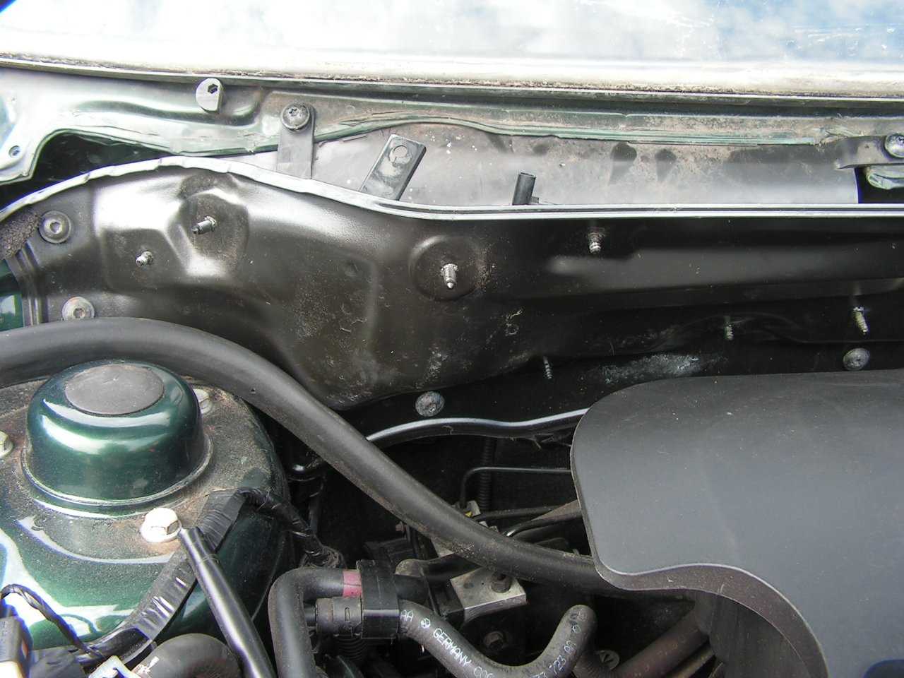

Also while airbox/engine cover was off I thought I'd have a quick glance at the air filter which was very clean, but also checked the function of the warm air blend flap, which had a failed thermostat, wonder how long she's been breathing nothing but hot air? (Never checked on this car despite finding this failure on my Polo.) :doh:

@TMBJust happy that I finally did check that. Bodged a fix with a screw that forces it into 'always cold'. Can't seem to disassemble this one like the 1.4/16v versions.

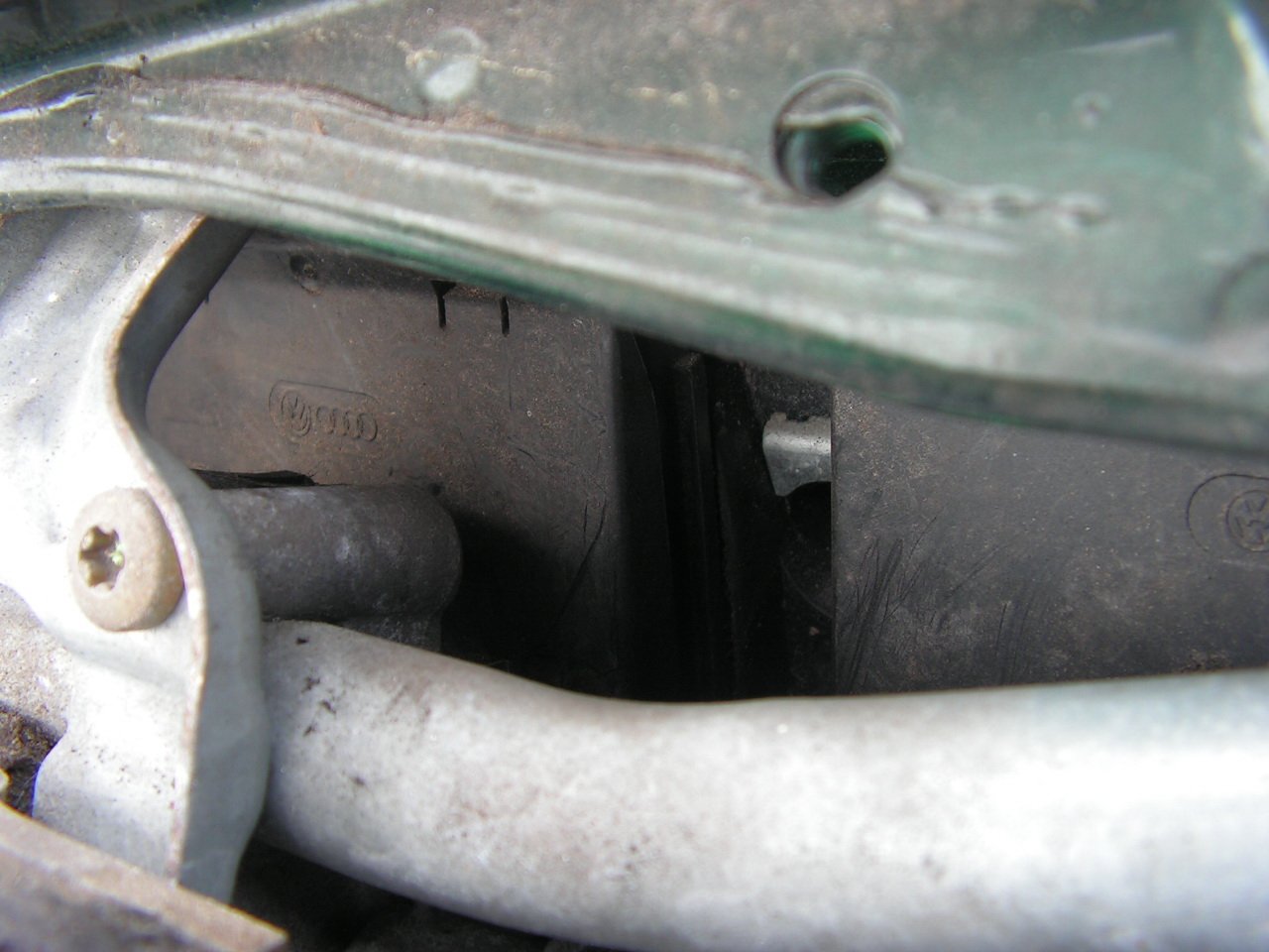

Just reading and looking through this topic, I noticed that for your RHD cars the interior recirculation valve is on the opposite side of my former LHD Fabia MkI. It seems that the recirculation valve and the terminal 30 connection are switched.
If you want to check the drains for the parafan/waterbox, you can also pour water in the waterbox and check if there a real stream of water in the frontwheel bay, and the short hose is easy to find this way. If the water is just dripping, you can pinch in the hose above the front tyre, just to get the dirt out of it. This is very easy, and this way you don't have to open the parafan/waterbox.
