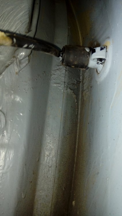

Indicator bulb change front wing
Whilst looking for damage to front spring I removed wheel arch.

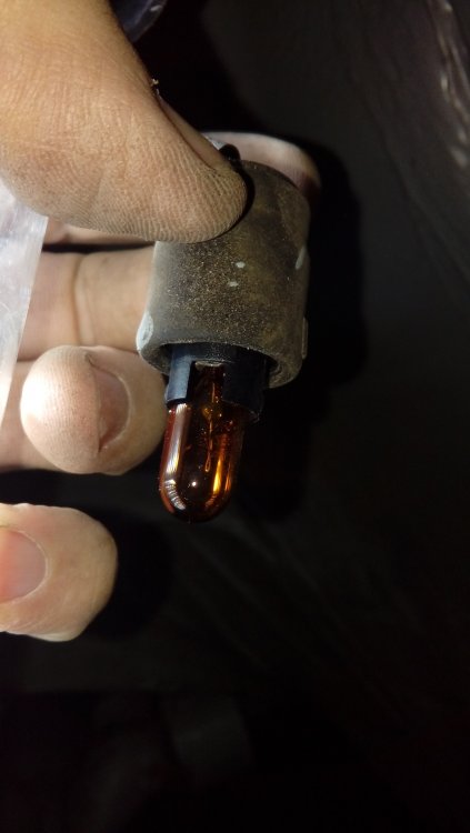

The bulb can be accessed from inside wheel arch. Just pulls out retainer to reveal bulb. Use torx to remove lots of screws to allow removal of wheel arch liner.20180313_210747.thumb.jpg.700ef431eea5b41fcb5fdd3dc48a5b52.jpg

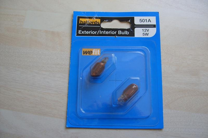

Do you possibly know what bulb it was? 5w5? Or other?
Thanks!
3 hours ago, Tomcio2279 said:
Hey thanks for this! Helped out a lot!
Thanks!
Got a pack right in front of me....
You can just pop the light out with a plastic trim tool and swap the bulb.
