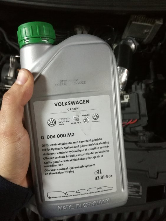

Hello guys, my steering has been noisy so I took battery and tray off to check the level and indeed the "dip stick" comes out dry so I need to top it off, a mechanic gave me about 400mml of vags fluid (G 004 000 M2), should I take as much as I can with a syringe and top off after so I have more "clean" fluid, or is there no point and should just top it off?

"pink"?  Are you sure that you don't mean green?
Should be green, and by reading some threads some people have had to just top it off, car has 7 years now.
