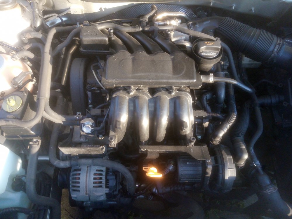

Hey guys me again, I already told you about having engine parts replaced etc I also replaced water regulator and sensor for cabin temperature to show me the right temp in any time... What happens is that as it warms up and as I drive it gets really hot, plastic that protects the engine, air intake, electronic air generator.. everything.. few days ago I have found some oil in air line from air filter to the intake system, so I guess that's the reason for overheated intake, not sure... It also leaves white cream on the oil cap... I didn't see fans working and the pipe from radiator to the engine is hot almost as the engine to radiator is.... That's perspective from engine bay... Now cabin, in cabin it's all good .. it shows 90 degrees C,  working temp which is great, but I noticed that I had my air conditioning turned off but I was still getting heat, like I lightly left it on.... As I rev high it gives me slithe burning smell as something is burning but lightly ... Any ideas how to fix or what to look for ? Engine is 1.6 petrol bfq 96-04 and 75kw

yeah the thing is i dont lose coolant at all, i just get the really hot oil spilled out to my intake hose to be sucked into throttle body, but it messed up my air sensor so i cleaned all that ... the thing about the situation is that engine head is really hot, everything is hot while its running for a while even air filter box and platic cover for the engine .... it wasnt like that until now .... but as i said ... the mechanic told me that they did all new gaskets on the engine, head gasket, oil pan gasket, crankshaft gaskets, since it wasnt lubricated as i had an accident the engine was stuck at the crankshaft and they had to replace all gaskets and trim the engine block and align everything so it can spin again.... they told me that there is nothing special about the head gasket and that its nothing special about mounting that it just clamps and sticks together with the engine block and engine head .... but i still get white cream under oil cap and it runs really hot even tho we changed the thermostat so my guess is eather i have blown my head gasket was set or i have blown the head of the engine or something since there is no leaks visible, but it runs hot .... when i sniffed the oil cap i wasnt sure if its only oil or oil and gas mixed, is that even possible to be ? should i try engine compression test or ?

Anyway, we have got waay off topic... Is there anything i can do now to fix the slithe overheating issue or not ? Btw when i open the engine bay i smell engine oil even tho i didnt see leakage anywhere i could send you some pics if needed
The oil smell is most likely a bi product of the stuck rings, and is probably also causing you the oil in the intake issue as the crankcase pressurises with blowby past the stuck rings. Whilst this will cause rough running, smells and possibly excess oil use, it should not have a direct bearing on the overheating, unless you are weakening the fuel mix down so far with the oil fumes, that the engine management cannot compensate. Without seeing the car physically, that is a difficult one to diagnose at a distance. Have they checked that your cooling fans are actually cutting in?.
