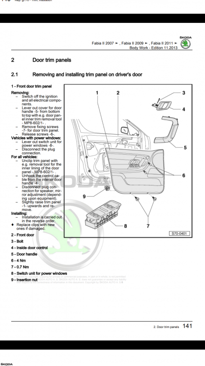

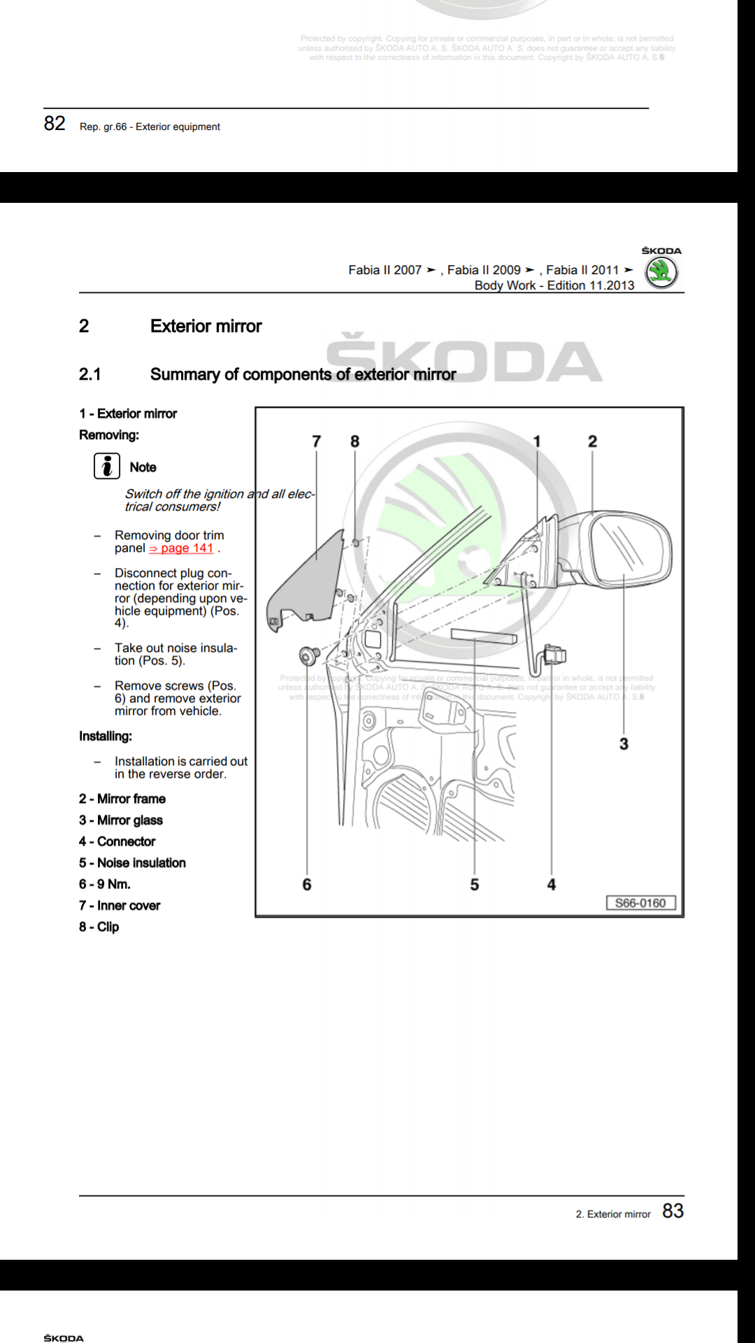

I need to change a door mirror (manual control, not heated) on my Fabia 2, and have the part on order, but just after any links/help that is avaialble for this.
I am assuming that the door card will need to be completely removed here, so looking for any help with this or the changing of the mirror.
I have removed the door cards on my Fabia 1 (yes, the back doors, with a tube of bathroom sealant at hand to stop all the leaks!) so do know it can be the odd trim clip that you did not expect that can trip you up here.
I'm not sure I'm allowed to post the manual images on here so I may have to delete them if asked. Hope you get the job done.
Bezzer88,
Many thanks for that - just what I was looking for.
