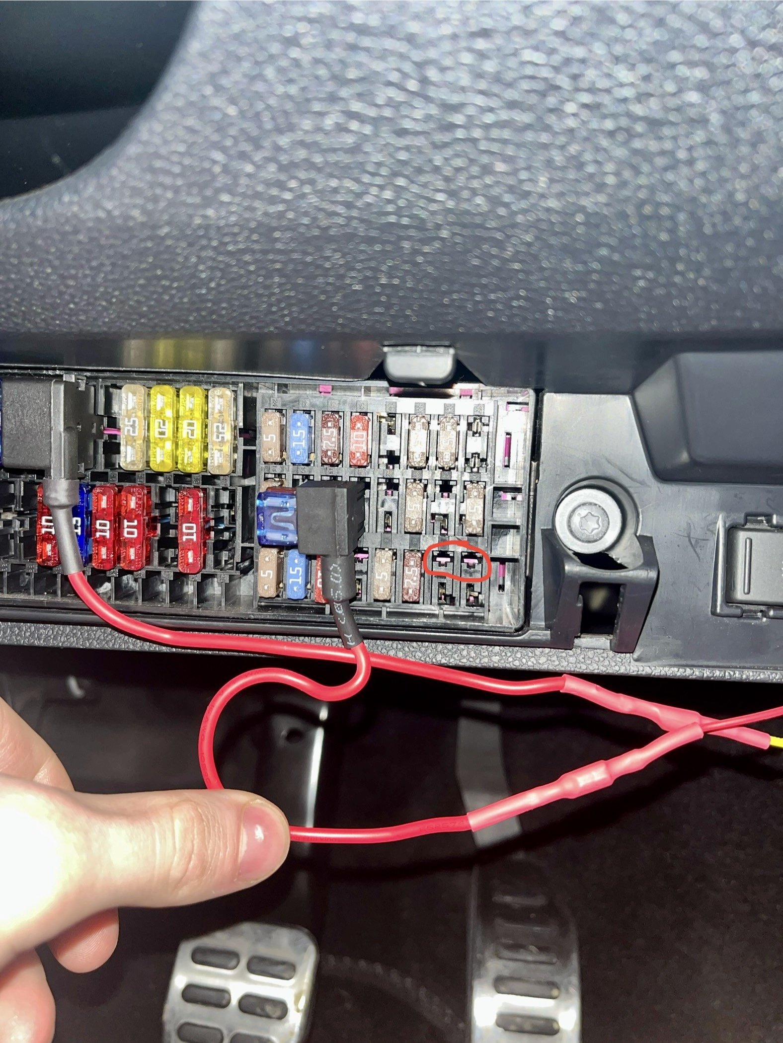

In the fusebox the drls and the heated mirror fuses both only have 1 leg. There is drls in the car (next to the fog lights). Whenever the switch for them is on they dont work. Looked at the fusebox and the fuses 17(drls) and 18(heated mirrors) have only one leg wired. Is it possible to wire this up so these work?
Here I have attached a photo. Circled is the top leg of the fuses for the drls and heated mirrors and as you can see there is no connector. (the red wire is just a dashcam that is wired into the cigarette lighter. You can ignore it)
I don't think they're wired at all, if you look at the empty fuseholder at the top of the last column, it's fully wired with a pair of contacts so a fuse will bridge those contacts, the two you've circled don't have any contacts at all.
The bulbs are there and there is wire coming from them. Is it normal for them to install the bulbs but not wire them? Seems odd to me.... If they aren't wired would it be possible to have them wired?

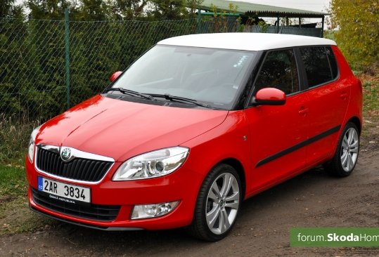

Are your lights like these?
12 minutes ago, Ootohere said:
@zachvaughan123456  Welcome to the forum.
Yes they are the same, here is a picture.
Fog lights?
