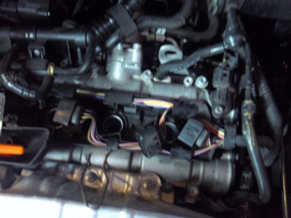

How do I do it? Haven't been able to find anything online and it isn't jumping out at me with the bonnet lifted. I noticed a couple of little metal clips in the harness that seem to be holding it in, but lifting that out would just remove all 4 coils at once and thats not useful for what I need.

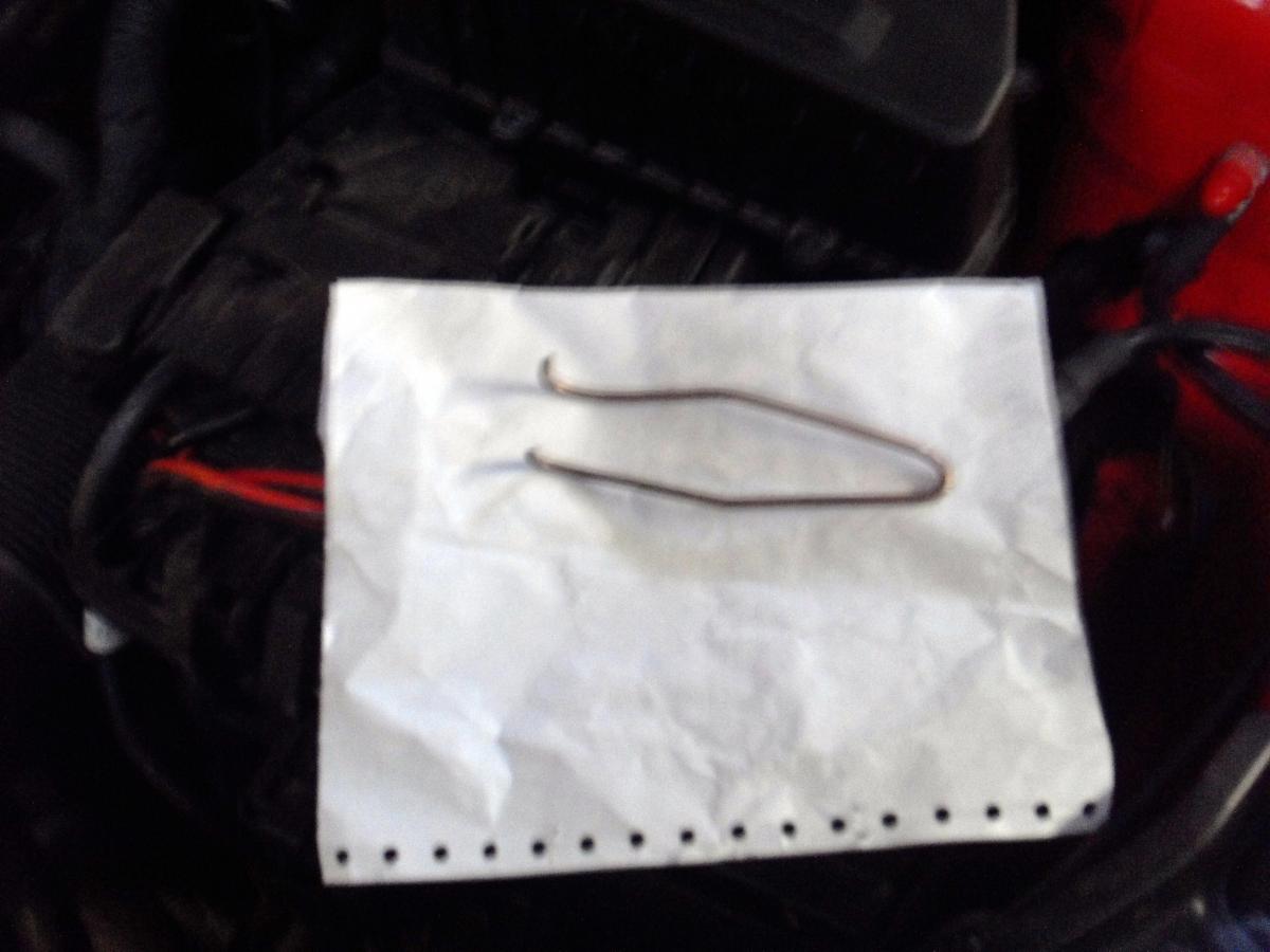

Use an Ignition Coil Removal tool.
You can make one, or use long / strong zip ties, but then you need to know how to.
There are 4 separate coils, un-clip each from the wires first,
there are threads with pictures....     Take care what you are doing.

Tool suppliers sell Ignition Coil Removers.
They are in Kits for different models, but the VW ones are common.
Don't give the Zip ties a try.   Too easy to get wrong. Make a hash of it.
