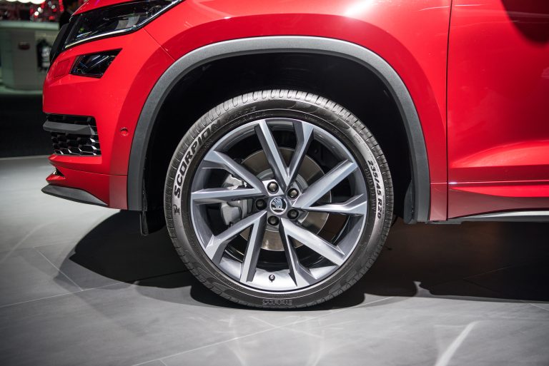

20" SportLine (Vega)...

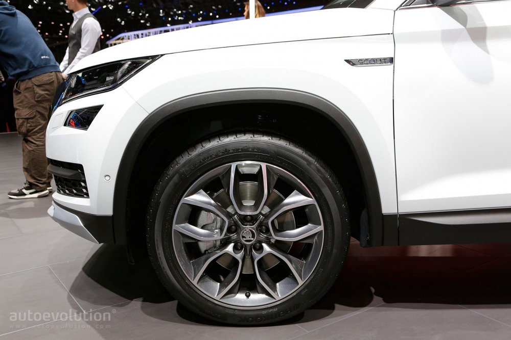

19" SE L / Edition (Sirius)...
2017-skoda-kodiaq-price-set-from-21495-677900-k_3.thumb.jpg.69868f5ba8c08e2b92aecfa6b04cfa7f.jpg

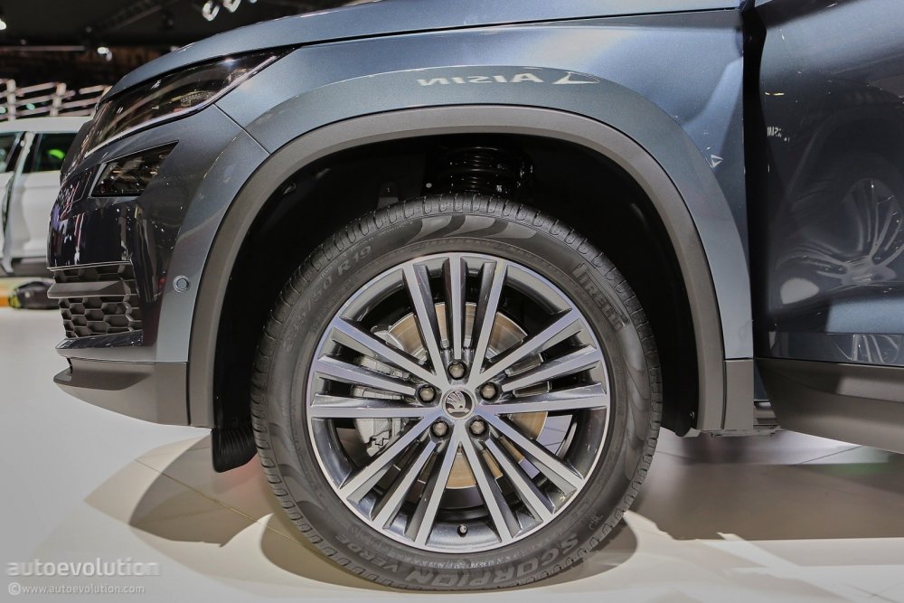

19" Scout (Crater)...
skoda-kodiaq-sportline-and-scout-show-show-carbon-and-wood-interiors-in-geneva_9.thumb.jpg.00d273081d47c2734b98381e516b580b.jpg

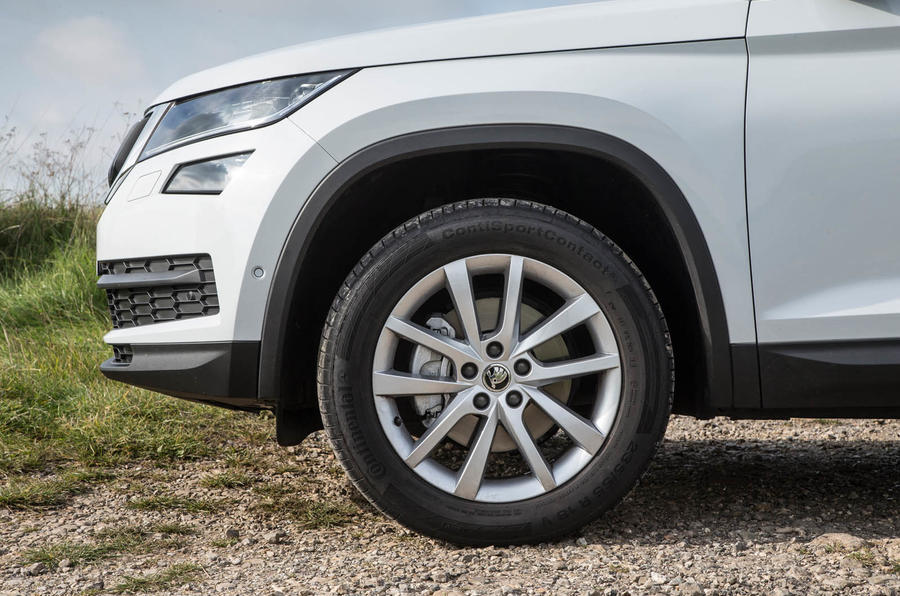

18" S / SE (Elbrus)...

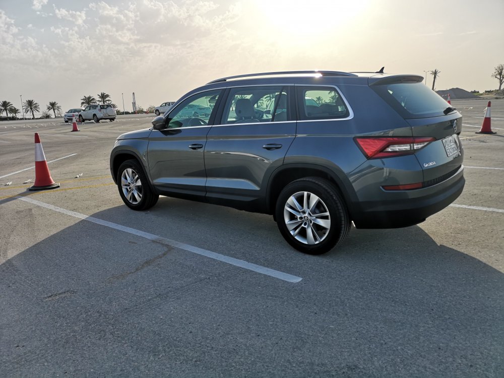

For what its worth the tyres fitted to my Skoda Superb pictured above are non-standard and non-approved.
