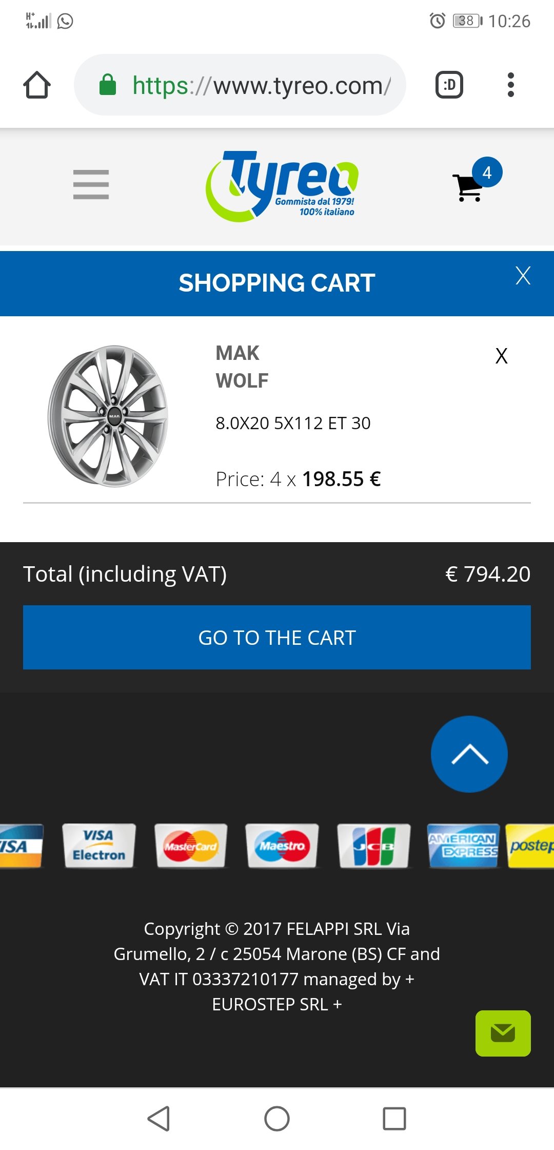

I decided to buy a wheels from MAKwheels.com
That offset ET30 will give more clearance on the inside and in my opinion look better I’m not sure of the width on the original 20” wheels but I’d go for the 245 50 won’t be far off

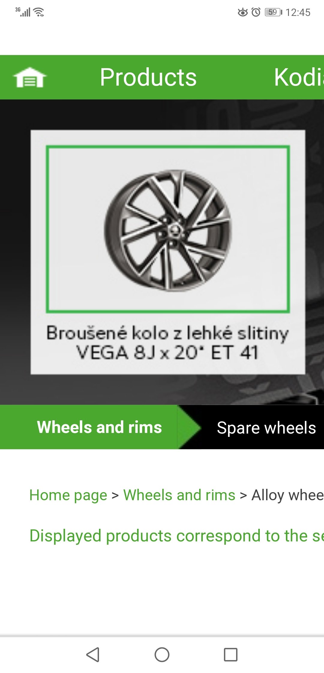

This is the recommended one from  Skoda
