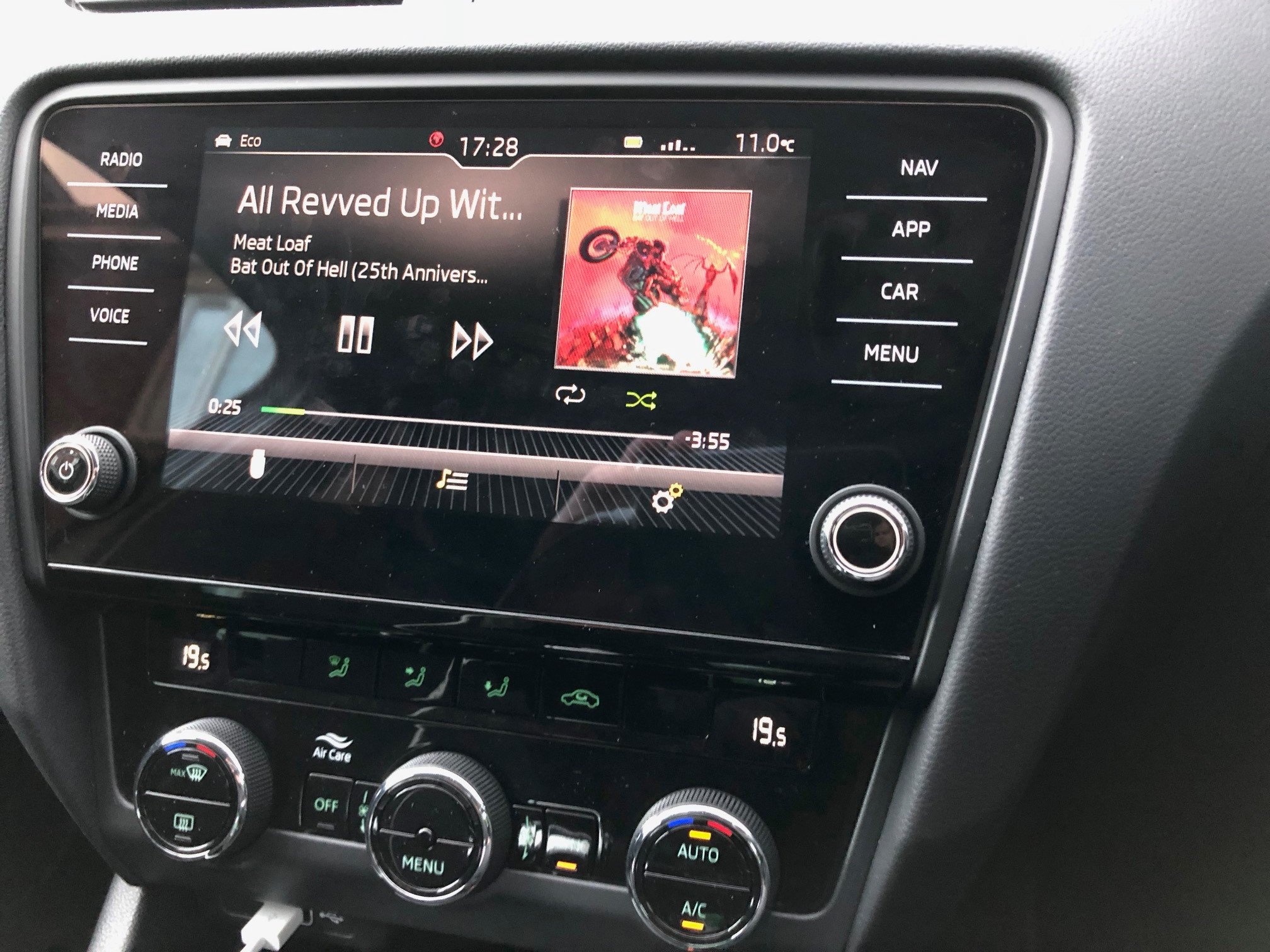

My mistake in the original post, it does support voice control using Siri if you say 'Hey Siri' in Apple Carplay.(which has nothing really to do with the in-built voice controls of the car). It however doesn't seem to support voice control In the native USB media screen however (which is much prettier, better, and also shows the track playing in the MaxiDot display. Here is an image of the iPhone playing through the native USB media player.

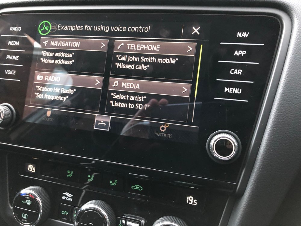

And here is an image of the voice control screen when you press the voice button.
As you can see in the bottom right hand corner, There is an example on using media. "Select Artist" is in fact a demonstrated example of how to use it. When I try to use this for selecting songs over USB, I get the 'unsupported source' message. I also get it when connected via Bluetooth, which can be expected. So my argument is; what source is actually supported to use the built in media voice controls? As I previously mentioned, I have not tried SD. (I don't normally use SD at all so ill be surprised If I have one.) The fact that the example on the screen is "Listen to SD 1", maybe this is a hint towards the fact that SD is the only supported source for media voice controls. I would be very surprised if that is the case.

Yes works on sd for me
Yes that’s how mine is, Siri on CarPlay is separate, but I don’t get USB or BT voice control so I guess it’s not something it can do.
Thanks guys; looks like I’ll be investing in an SD card :)

Yes I knew that. The issue was concerning the built in voice command utility and its supported sources for music. I think we have determined it is only supported with SD cards.
i know using Siri works but I much prefer the cleaner interface of the native media player shown in my image above. I can imagine a lot of people feel the same.
Although the Apple CarPlay interface is functional, I think it is just plain ugly, and  I like how the native media player shows your track information in the MaxiDot display, which CarPlay does not.
