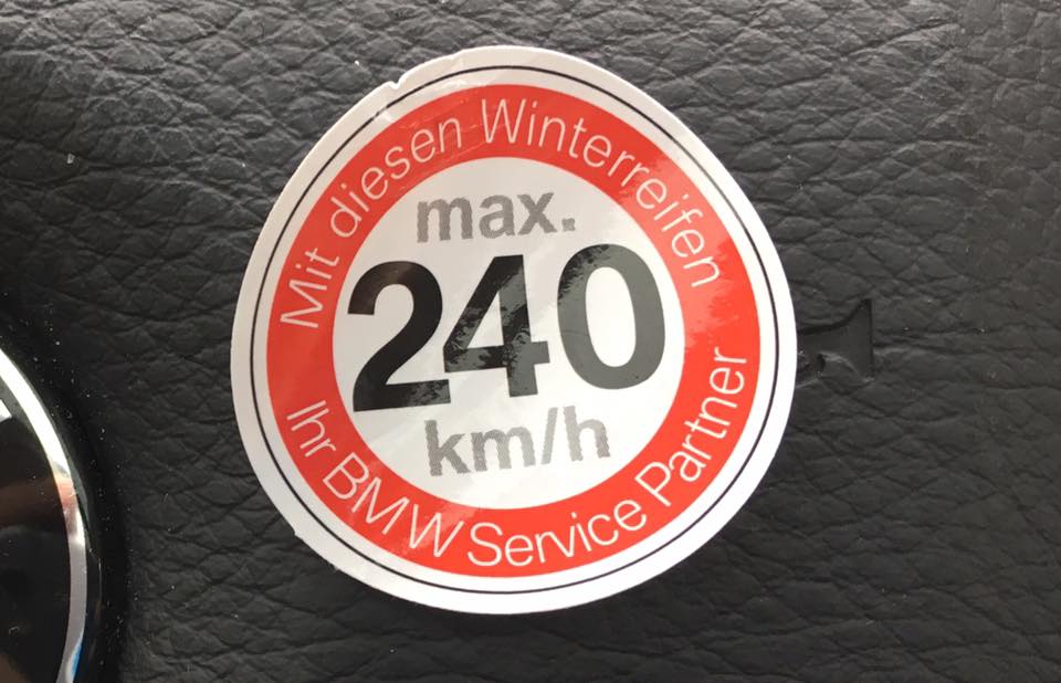

The 'Winter Tyre fitted speed warning'  is required in some countries in the form of a sticker in the car the driver can see or coming up on the car.
Not all cars / vehicles are driven by only one driver or even ones that know what tyres are on the car or pressures are set, meaning warning or Winter Tyres is a Safety Feature..
So the manufacturer provided that.
