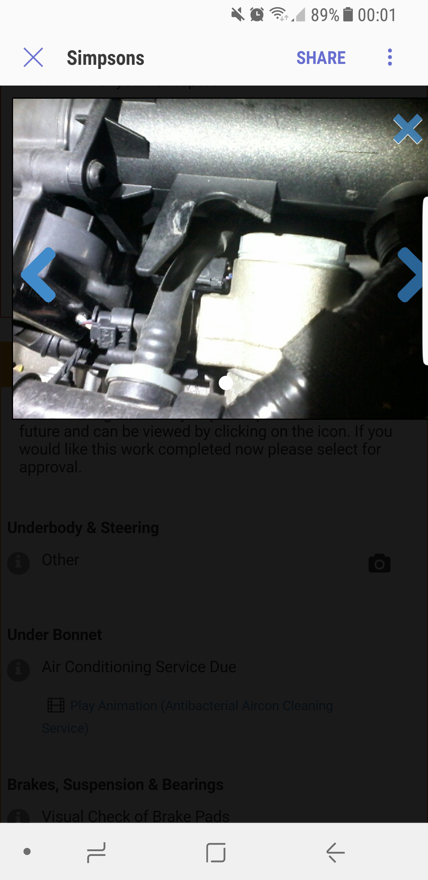

I'm getting the alloys refurbed next month so I'll hold off until then and ask the guy to take pictures of them for me. I didn't trust what they (simpsons) said as they didn't have evidence of the corrosion but took a picture of the top of the engine cover mount (one fixed to a pipe) which I politely declined.

It's the one at the top,it's connected to a pipe that goes along the top of the engine. Can not tell you what it's called. It wasn't cheap to replace. I'd need the pipe replacing too. I don't have the picture to show you.

Home from work and got my paperwork out. The DSG update they did was the 34H5 'gearbox control unit software update'.
The thing at the top of the engine is literally the top part that secures the engine cover. Closer to the window as you look at the engine. (See picture). They wanted £51.44 for it to be replaced. The description on the paperwork is 'pipe damaged that secures engine cover'. It's no breather pipe etc.. Apologies for any confusion but it's hard to explain.
The picture is from my service records sent to me by Simpson's via text message.
