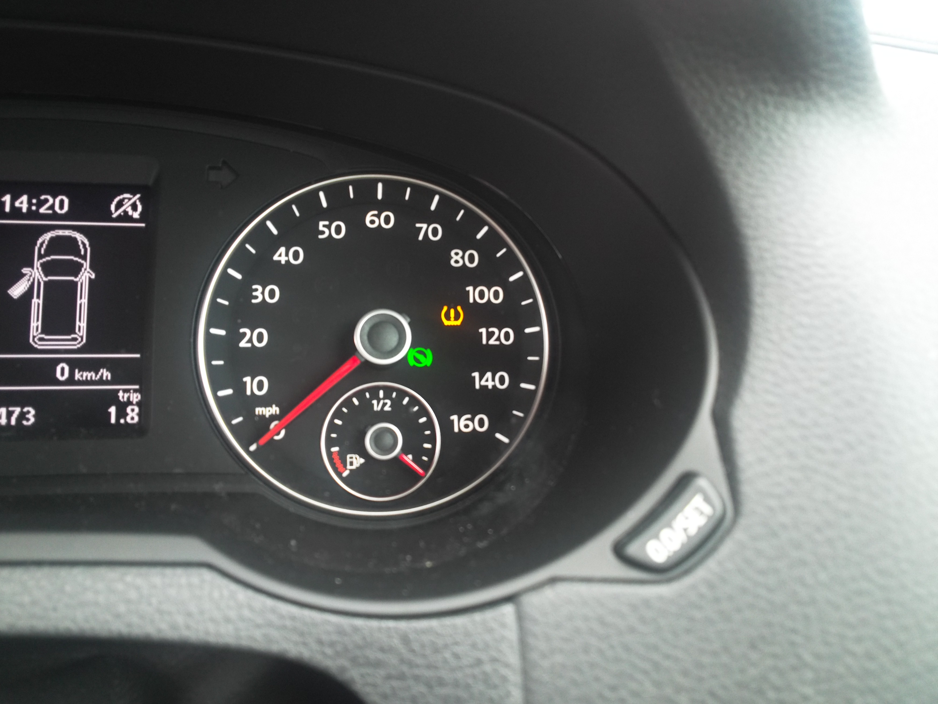

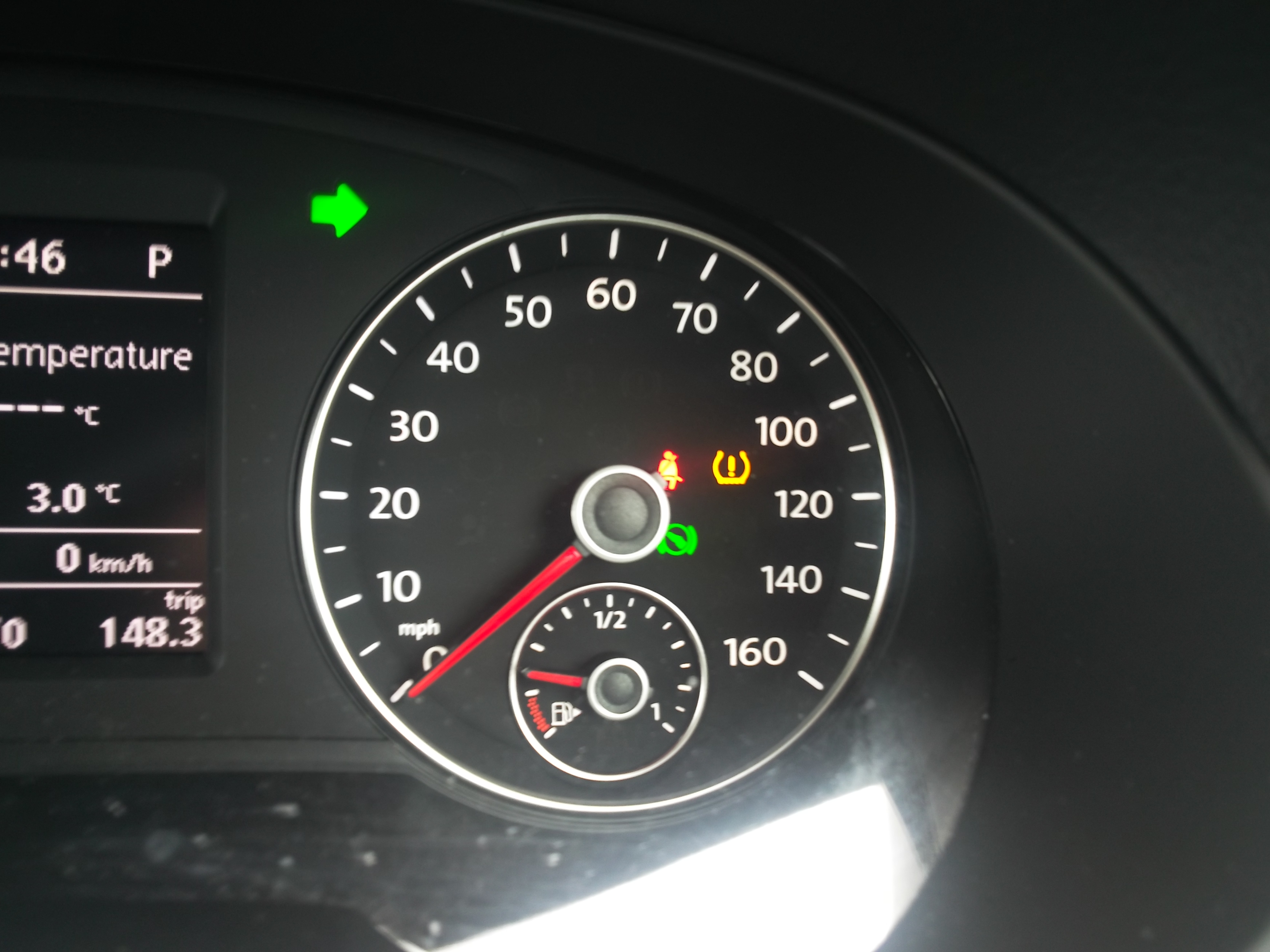

Keeps warning me regularly every month and there is no loss of pressure, dealer finds nothing wrong with system.

I've found in the past that it'll keep going off if the system is not well calibrated. I found the best way to calibrate is to do it at a high speed for 20-30 minutes as the faster the wheel is spinning (more rotations) the more accurate the measurements. The best way for it to work for me was to pull in to a motorway services, turn the car off and start the calibration procedure immediately before getting back on the motorway. Trying to calibrate the system in stop start traffic always had the warning come back up again after a few days for me.

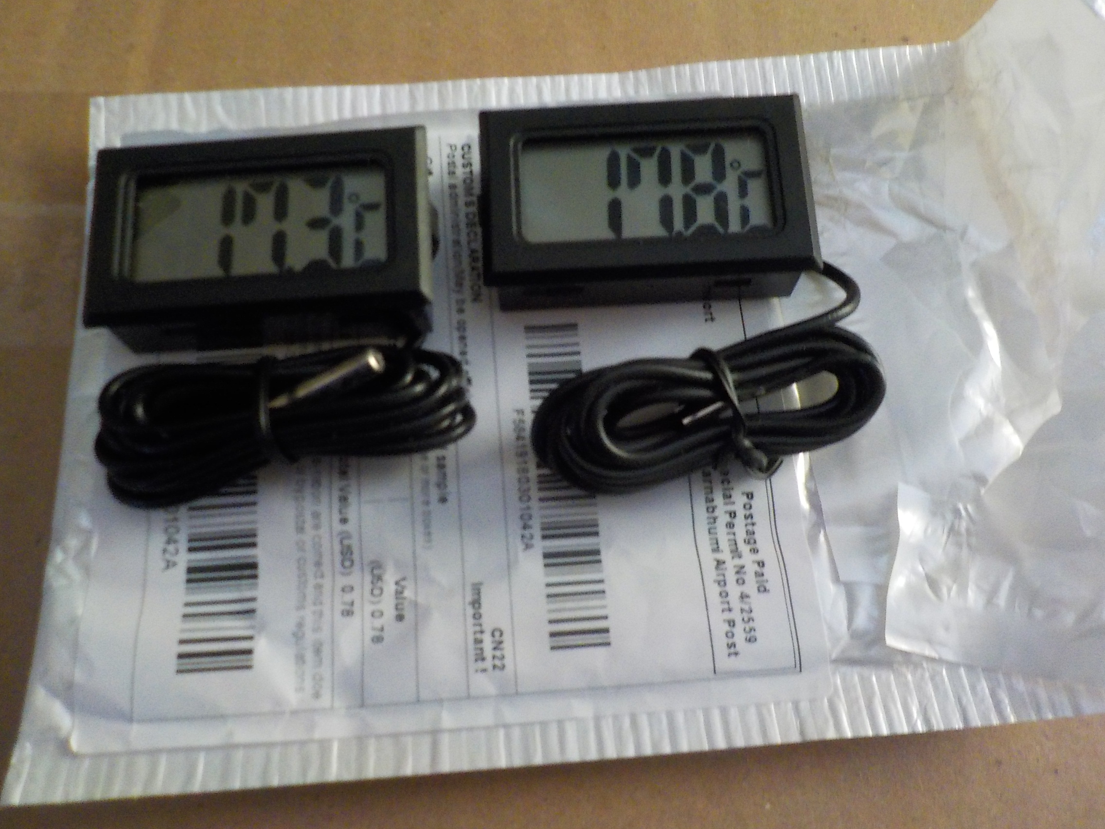

A £1.99 Digital Fridge Thermometer is dead handy for checking tyre temps when checking tyres pressures.
The newer ABS based TPMS on the MQB platform cars can take up to 1hr of driving time to calibrate...
This is because the sensors also measure the side to side vibrations (harmonics) of the wheel as it travels over different road surfaces & corners etc....way more advanced than previous ABS systems..
So even if you remove a wheel & refit it ...it will still need calibrating again..UNLESS you refit the wheel EXACTLY in the same position/same bolts holes etc..

Easy enough to fit a Spare wheel, reset the TPMS and get no warnings.
You can even go out, let one tyres pressure down 5 psi, reset the TPMS and get no warnings even with MQB platform cars.
