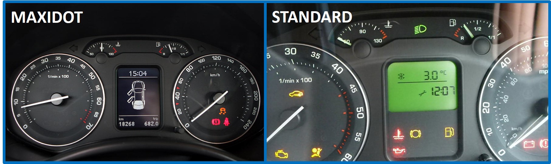

We need some more details on the age of car, as well as what type of on-board computer (Maxidot) you have fitted...
The above applies to the pre-facelift MkII Octavia only. It isn't as easy to tell on the facelift as both standard and Maxidot moved to the black and white display.

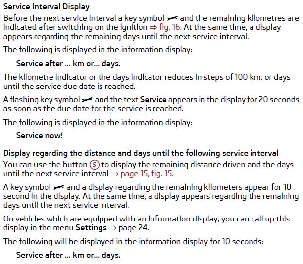

Regardless though the procedure for checking the miles and time to the next service is detailed in the manual.
Whilst it won't tell you which service regime your car is set to you might be able to determine for yourself based on the number of miles or days remaining. Anything over 10,000 miles / 365 days would suggest you are on variable / longlife...
