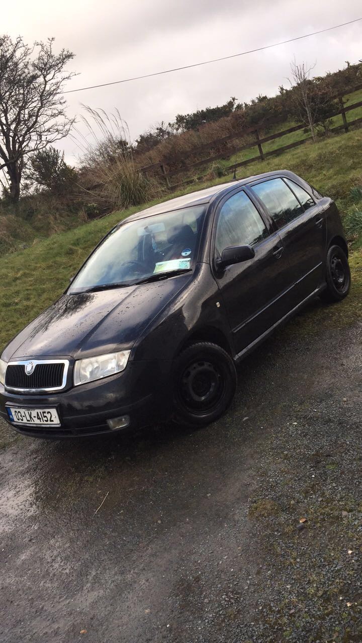

This is it @Dark_Hero
Ok, so that’s a pre face lift.
as well as the vRS bumper you’ll need the fitting guides/ brackets
p/n 6y0 807 049c
and 6y0 807 050c
fog lights are different as well and possibly the connectors to the fog lights
