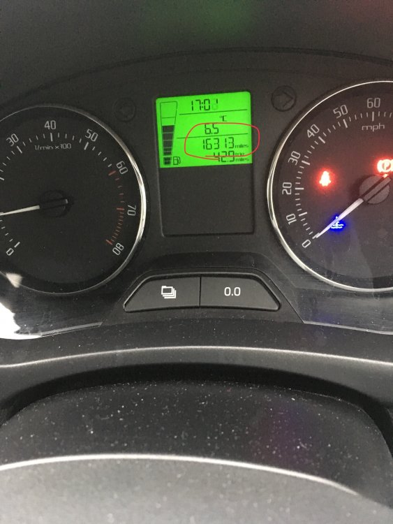

Sorry it’s a 63 plate not a 65. I’ll take a pic of display tonight and post so people can see what I mean
This is the photo the red ring is round the total miles/odometer this is what changes to kph as soon as the car moves
Seems like a fault then.

Yes the mileage is there it shows just not when I’m driving. I understand kph has to be there but would think I can knock it off so it’s only there when needed

Now that I've thought about this, I think that you will find that most modern cars hide/dismiss the total miles run display when the car is moving and use that space in a limited display area for something more important/relevant.

As the old saying goes, "They all do this sir"!
Regulations (from the EU?) state that vehicles must be capable of showing speed in kph.  Most manufacturers get around this by having dual scales on the speedo dial but the VW group (and probably others) show it in digital form.
If you pay the extra for the maxidot dash then kph has its own display, but on the bargain basement standard dash there is no room for it so they use the odometer digits that switch from odometer to kph as soon as you start moving.
I guess their logic is "why would you need to see the total miles while you are driving?".  Personally, the logic I would use is "give me a switch so I can turn it on when I drive in a kph country!"  But hey!  This is the EU...  but not much longer...
