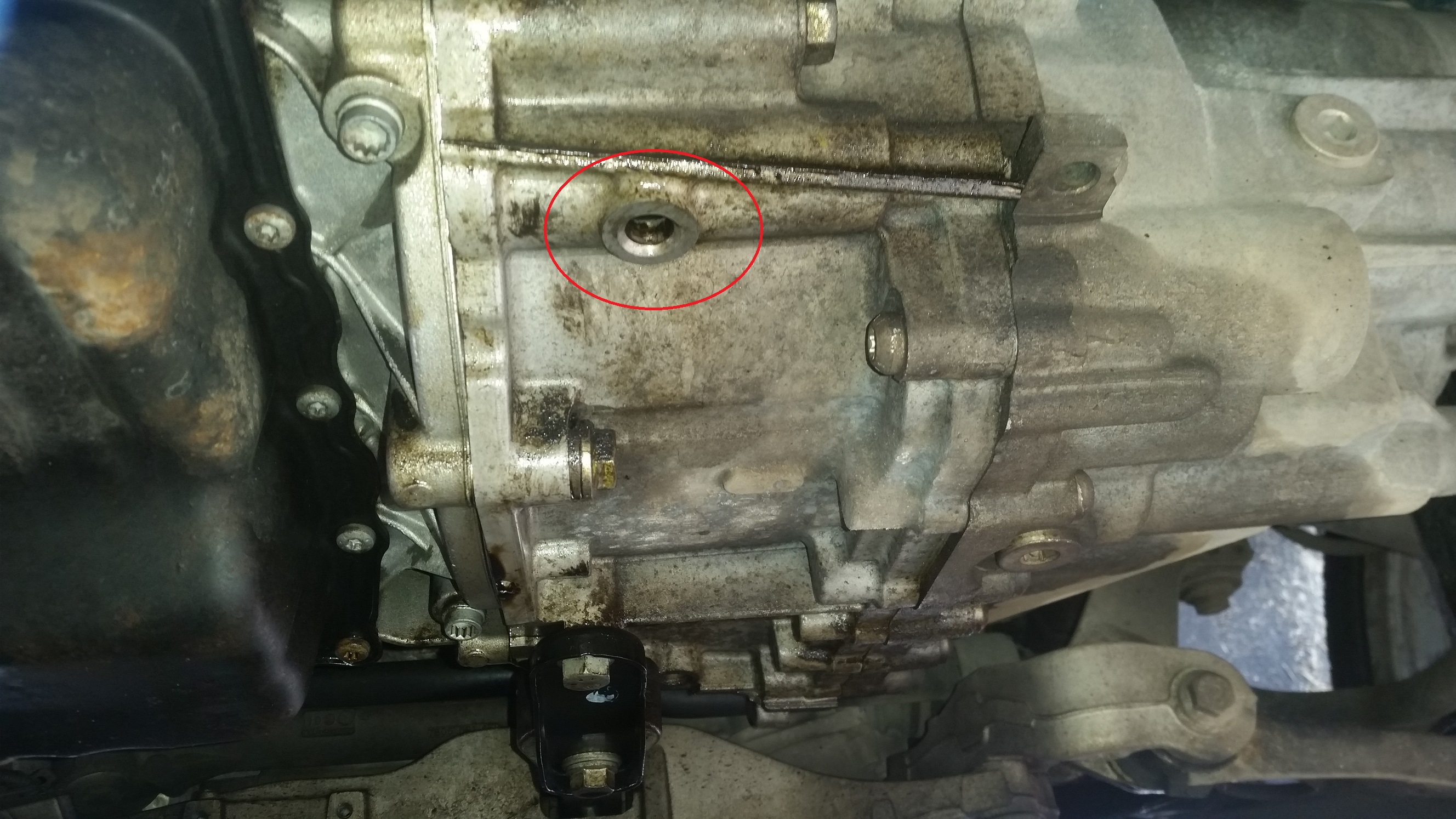

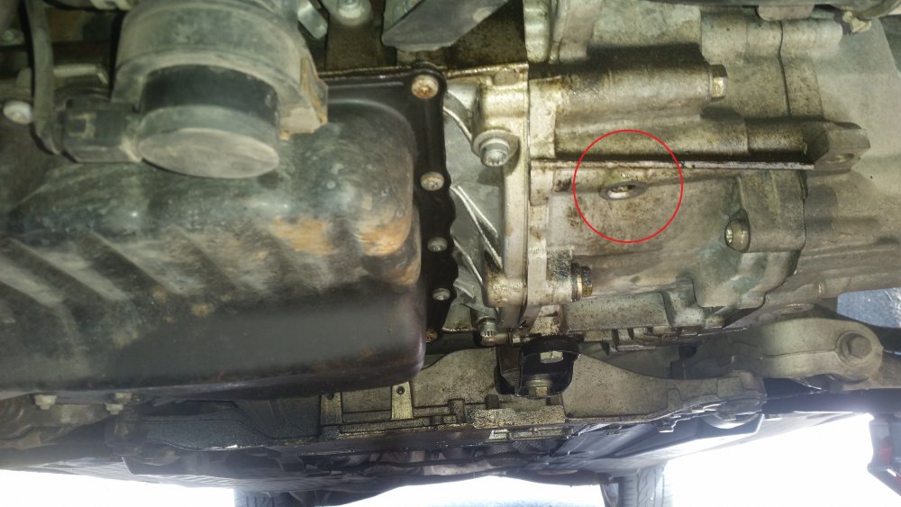

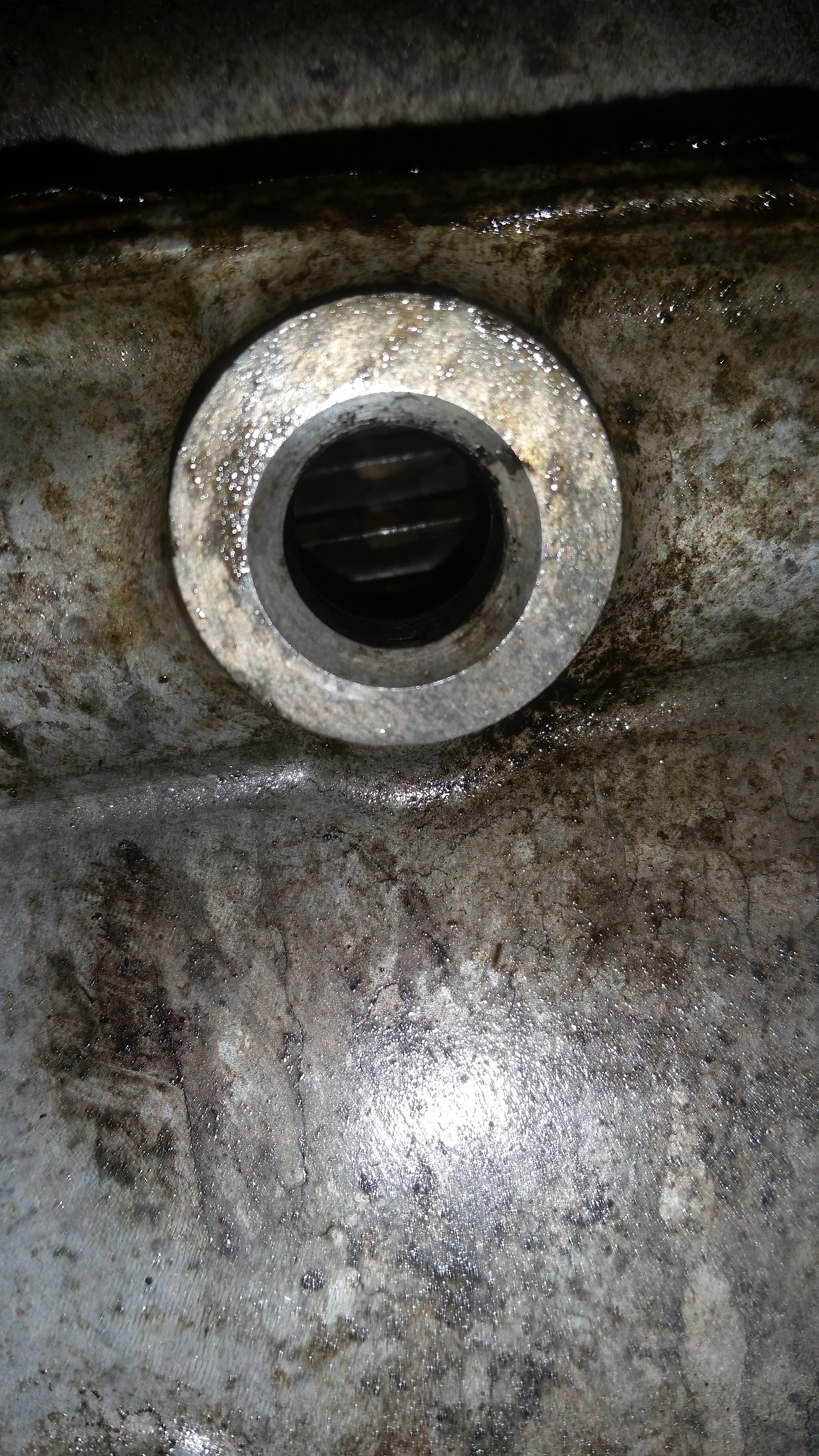

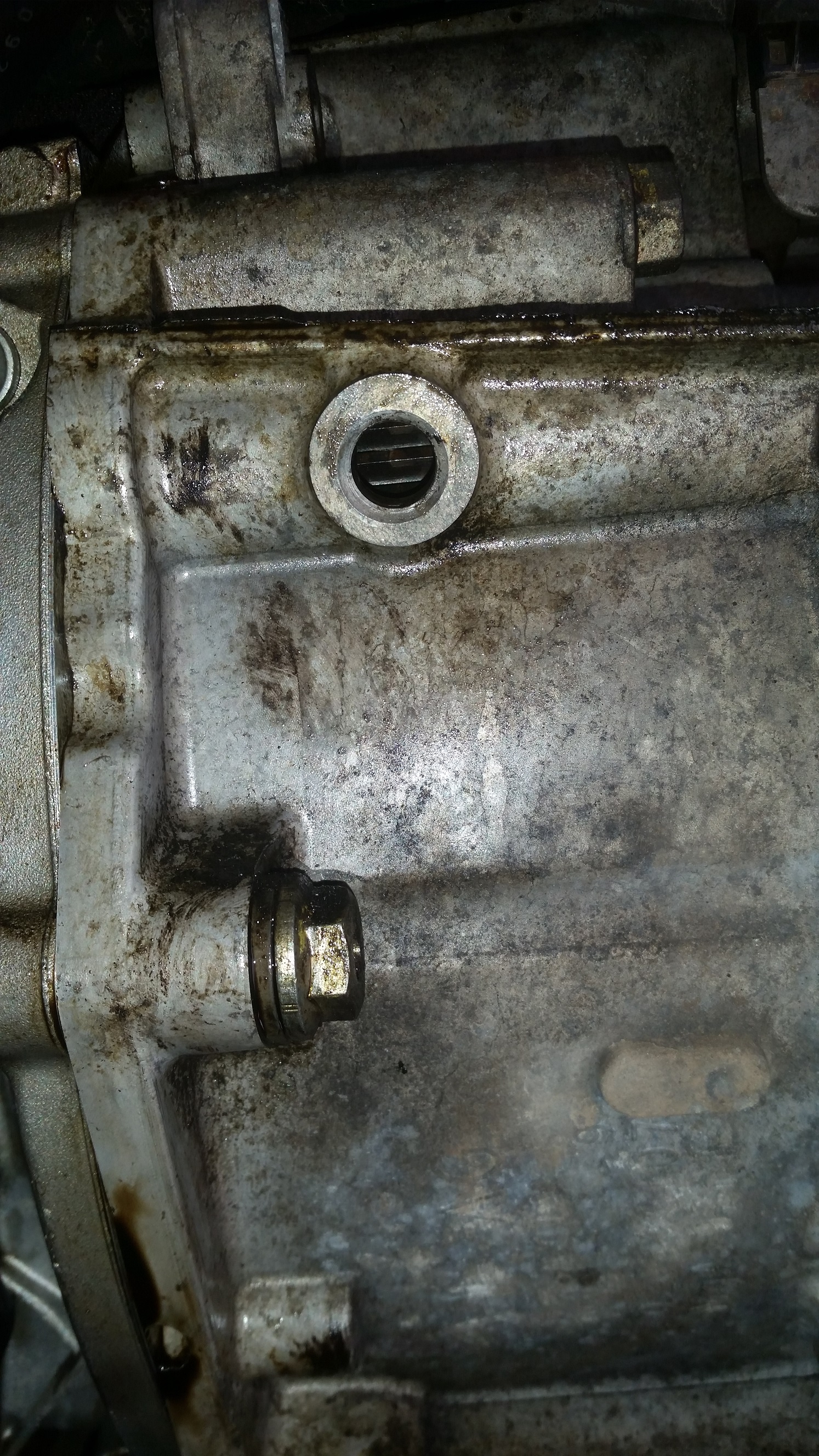

While I was having a little look under the car I also noticed an open hole in the bottom with a small bit of oil around the lip, looking inside I can see what looks like gear teeth, so my other question is.... should this be open to the world? It's not threaded so I'm guessing it's not a bolt come out but maybe should have a bung in it?! I've put some pictures in to help identify where I meant.

its is where the flywheel is , you can see the teeth that the starter motor engages when starting the engine. The hole may/may not have plastic bung in it. Cant look at mine at the moment as it raining cats and dogs here.
 If its sealed then any oil leakage from the gearbox or engine crankshaft seal  would fill it with oil and contaminate the clutch plate , so its probably meant to be like that.

Thanks erindad that put's my mind at rest a bit about that!
