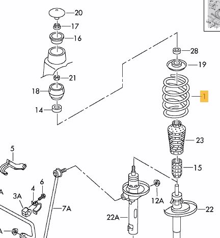

Now, can I add a spacer between number 14 & 19 to increase the tension on the spring, thus reducing the bounce? Will it affect the ride height doing this? In my mind, it shouldn't until it gets to a certain point, as the preload on the spring will allow so much before it starts to rise again. So, if I measure the compressed length of the spring with the weight of the car on it, then work out the length of spacer required, I should be able to reduce the bounce temporarily?
(BTW, number 28 on the picture is an actual spacer for vehicles with rough road suspension)

Brand new OE shocks with less than 6k miles on them. I know the problem, basically it's the spring preload. As the replacement springs are shorter, there was no need to compress them with the spring compressor to get the top spring plate on. This has led to the incorrect preload - hence the thought of using a spacer under the bearing to increase it. The best way I can think of at the moment is to double up the top spring plate, increasing the preload on the spring (and hence alter the response of the shocks).
Managed to improve the ride by doubling up the spring plates, which has increased the preload and removed a lot of the bounce from the front.
