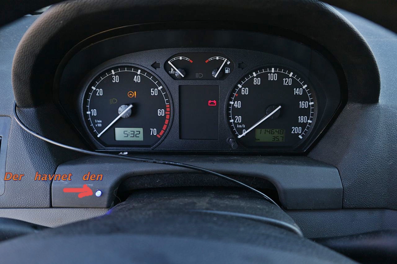

To day I make an new warning light for main beam. A 3 mm blue LED connecter to two Zenerdiodes on 5 volt X 2, to take avay 10 volt. In eerie  I also put a resistor on 1000 Ohm so the Led warning light is glowing a little on 12,5 volt an a little more at 14,5 volt. (effect: 0,0006 W) I will put the little light right under the instrument.

Well, I got some light on the dashboard. The little indicator will work for me, and for EU-control, I think.
