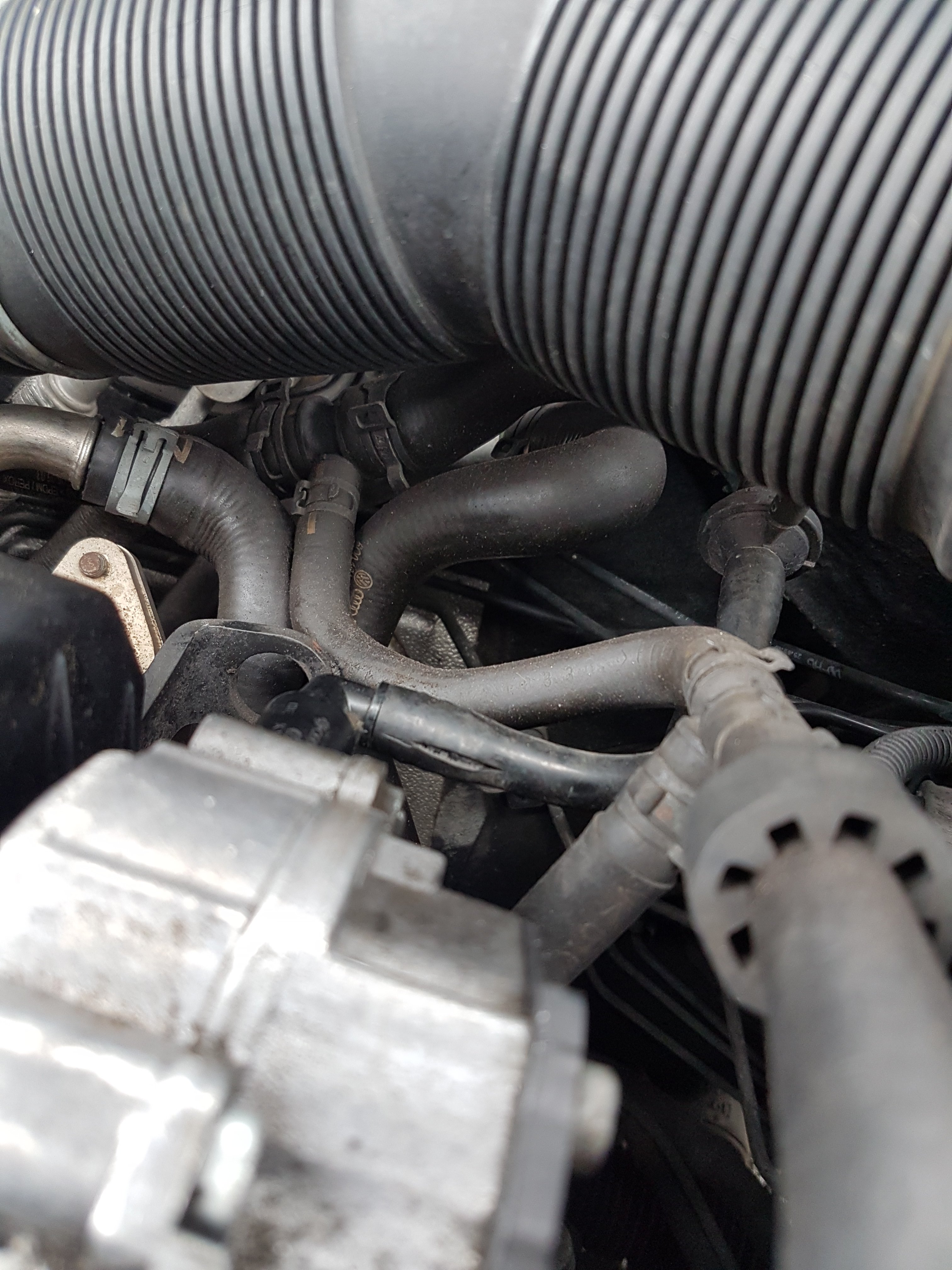

 I think i may have found the culprit
Edited by Bez1989
@Bez1989 - That seems very possible!
That looks like a vacuum line to me
It's the brake servo pipe.

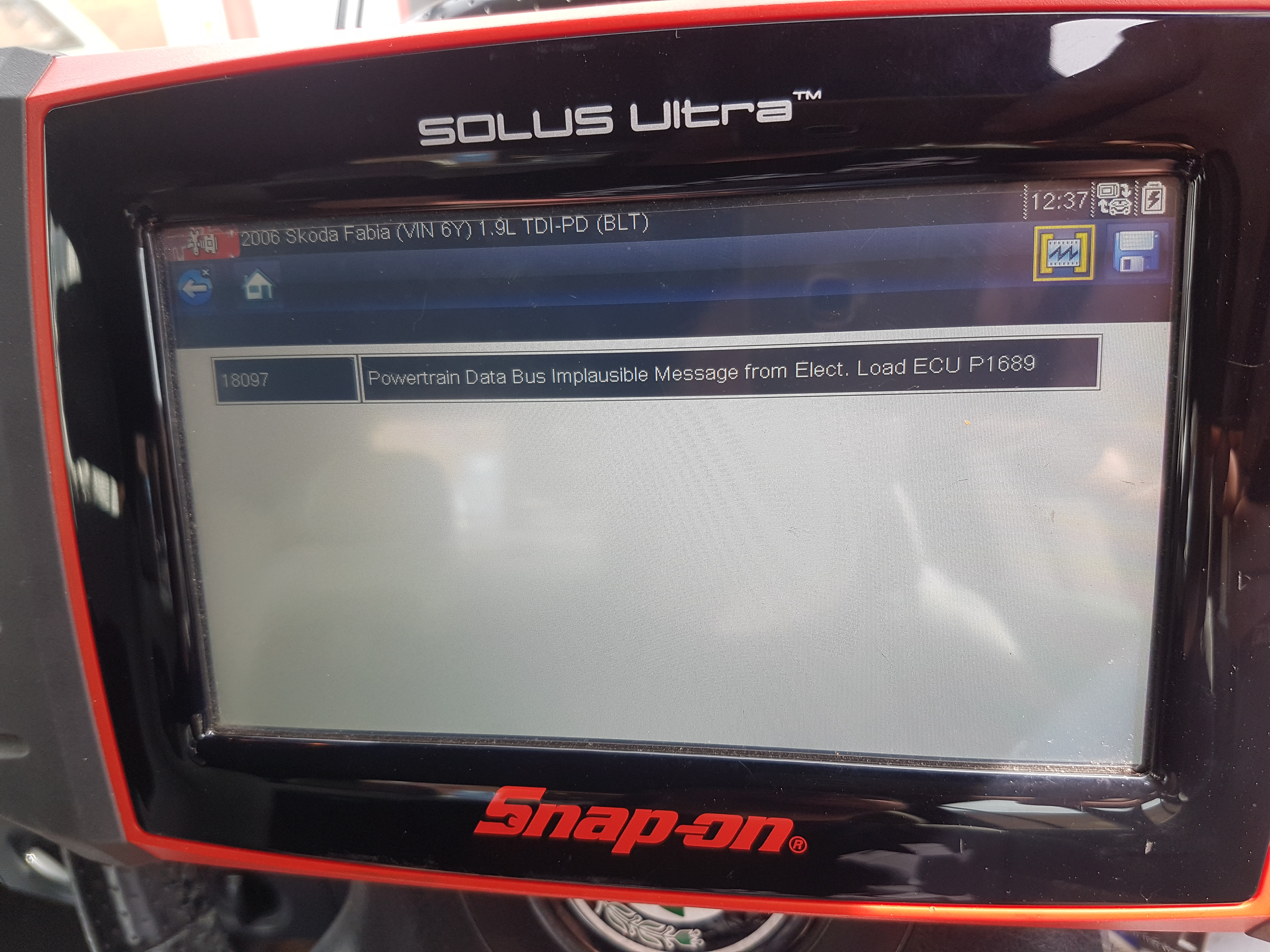

Right, i have a little update - i had the car plugged in to vagscom and the fault codes showing was temp sensor ( which i replaced ) and misfire on cylinder 2.. i have ordered the part to change the loom in the hope that it may cure the problem but im in need for some advise as to whether the loom will cause the hard starting or could possibly be the injector seals / injector at fault? Thanks for any feed back in advance
Unlikely to be an injector fault since that would generate a different fault code, loom issue could cause hard starting but there is a fuel temperature sensor as well that could be the culprit.

Another update as the car is now fixed and running fine, turns out it was the lift pump was at fault and not holding pressure causing fuel to run back to the tank.. thought id post and let you all know and for anyone with the same symptoms , hopefully this thread will help.. after i changed the pump i had a  fault code removed and since then it starts like a dream. Cheers for your help fellas.. (il post a picture of the fault code for anyone that wants to see it.
