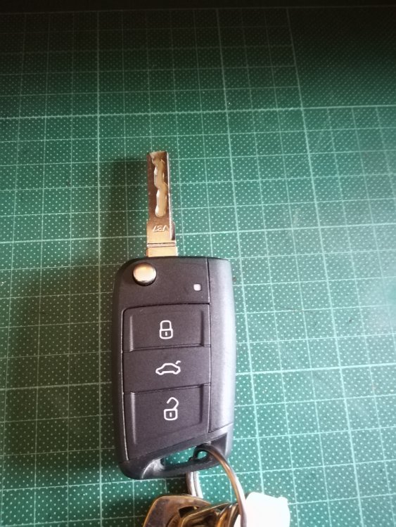

Hey guys,
So yesterday the cast metal block that the key blade is inserted into (and held with a pin) cracked around where the key blade is inserted.  I only noticed because suddenly the blade didn't want to release from the body of the case when I pressed the release button.  I have super glued the blade into the block for now, and it's should hold up for a while, but I need to get a new fob case, or even just the metal block to repair it.
I've looked all over the web, but I can't seem to find anywhere that sells a replacement fob case for the mkIII Octavia or other VAG cars from this age.  My fob looks like the one in the image attached.
Can anybody tell me where I can buy a replacement case?  Or if maybe the key blade mounting block from the previous generation fobs is the same?

 The replacement fob arrived today.  The casing is exactly the same, so not issues with that, but I can't do what I was intending to do, which was just swap the key blade from one key blade mounting block to the other.  The reason being that the replacement fob has a different sized split pin that is a bit wider in diameter, but also much shorter that the pin in the original fob.  I'll need to take the new fob to Timpsons to get a new key cut. I'll get that done at the weekend, and then transfer the electronics once that's done.

O.K. So I finally ended up buying another used key fob like my original one from ebay.  This used fob had the same key blade block, and same size of roll pin to hold it in place, just like my own original fob, but the blade block isn't cracked like mine was.  I butchered that to get the key blade block out, knocked out the roll pins and put my key blade into the block from the used key fob, and then installed that into the new key fob casing that I had already bought a good few weeks ago, along with the little PCB board from my original fob.  I used a few drops of super glue to help hold it together, but I should have used a bit more I think, but hey, it's fixed!!  It cost £8.00 for the new case w/o any electronics, and a further £9.00 for the used key fob with the PCB inside it.  so £17 to replace the case and key blade block :-)
